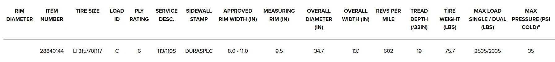

I'd play with a little lower. Looks like they are 113 with a max of 35 psi. They are load rated for almost 20% more at 35 psi (2535 lb/tire) than the factory Rubicon's are at 37 psi (2189 lb/tire), and the factory 37 psi is higher than most run.

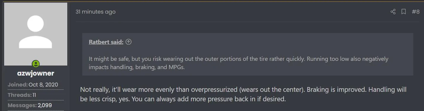

Not really, it'll wear more evenly than overpressurized (wears out the center). Braking is improved. Handling will be less crisp, yes. You can always add more pressure back in if desired.

Care to explain how braking is improved by running tire pressure that's too low? That goes against everything I've learned about tires / tire pressure.

Not too low. Correct for the weight. Per the tire manufacturers association, a 35x12.5r17 tire, or its metric equivalent, is rated to carry 1875 pounds at 25 PSI. That’s 7500 pounds per four tires, well in excess of a Jeep’s weight. If someone runs above 25 PSI they are doing it for other reasons. That is an important distinction. If the tire were truly too low, I would agree with you.
Improved braking is from better grip. If you pump up the tire to 40 PSI, you have a smaller contact patch with the ground (it starts riding only on the center of the tire), and although static friction in theory is agnostic to surface area, in reality the more rubber in contract with the ground, the greater the friction.

If you look back at the conversation you'll see that you were talking about braking being improved when running too low:
Jeep Wrangler JL Struggling - Tire Decision 1753739304259-6r
That's what I was questioning.

That's a fair point. I was disagreeing with the notion that 25 PSI is too low, but I didn't explicitly say it, so I can see how you would interpret it as sanctioning running at excessively low pressures. I would strongly disagree that 25 PSI is too low for 35s, so there is no problem at that pressure, but I agree that if someone is running too low for their tire size, it's a problem.
