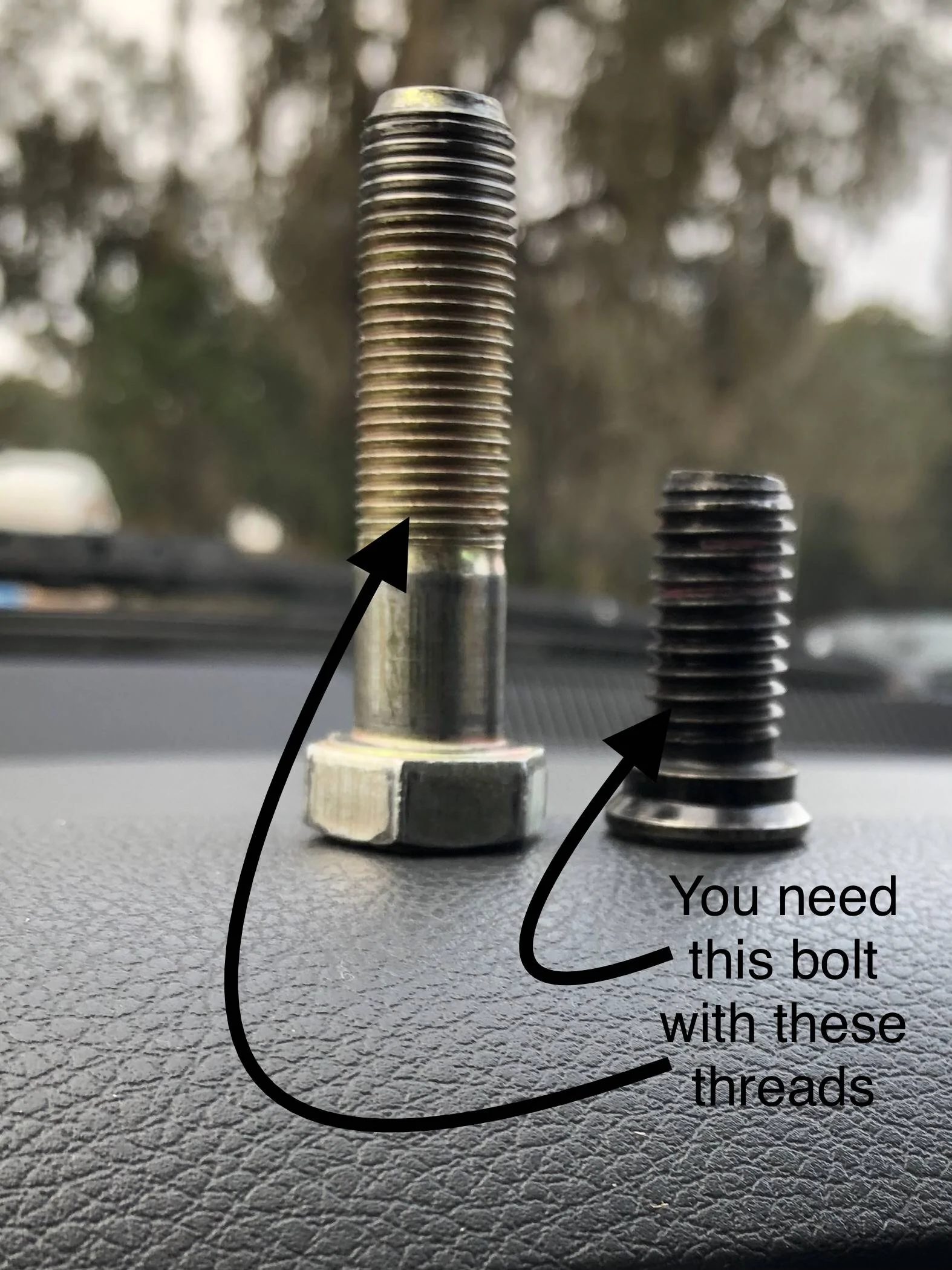

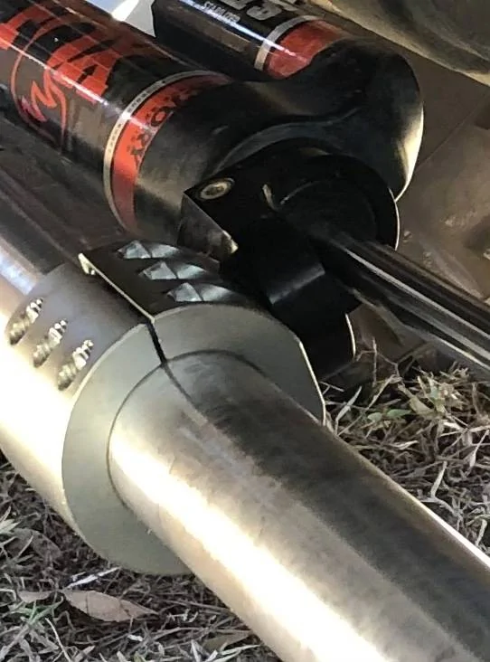

You can but you’ll have to use a stabilizer that comes with its own clamp. Like Fox for JK…or if you use a different clamp then you’ll have to source a flat head bolt with the same threads as whatever clamp you get…for example.. I had to use a synergy clamp so I had to get a new shorter flat head bolt for it to work……
Jeep Wrangler JL Stock height rubicon steering upgrade 00AC3B62-F5AB-49C0-833C-414C956A0F5F
Jeep Wrangler JL Stock height rubicon steering upgrade F773EED5-5A42-4FD3-908F-EA0121E5AF5D
one more thing, some aftermarket ss relocation brackets recommend 2” of bump stop or lift….. so you may need to rotate it some to get it to clear….

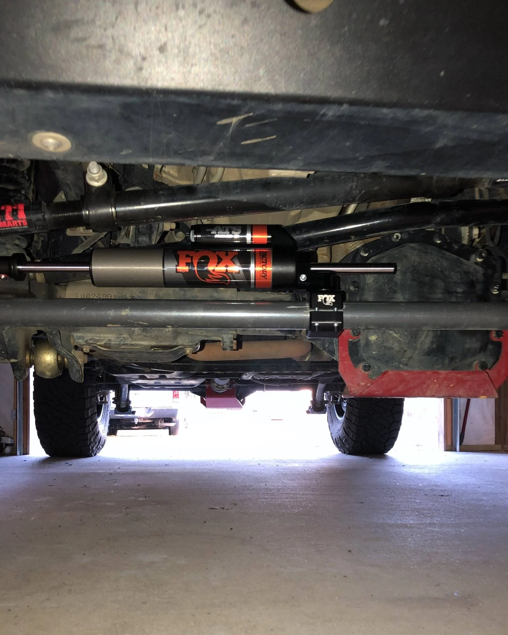

So with a jk stabilizer I can just get the short bolt. And I won’t need the relocation mount from steer smarts? Just use the jk fox mount it comes with?
Yes, if you get the Fox for JK it will bolt to your new tie rod…like this…you won’t need to get new bolt, only if you change tie rod clamps…..you’ll only need the axle side relo bracket from Yeti….
Jeep Wrangler JL Stock height rubicon steering upgrade E9C60EB5-E7AE-4E4D-984C-8311FC65B986
just be sure you get the right diameter clamp when you order it.. the factory is 1-5/8”, I think Yeti is the same, but not a 100%, please verify…..

Yeah, no worries, the Fox for JK does come with the track bar bolt, so you wouldn’t need to get anything extra, but some people have had clearance issues with them….
