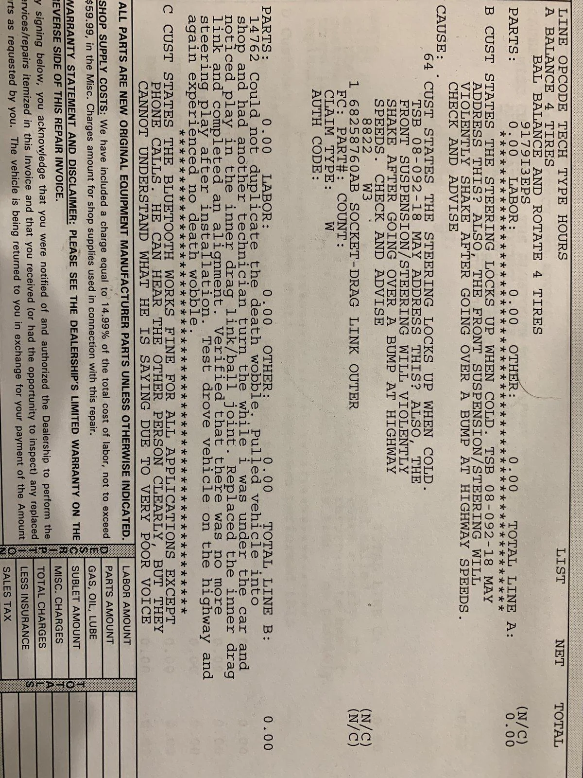

Here is what they wrote on my paperwork
What’s funny is that I look at the paperwork now and it doesn’t fit with what they told me
The advisor said they relocated the issue, opened a star case and that’s why they needed it for so long.
I don’t see anything about a star case, it says they didn’t replicate and obviously we know they didn’t fix.
Did you have the dealer drive your JL over a pot hole, bridge gap, railroad tracks, or anything else that would trigger the steering wobble? You might want to go 30 minutes early to your appointment and drive around the dealership and find something that will trigger it so you can show them. It is tough to fix something if you can't reproduce it. Chasing a ghost.

The dealer service document says they didn't see the problem. So looks like you are dealing with Moe, Larry or Curly at the dealership. Now you are going to have to hold their hand and go on the test drive with them.
I did that with the first dealership. They said I could drop it back off but they didn’t know how long it would take and couldn’t get me a rental car. I was very unhappy with that dealer which is why I tried this other one. They said they reproduced so I was hopeful, now I actually read the paper and see they are just lied
