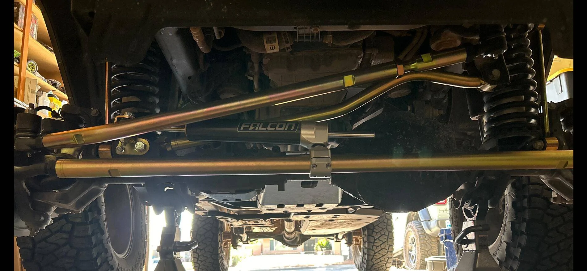

I had run both on my JLURD, started with the falcon which has 3 settings. After a clamp failure, I just switched to Fox as a quick fix. Much more adjustability but depending on who you are and how much you want to fine tune..... may not be needed.
I did have RPM steering on 38s/40s and felt that the firm setting on the falcon was slightly more than the fox. I could be wrong but that's the way it felt. Falcon adjusts with a quick flip on the switch while the fox needs a flathead and a quick reminder of which way to loosed/tighten.
