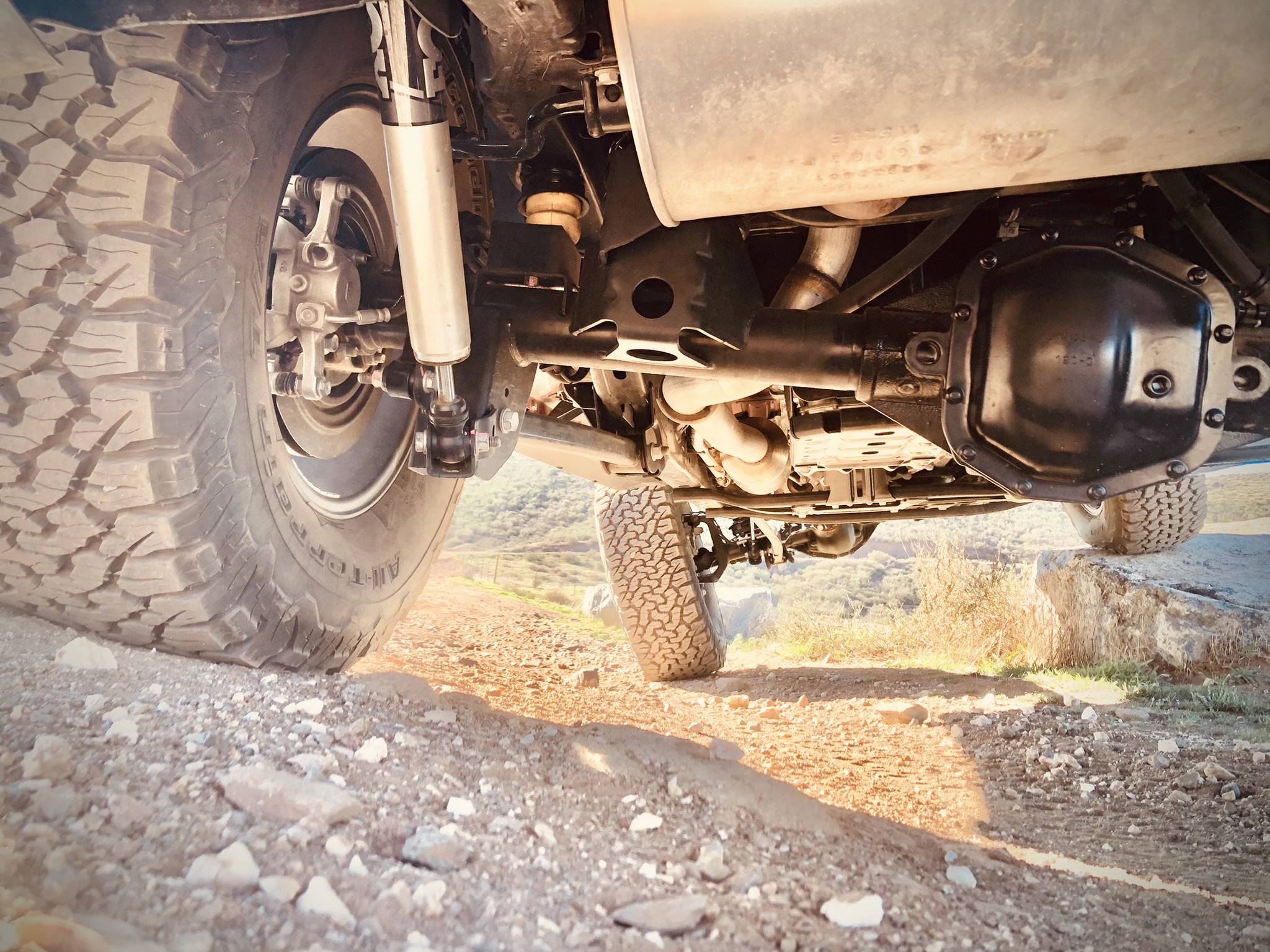

I would recommend the fox2.0
That is what I run with my dynatrac Endurosport lift and it’s great. Everyone says falcons are too stiff so it’s a preference thing but I love the fox2.0s, especially when they’re tuned for the specific ride.
