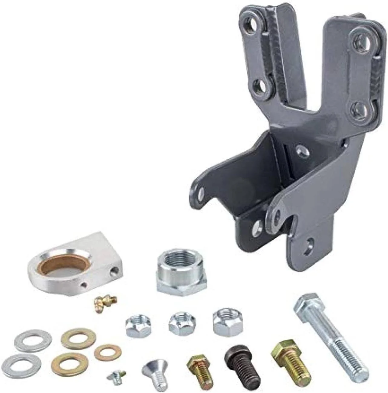

I had some play myself and read a lot about the issue, specifically on 2018's with the original aluminum steering boxes. I guess their thought was the steel box would fix it and in many cases it reduced the play significantly. I have the steel box but still added a brace (Synergy Front Track Bar & Sector Shaft Brace for 18+ JL/JLU & 20+ JT SYN-8869-01) and it really tightened things up, zero play now. I believe there are several manufacturers out there making this type of brace.
