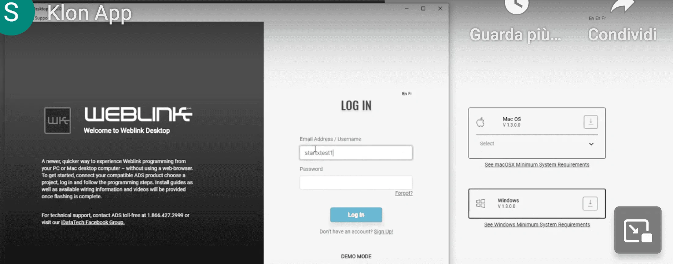

I installed my kit just yesterday.
It was simple as expected and as already mentioned here on the forum. I can only add that I used my Mac and Firefox to download the App.
Jeep Wrangler JL Start-X Remote start Screenshot 2023-06-14 alle 20.43.29
The App download site is only in English or French, so the suffix of the address when abroad needs to be changed to /en. Everything else is effortless and works perfectly. :like:
