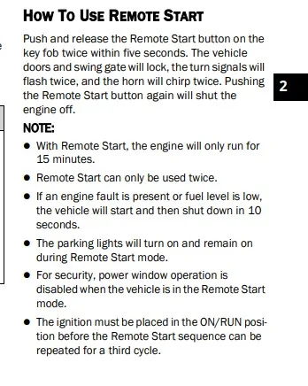

Not sure this is true. I sleep in my Jeep often, and start it remotely to warm up inside. I've done this more than twice while in the back in same night
Then thats a unicorn jeep as it is the only one that will do a remote start event more than 2 times. Its in the manual.
Ah. I disable the remote start by pressing the start button from in the back and also unlocking the doors. That's why I can do it more than twice.
