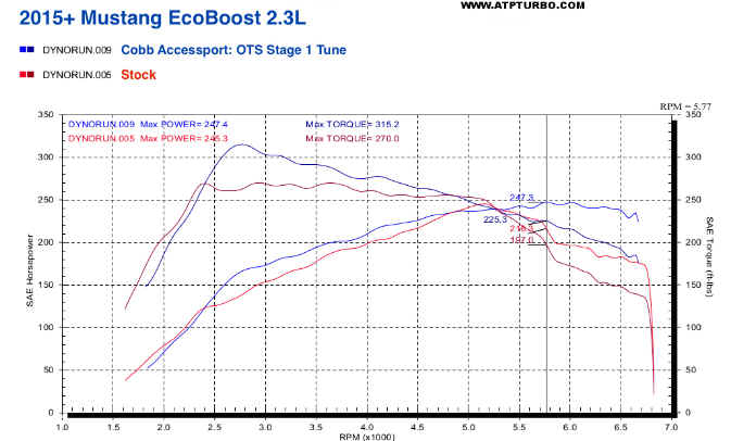

Remember, these little 4-cylinder turbo engines make a FLAT torque curve. I still don't understand why guys think this engine will feel weak. Look at what Ford is doing with theirs.
Jeep Wrangler JL Standard Engine..?? EcoBoostTorqueCurve

Agreed, but we won't get that until the engine at least breaks cover, and likely not until a bit after that for a detailed torque curve. Some are more peaky
It's flatter, but still not Pentastar flat, and in that curve the power delivery is late in the RPM range , @1,800 RPM it's still only providing 66% of power @ 180 bs the Pentastar's 95% @ 1,800RPM w/ 250lbft, it takes the ecoboost there an extra 500 RPM to reach 95%.. and that's without even adding lag, and also using the old later power Pentastar.
So while people talk about quick power turbos, yes, you can have that, but it usually doesn't come with the same flat curve without adding more exotic parts in the turbo design/setup. So often it's a choice, early power or smoother power.
It won't be truly 'weak' but it also won't be impressive, more just Ho-Hum, especially for something that appears to now charge a price premium, fuel premium and likely maintenance premium.
And compared to a better fit engine, then yes it's 'weaker', because it's focus is PR, not best fit, but even then the Pentastar wouldn't impress either.
Outside of special cases like the alttitude penalty (which will be offset by similar special cases like those interested in smooth power delivery for off-road) it just doesn't seem like much of anything, other than a sideways option that might end up displacing the Pentastar, but for all the wrong reasons that aren't related to the needs of the vehicle or its driver.
