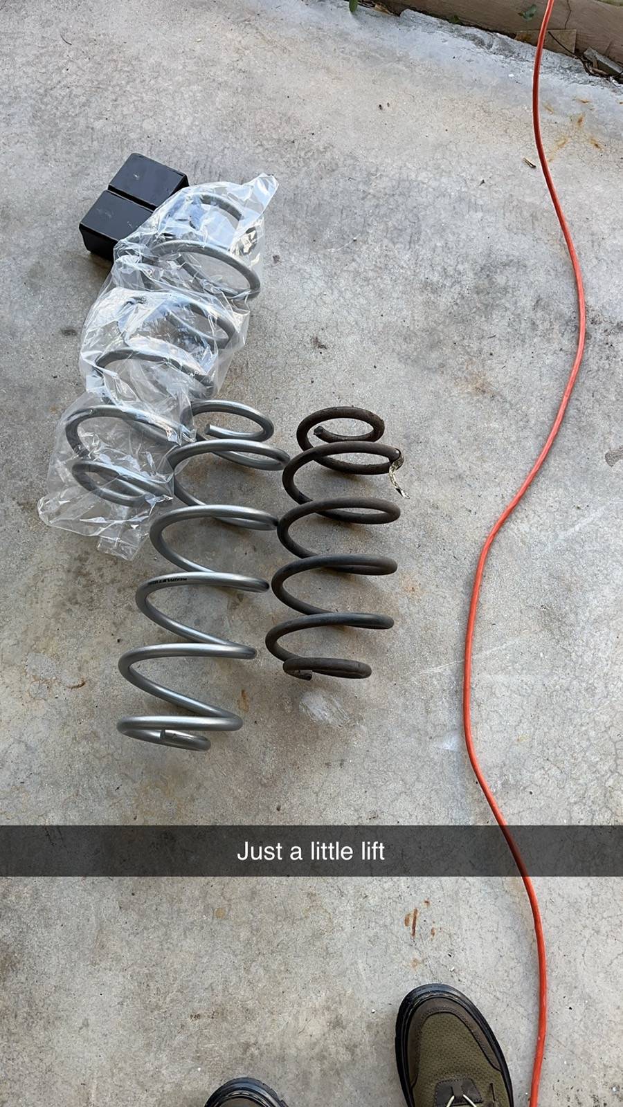

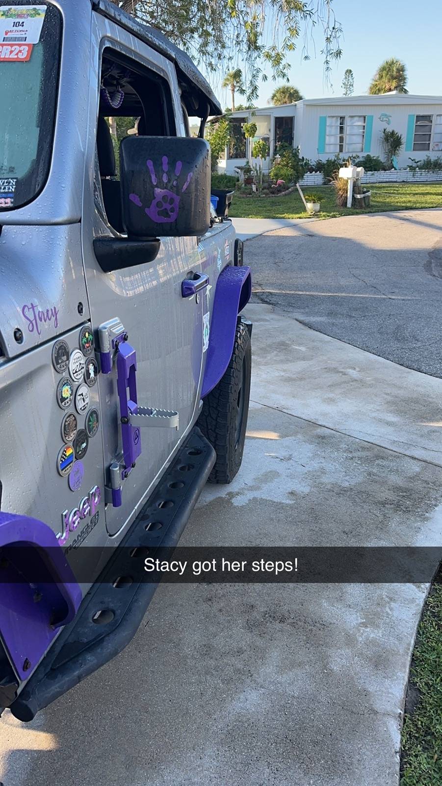

I’ve been lurking on here for a couple of years while I built my girl out for a cross country trip. We started out as stock almost 2 years ago. The first thing I did was completely Rhinoline the interior, next I did the cutesy fun stuff (all the powder coating and matchy exterior stuff now I’m prepping to leave. All 30 MLB parks, 48 states, Canada, all the Jeep Trail badges I can and then Moab on the way home.

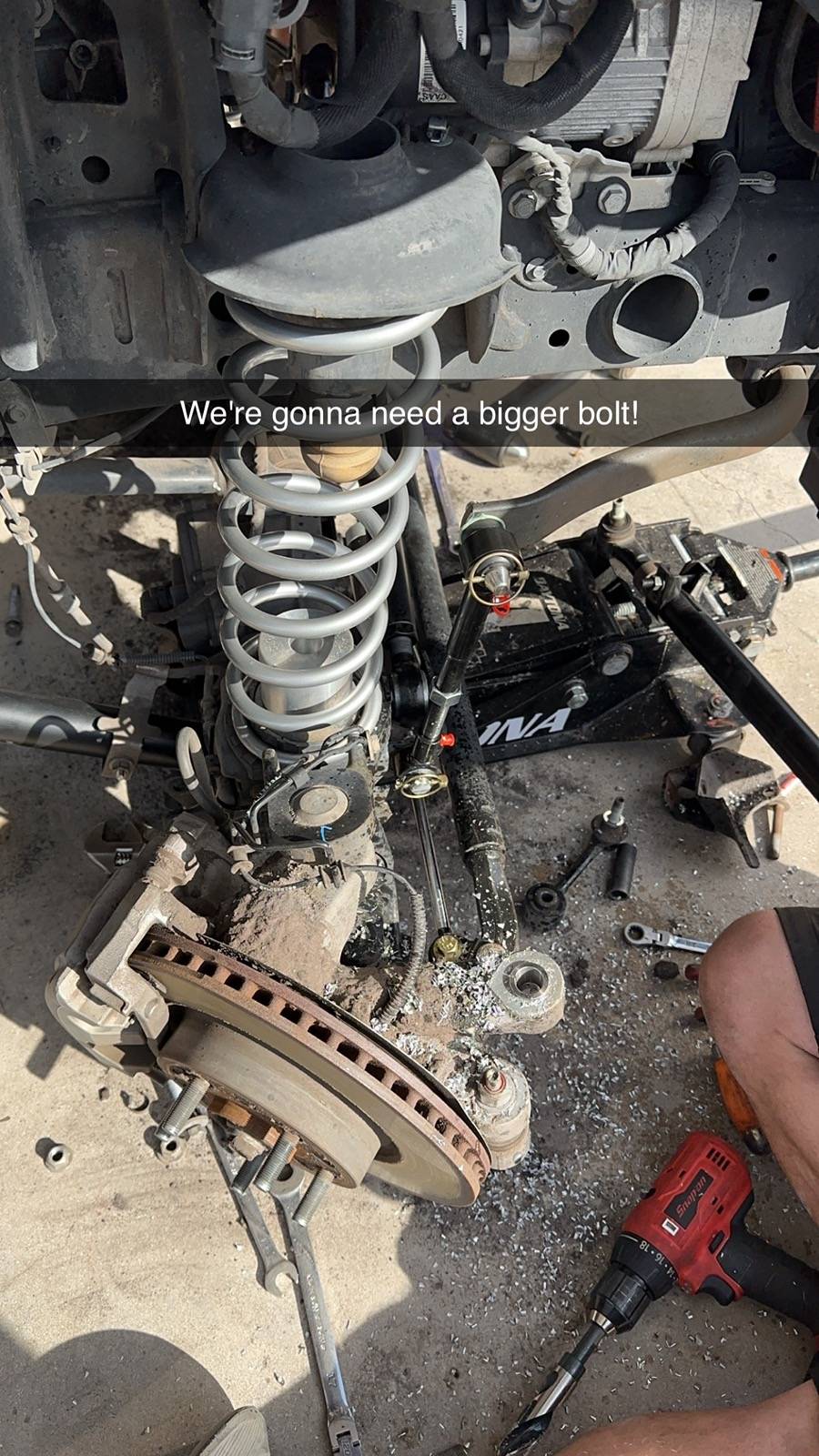

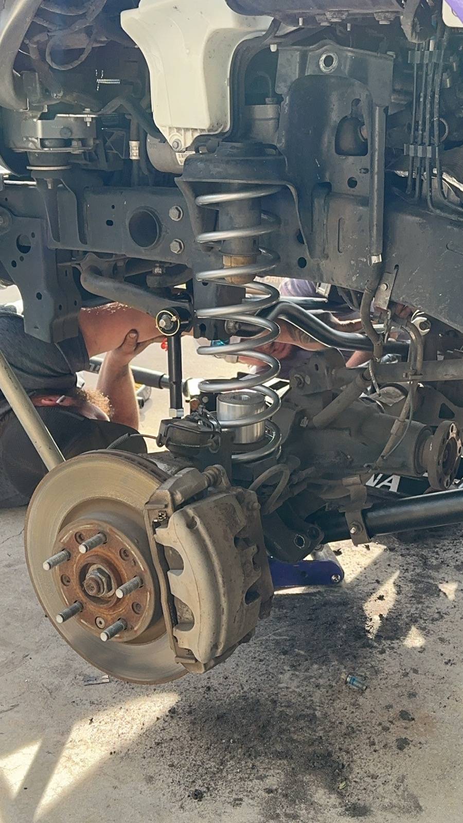

After reading and learning on here, I had some ideas. My new best friends and mechanical team Carson and Chris (freelance mechanics LLC) took my ideas and ran with them. I told them that if I broke down they had to come get me so they are pretty on top of my rig. Rumor has it that if you call Readylift and mention Carson’s name they WILL hang up on you! ?
MODS

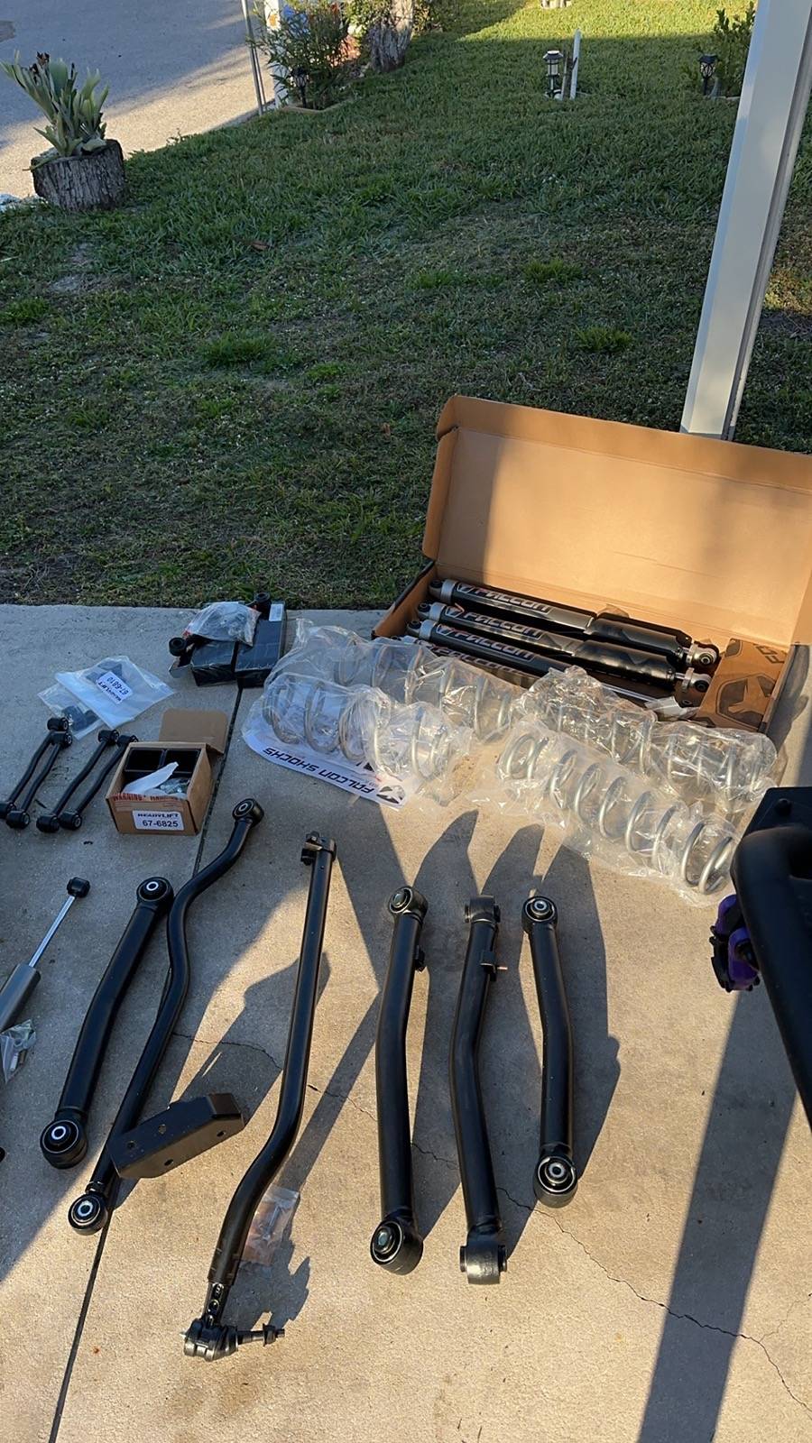

ReadyLift parts
  • Heavy duty fully adjustable 4 to 6.5 inch lift front track bar with crush sleeve and upgraded hardware.
  • Rear drop track bar bracket for a 4 to 6inch lift set up. With upgraded grade 8 frame bolts.
  • Driver and passenger side brake line drop brackets 1.5 inch drop.
  • 2inch E- brake drop extension bracket with cable support.
  • 2inch rear frame and axle bump stop extension brackets.
  • 4 inch lifting rear axle to frame bottom control arms done in tube frame steel with upgraded hardened rubber bushings.
  • 4 inch lifting rear springs with new lock bushings.
  • 4.5 inch lifting front axle to frame control arms done in tube frame steel with upgraded hardened rubber bushings.
  • 4.5 inch lifting front springs with 2inch bump stop extensions axle to frame.
  • Fully adjustable steel steering bar with bottom to top steering knuckle conversion. With upgraded steering joint.
Falcon Parts

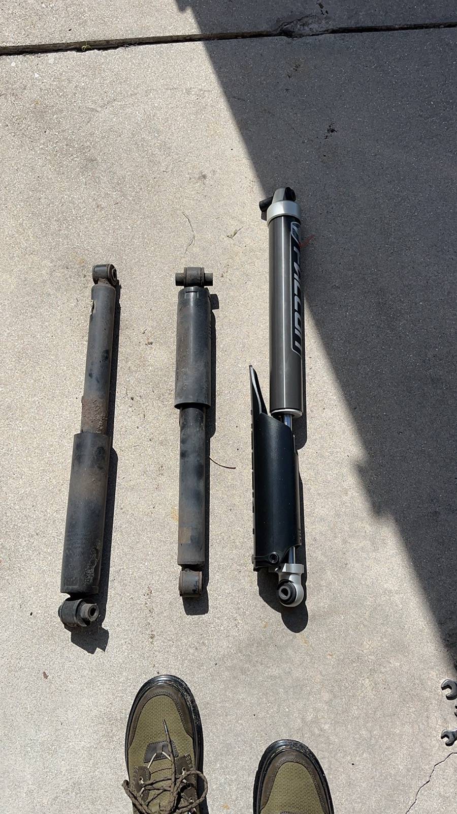

  • Front and rear, matching 2.1 upgraded falcon shocks with upgraded Teflon seals. And upgraded rear brush covers.
  • Fully adjustable 0 to 6 inch falcon steering stabilizer with dual valve shock and upgraded Teflon seals
Tera Flex Parts
  • Fully adjustable 3 to 6 inch quick disconnecting swaybar links with hardware and brackets for rear and front.
There’s also the wench, new tires and wheels, back bumper, lights and control grab handle, mirrors, cameras, lockbox on tailgate, locking storage and a new sound system.
Jeep Wrangler JL Stacy becomes STACY IMG_4044
