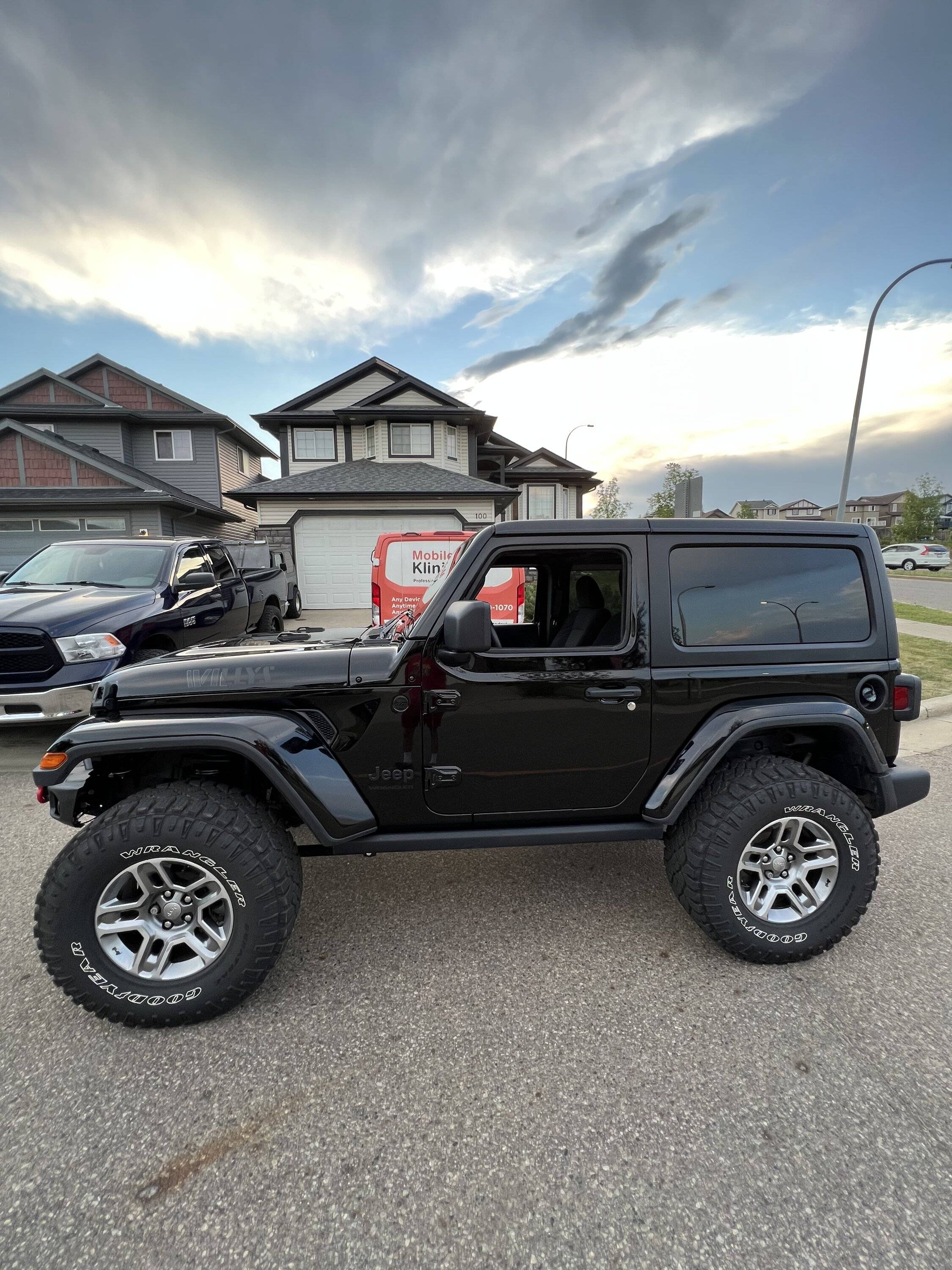

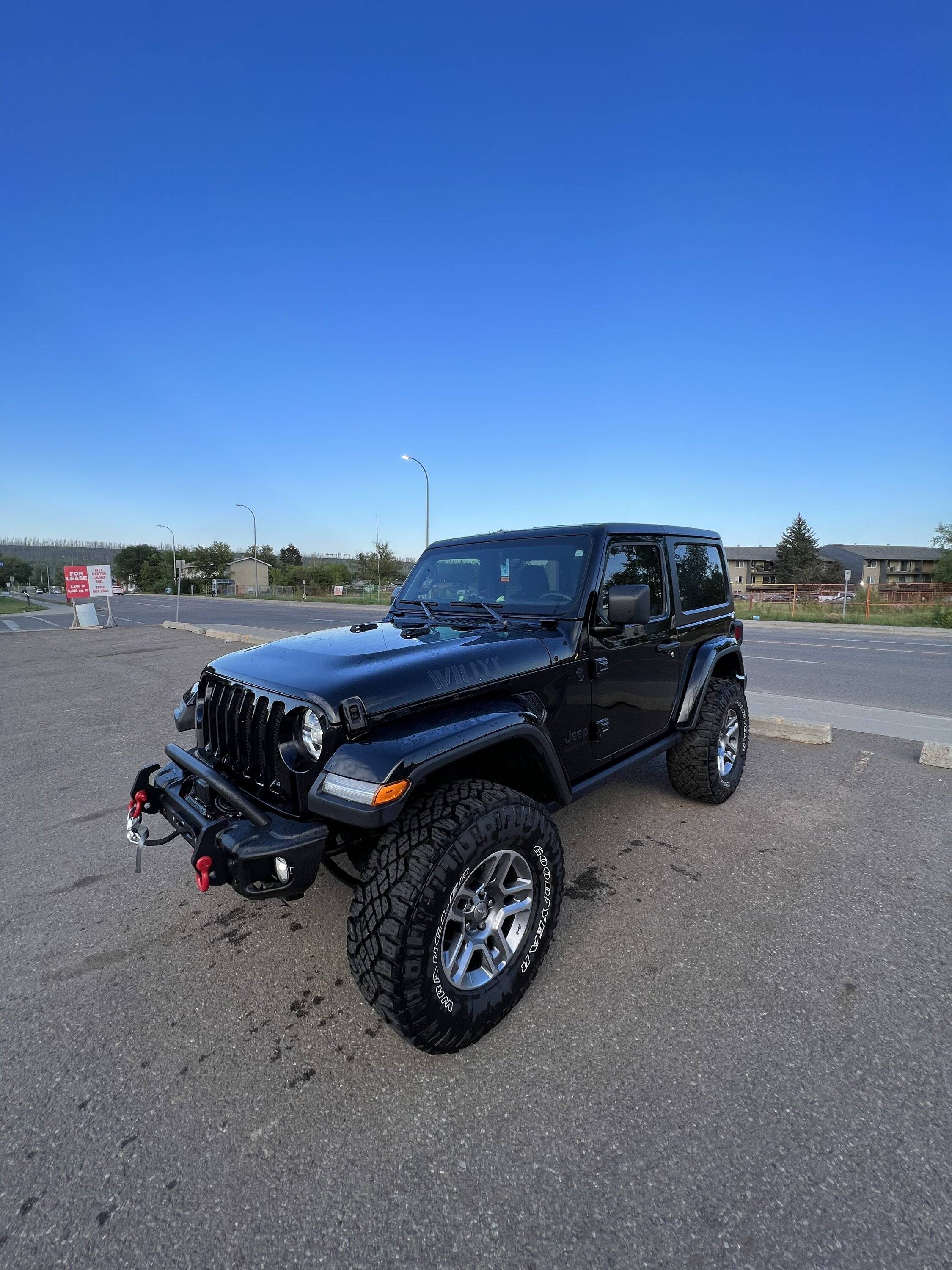

I am going through this dilemma right now.
i put rubicon springs on my 2 door Willy’s and the rear passenger sagged almost an inch lower than the other side.
after checking the part numbers on the springs yesterday I realized that 90AA spring is on the drivers side, and 89AA on the passenger. Thankfully the shop that installed them is going to swap them over for me next week, then hopefully it will sit proper for me

What did you put them on ? And how much lift did it give you ?
i also have a 2.5 inch spacer lift I stalled on my Jeep along with the rubicon springs

Looking good! What kind of tires are those?
I have a JLU with 2.0, SOT, aluminum front/light steel rear bumpers. I added a .5" spacer on the front to account for rake (and possible future winch), so after the switch I ended up with a 1.5" on the back and 2" on the front. Afterward I switched to take-off Rubi fenders/34" tires.

The tires are 315/70/17 duratracs. 60lb each . Rims are mopar slotted wheels

Wow they seem light for 35s! I like the silver/white combo, you don't see that on a Willys much

I had Federal 35s on before these, 80lb those were, ??
