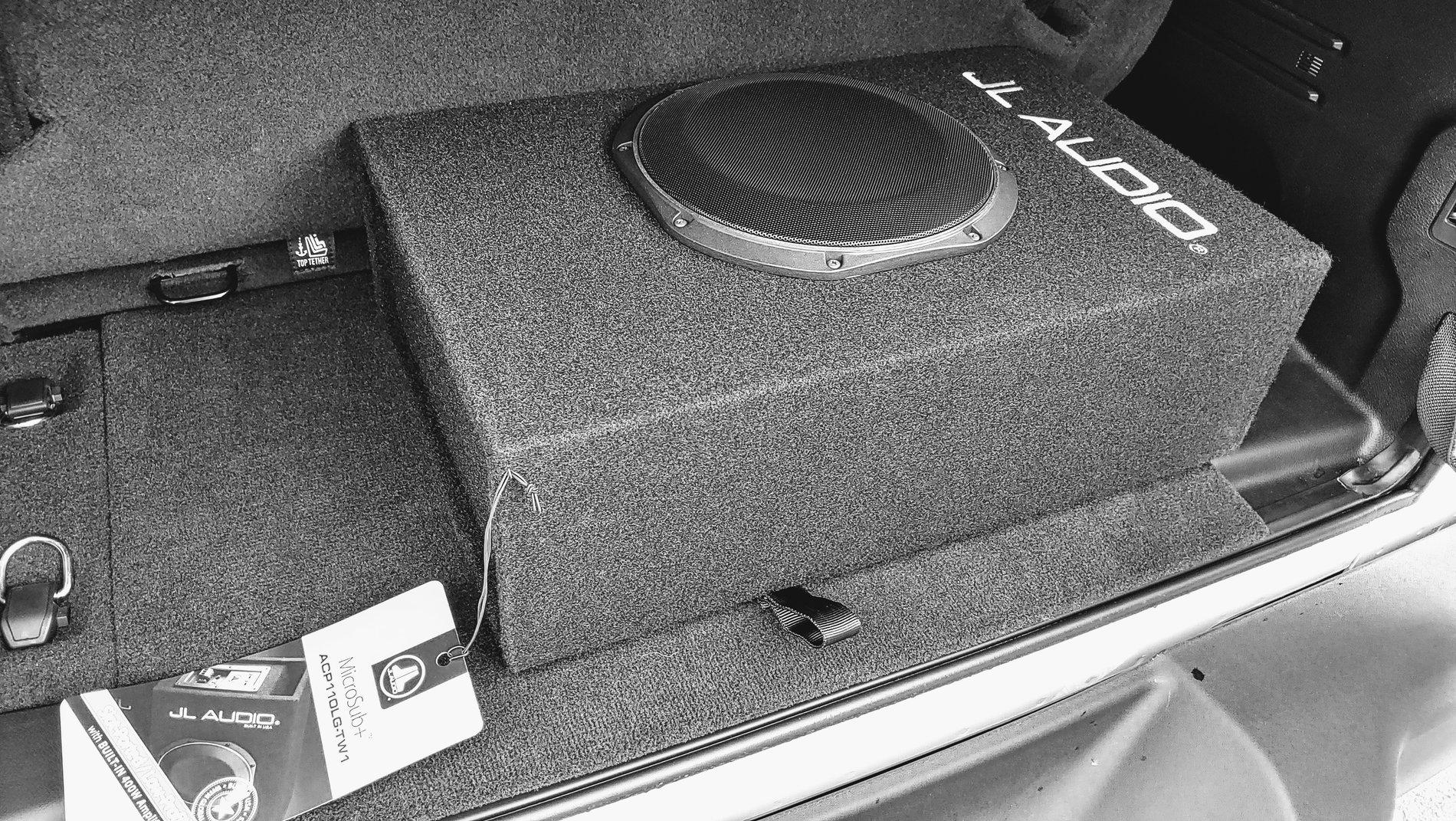

Love, love, love down firing boxes in Jeeps. I was just explaining this to someone a few minutes ago. Not only does it hide the subs, a traditional enclosure with the woofers firing back towards the tailgate, those pressure waves are lost in the open air when the top is down. By flipping the box over and down firing, those pressure waves resonate on the frame of the vehicle and are better timed, more quickly felt and less likely to be lost in the open air. Great idea for anyone building a box for their Wrangler, down fire all the way!I ordered my JL AUDIO VX1000/5. 2 sets of the C2 3.5” speakers and 2 sets of C2 4” speakers and 2 TW3 10” subs. I’m replacing all speakers. And going to build a down fire box that is the shape of the rear floor. That way if anyone looks in they won’t be able to tell and I can still use that area to carry items.
I’m looking forward to getting this done. The factory system is terrible.
