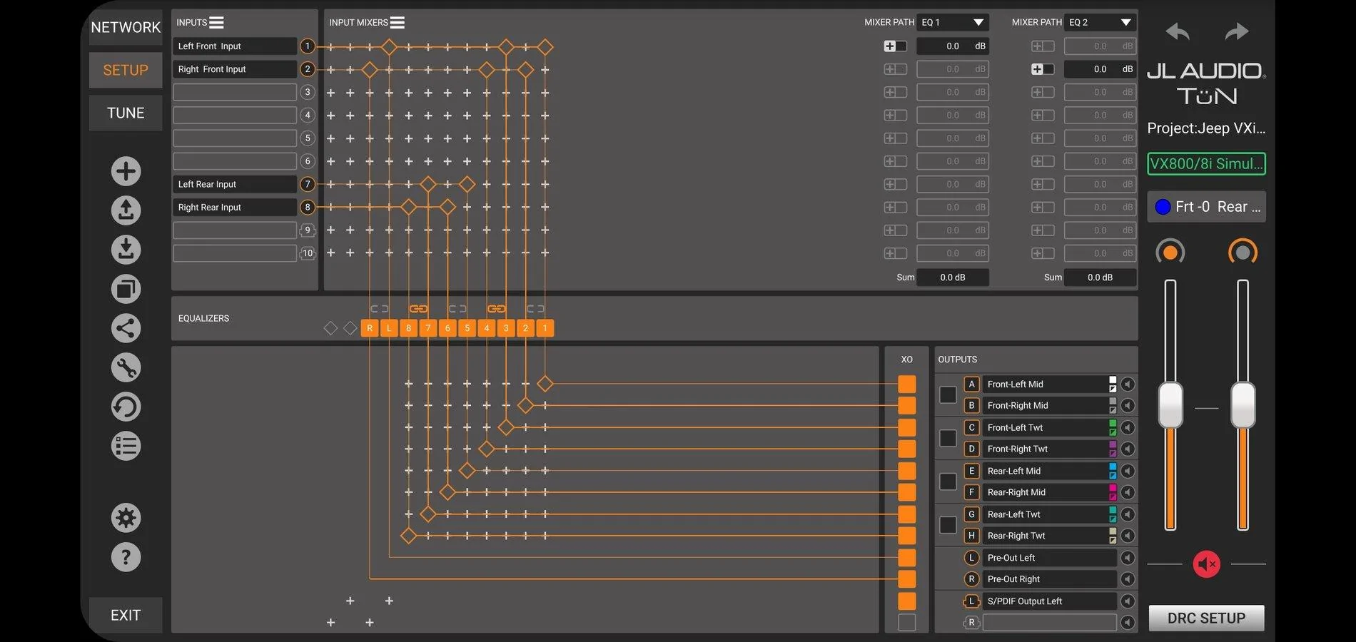

This is an overwhelming YES. It provides an EQ, Cross-over, Time-alignment and more for each speaker, and it also provides the ability to set up and easily access "profiles" such that you can tune the sound-stage exclusive for the driver with the top on, and top off or any other creative options you can think of using those controls. It's extremely flexible.

The DRC-205 is strongly recommended with the VXi amps, as it gives you fingertip control of your sound profiles and gain control. It's a programmable device, so you can tell it what you want the two knobs to do. I also added the Bluetooth module, but really don't find much value in it. If you have it, you don't need to connect your tablet via USB to change the profiles and other stuff. Oddly (at least as of the last time I tried it) the Bluetooth only works with phones/tablets and not a Laptop! It's just a bit more difficult to connect over Bluetooth when comparing the ease of use using the DRC-205.

As for your last question, the DSP can control your sub, too. That is, as long as you're connecting the sub through the VXi directly, or through the VXi's RCA pass-through. You actually "draw" out how you want the inputs to feed your system via the TUN software. It's the most amazing part of the VXi option. That may be difficult to picture, so here's a snapshot of what I'm talking about. I've changed mine up a bit on a different system, but you'll get the gist of it. Hope this helps!
