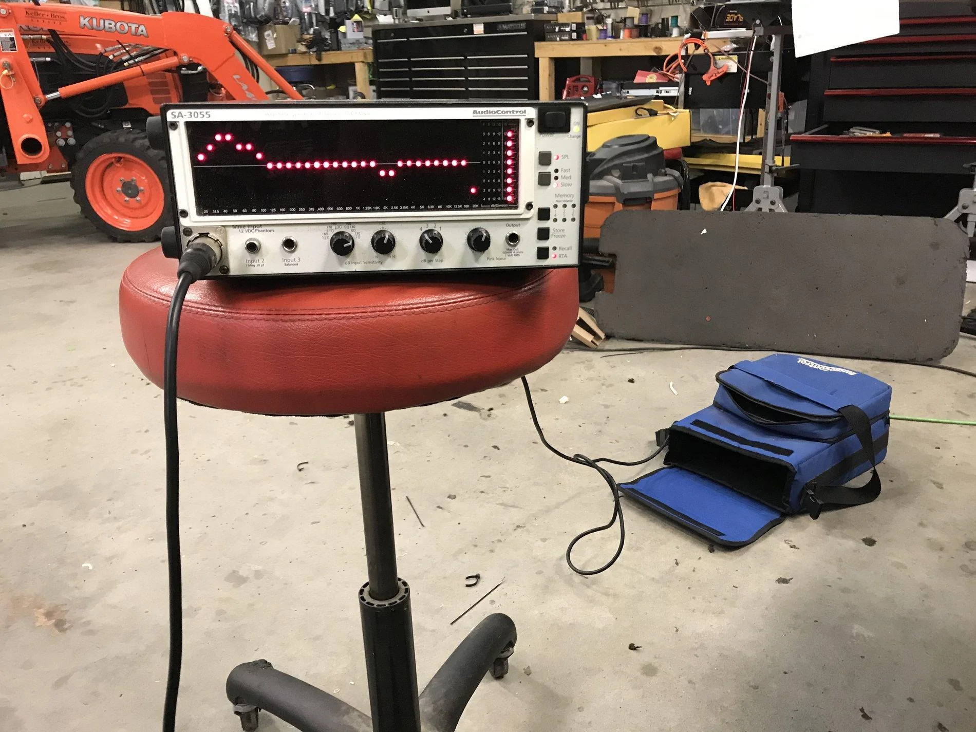

Hubby ended up stealing the VXI amp I had set aside for my own car and installed it in our JLU earlier this week. First stab at tuning (late, late at night er, actually early morning, after hours, after working on customer's cars ON our anniversary too ) and here is the RTA curve. He will fine tune some more when he has some free time, but amazing quality and control.The DRC-205 is strongly recommended with the VXi amps, as it gives you fingertip control of your sound profiles and gain control. It's a programmable device, so you can tell it what you want the two knobs to do. I also added the Bluetooth module, but really don't find much value in it. If you have it, you don't need to connect your tablet via USB to change the profiles and other stuff. Oddly (at least as of the last time I tried it) the Bluetooth only works with phones/tablets and not a Laptop! It's just a bit more difficult to connect over Bluetooth when comparing the ease of use using the DRC-205.
