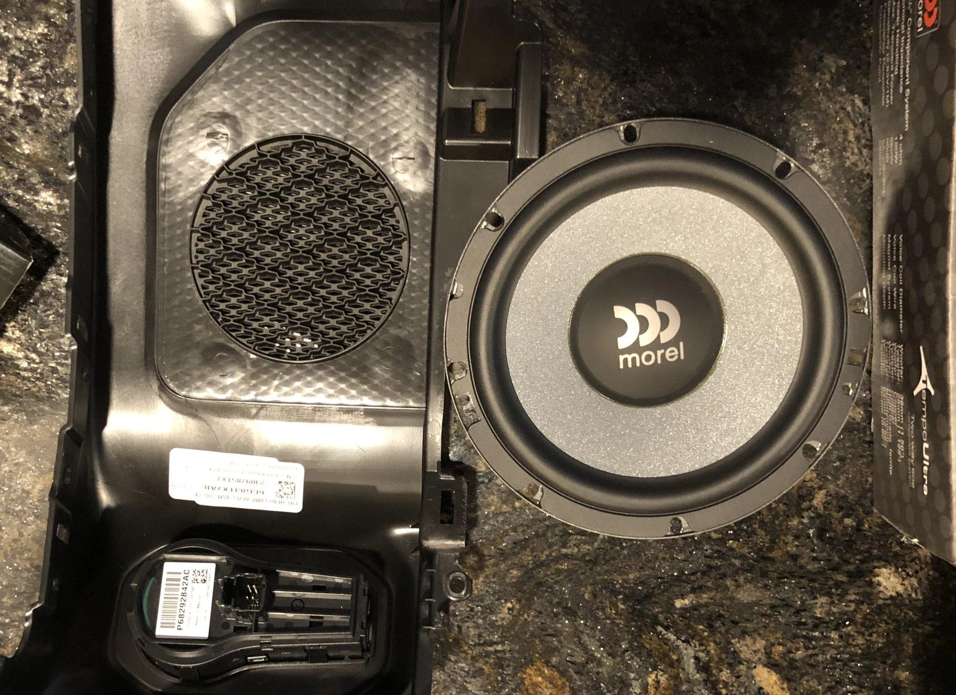

I just completed my upgrade. I went with a Kenwood DMX7706S.
An Idatalink Maestro RR with the HRN-RR-CH3 harness and PAC BAA22 antenna adapter.
Alpine PDR-V75 amp
Morel Tempo Ultra 602 speakers In Metra JP-1014 pods.
JL 10TW1-4 sub in a box i built to their specs.
The install is very labor intensive. I probably have 20 hrs in it.
The sound is good not great. The grills in the dash are restrictive. They are small and not centered on the speakers. I do not recommend upgrading to 6 1/2’s unless you are willing to modify the dash.
Jeep Wrangler JL Speaker replacement upgrade upload_2020-1-15_12-59-50
Also the left and right pods are not the same in some way, so as i perform a frequency sweep the sound moves around.
The 5 channel alpine amp is also overkill. I knew it would be but i got a killer deal. I recommend a nice 3 channel with dsp like the Audiocontrol if your on a budget. Being able to pull frequency spikes down on individual channels is a really nice feature that i will have to add separately.

do you have any more pictures how your oem grill was modded on front section , also on sound bar installed pictures ?
thanks !

yes, it is a significant improvement over stock. But I did more than just replace the speakers.
Carstereochick recommended some Morel 4" speakers that were pretty pricey but she says sound great. Im curious how that install compares to mine with the 6.5's behind the stock grill.
