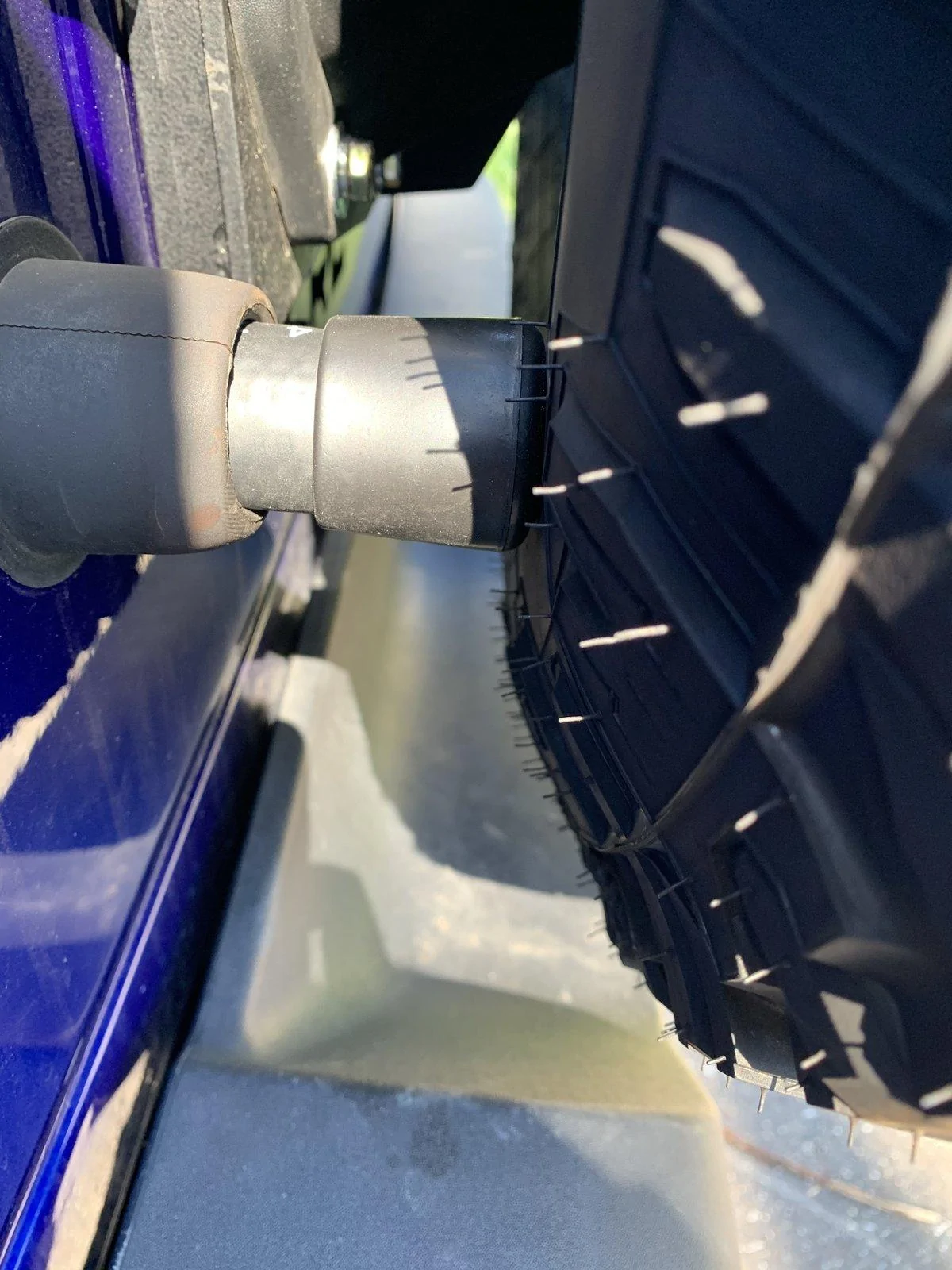

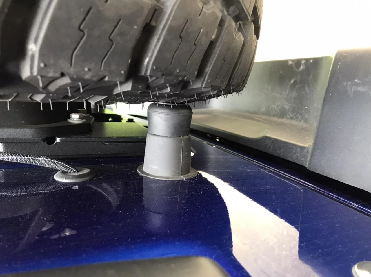

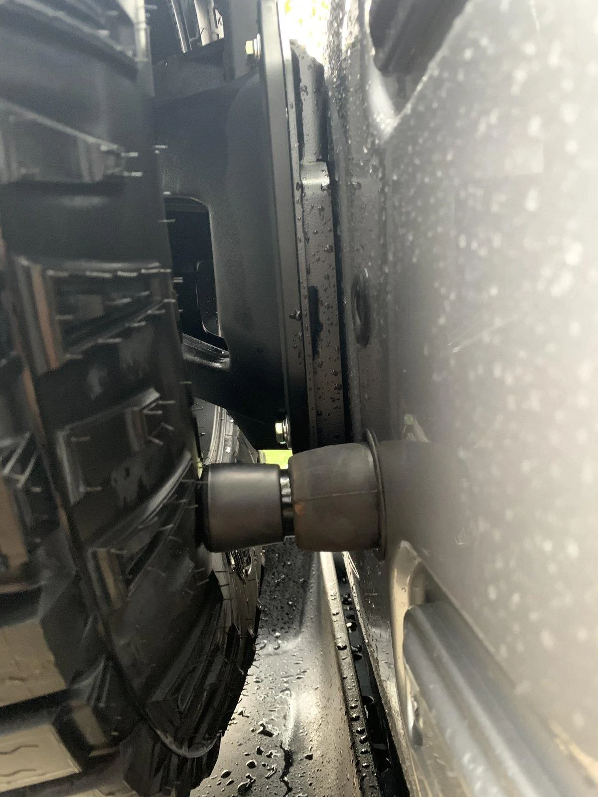

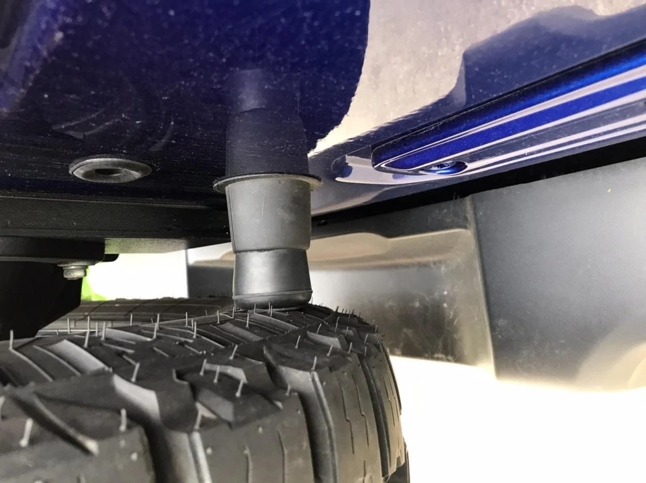

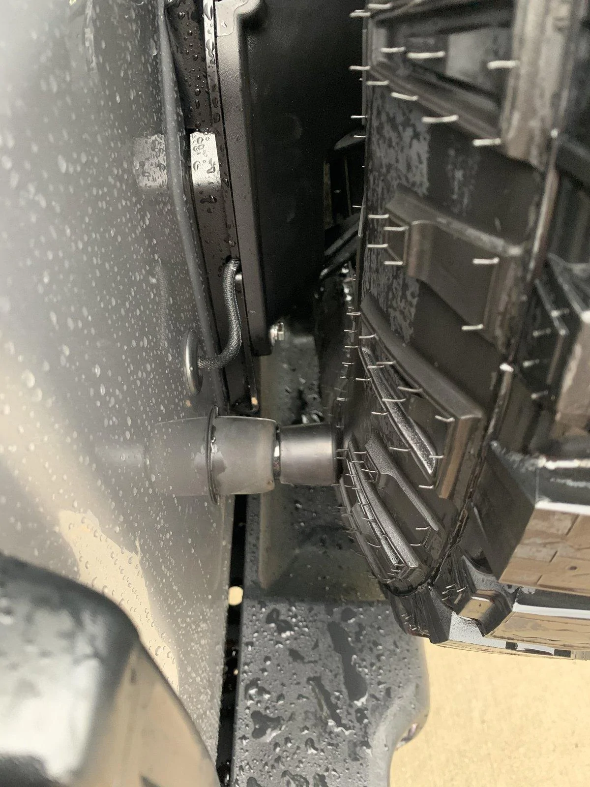

Stuckinthesand Well-Known Member First Name CJ Joined Apr 6, 2020 Threads 25 Messages 1,112 Reaction score 1,286 Location NJ Vehicle(s) 2019 Wrangler Sport S Sep 6, 2020 #4 1 1/4 Dishwasher discharge hose and rubber chair tips
Stuckinthesand Well-Known Member First Name CJ Joined Apr 6, 2020 Threads 25 Messages 1,112 Reaction score 1,286 Location NJ Vehicle(s) 2019 Wrangler Sport S Sep 6, 2020 #5 Here you go

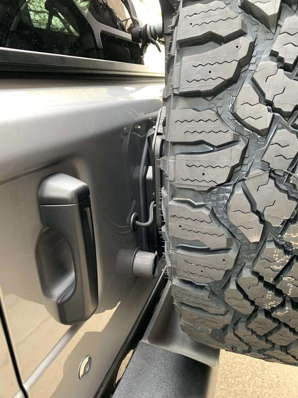

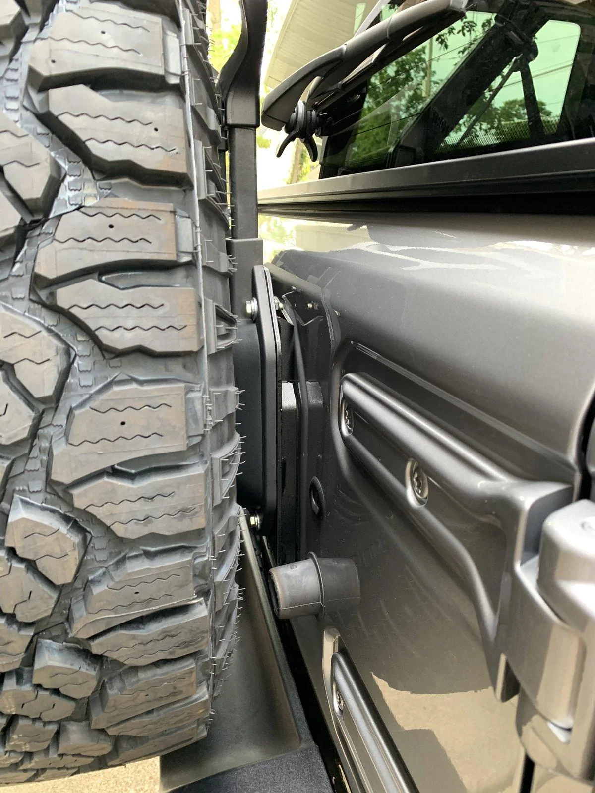

cOtter Well-Known Member First Name Chris Joined Aug 6, 2019 Threads 20 Messages 986 Reaction score 2,133 Location Southern, Indiana Vehicle(s) ‘20 Sahara 2.0L Ocean Blue Metallic, Toyota Highlander & Pontiac G6 coupe Occupation Senior Manager PM (Automotive OEM) Sep 6, 2020 #6 I have ran with a setup like the one above. Works great.

OP OP Yovwmon Well-Known Member First Name Adam Joined Sep 8, 2019 Threads 19 Messages 105 Reaction score 108 Location OH Vehicle(s) Wrangler JL Altitude Sep 7, 2020 Thread starter #10 Thx to all that replied with ideas. I went the 1 1/4 Dishwasher discharge hose and rubber chair tips route and it’s perfect.
