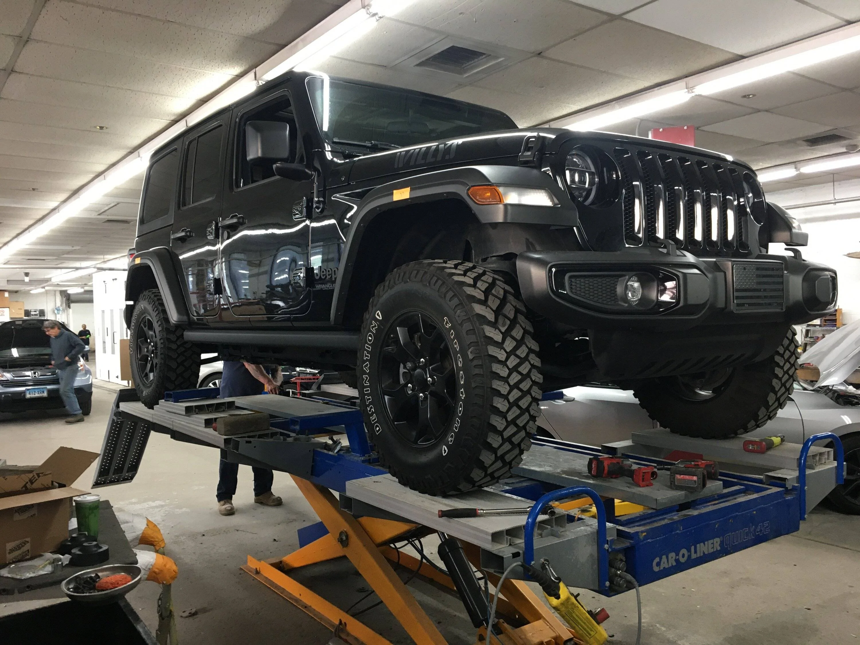

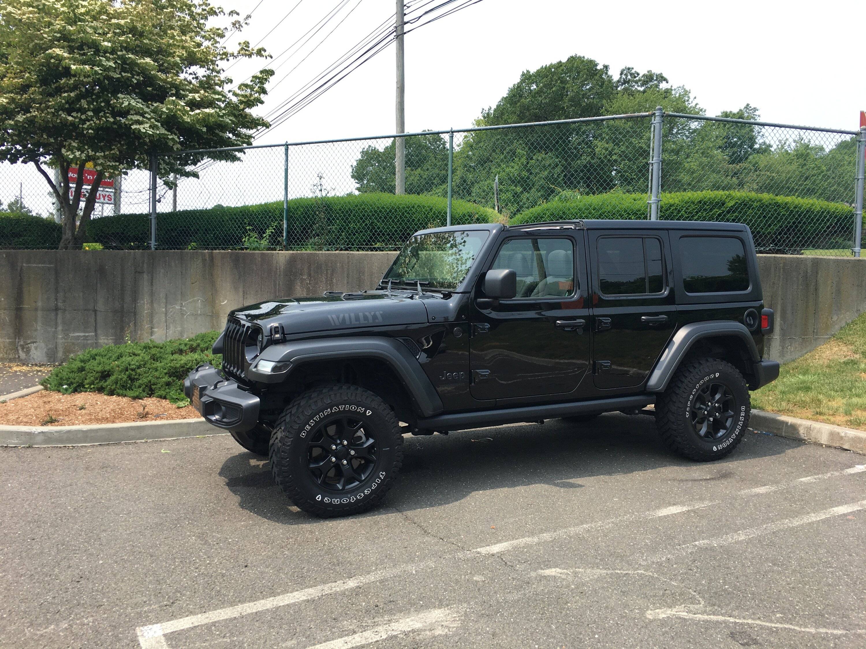

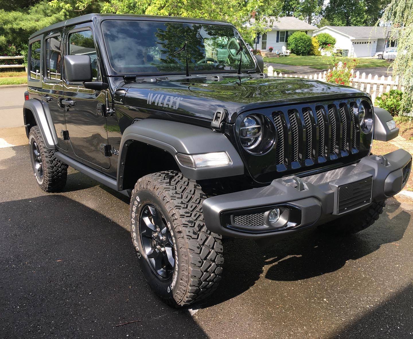

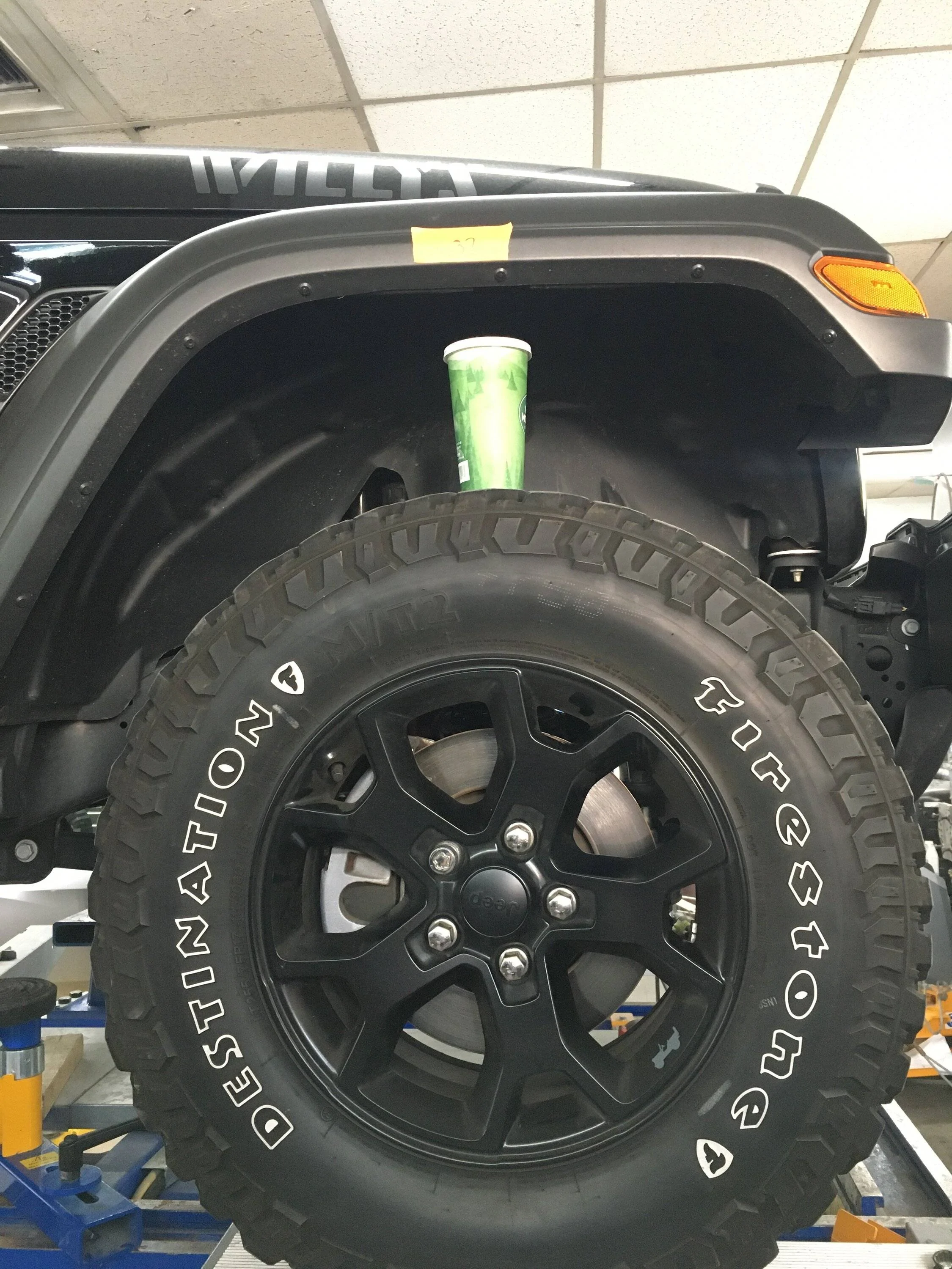

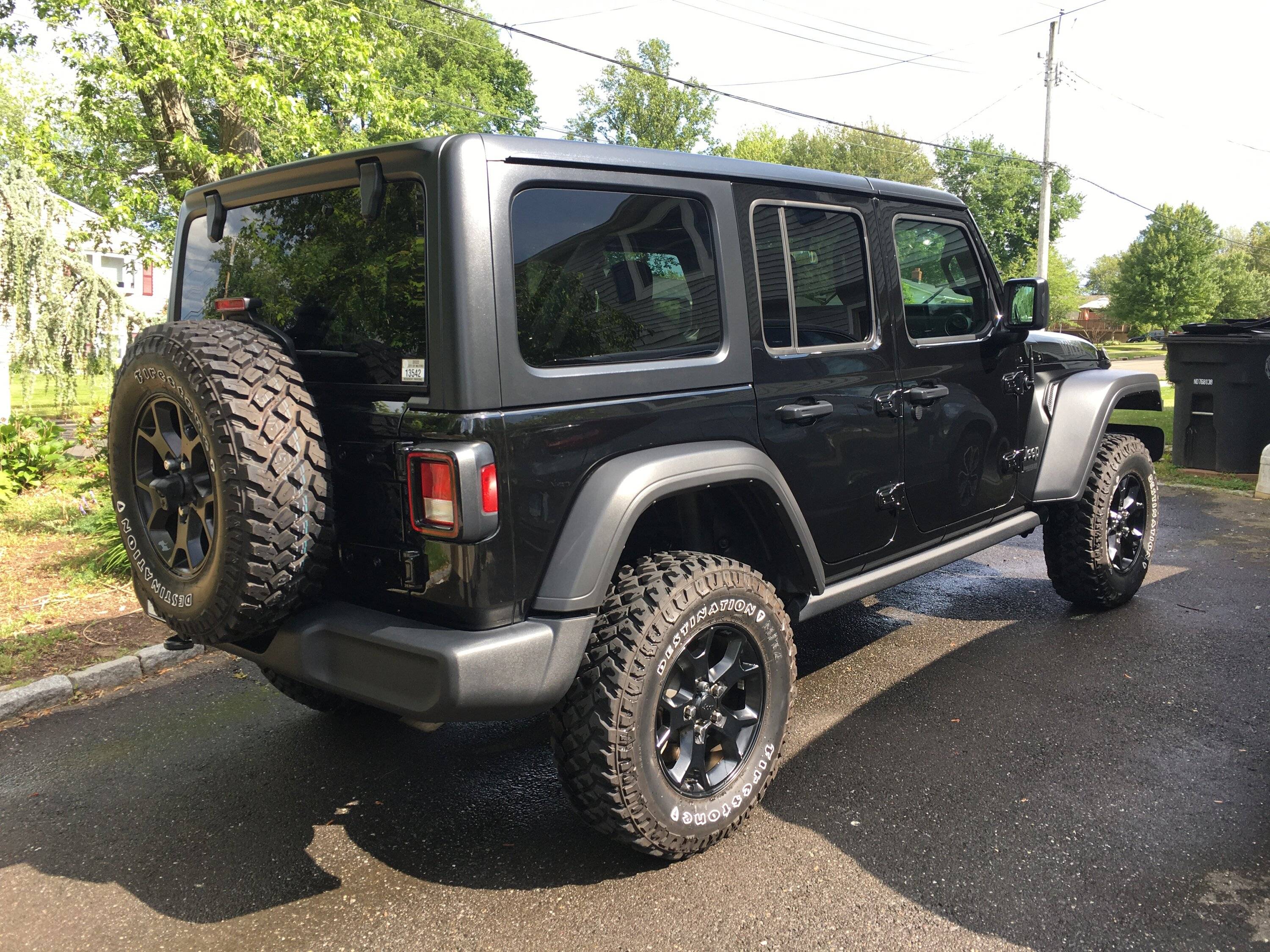

Terra flex level kit and quick alignment afterwards. Get a little over 2 inches in front and 1.5 in rear.

looks great man. Do you have the eTorque v6? And hard top from factory? I only worry about having too much "level" upfront. Mine didn't come stock with the hard top and I added that later, so my rear from the factory shipped with soft top springs.
Did you add anything else or literally just the spacers?

Came from factory with hardtop. There is still a little rake forward. Pretty much level. I just did the Terra flex level kit and spare tire relocation bracket. Rest of the suspension is stock.
