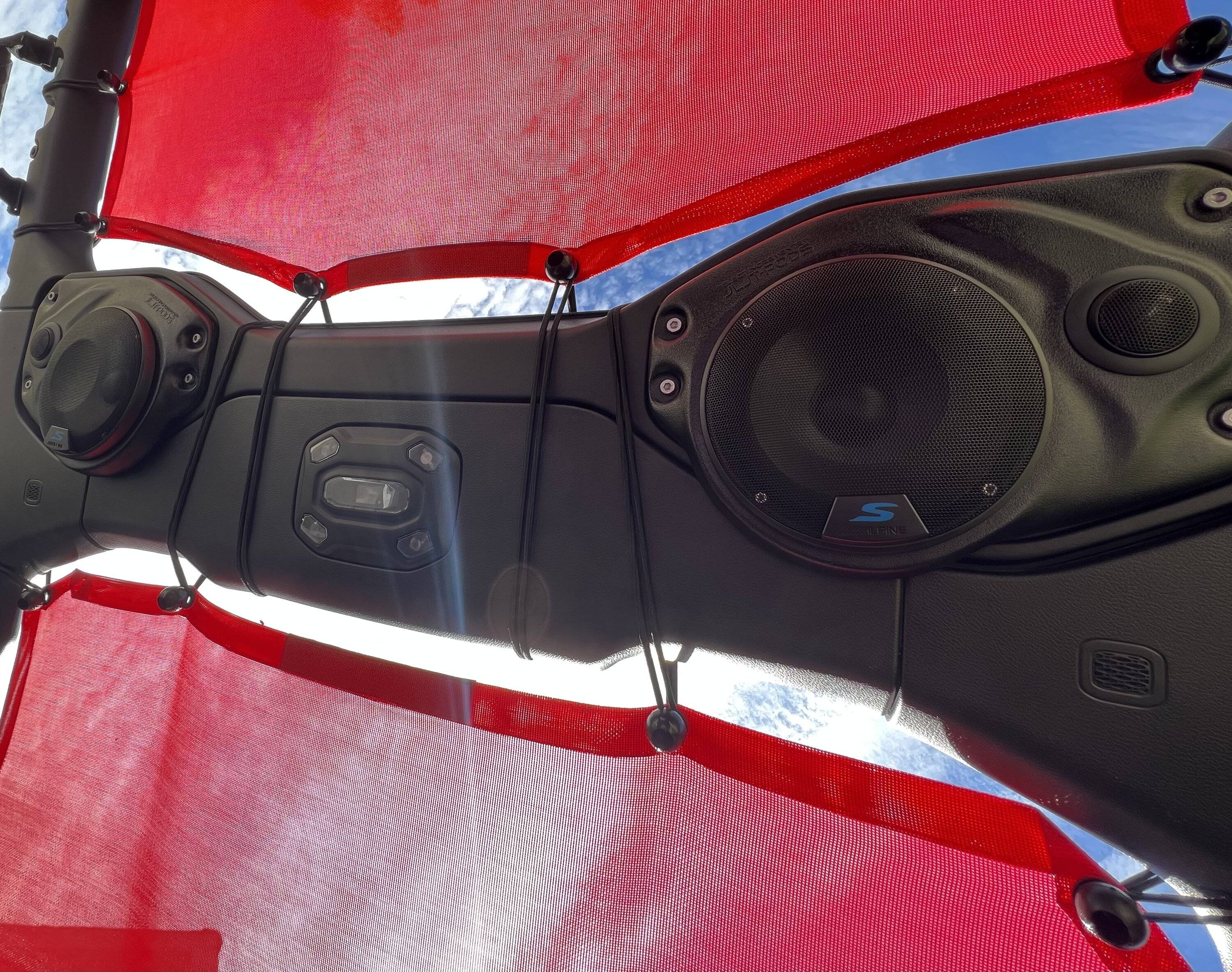

I would go with the Select Increments JLJT-Pods + Alpine S-S65C. It’s pretty much plug and play without having to butcher up your soundbar.

Yes i did and works great. I wanted the 6.5 speakers to match the factory Alpine Subwoofer and this is a nice clean upgrade without having to cut up the internals of my soundbar…. I finished upgrading my sound system by installing the Terra Acoustics front speakers. This in combination with the SI Pods + Alpine S-S65C, knocks it out of the park IMHO..
It all Looks OEM which is a must have with every mod i make..

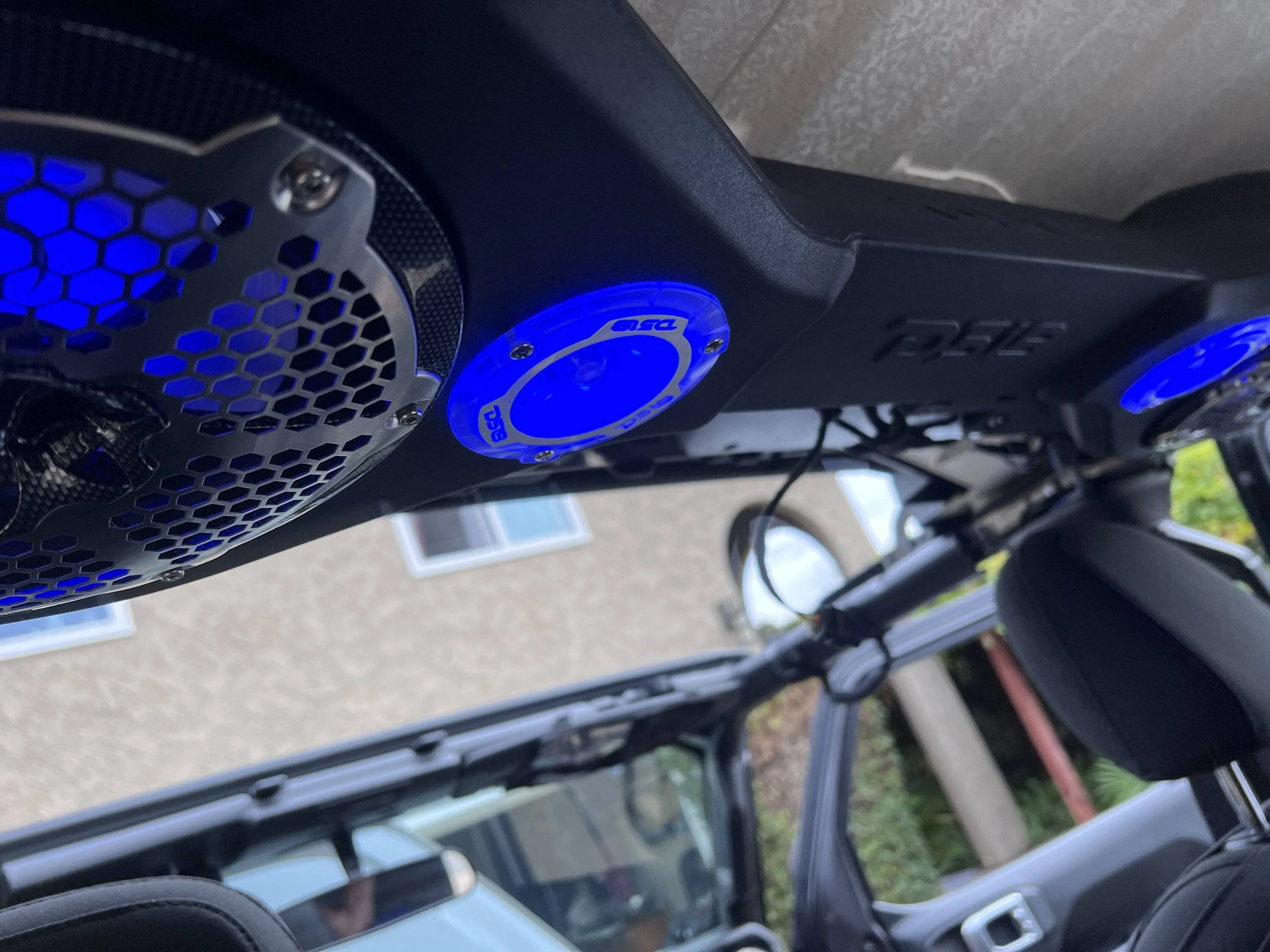

Went with the DS18 JLSBAR22LOADED. I had to connect and install the speakers myself, the sound bar is a direct replacement and the connection is plug and play, and I had to run the RGB wire to the battery and another wire to the 12v cigarette lighter (pink and yellow wire) - overall 3 hours of work and I am very impressed , it was a significant upgrade - I forgot, there were no screws for the tweeters, so you’ll have to find 6 small screw.
How did the soundbar connect to factory wiring? Did you have the Alpine Premium?
There’s a direct plug and play for the speakers and I had an amp plug as well - but I didn’t use it - I don’t have the alpine amp- DS18 states - Included are plug and play options for your speakers that integrate into your factory wiring and amplifier or you can use an external amplifier for even more volume.

i used the Alpine S-S65C (vs the Kicker speakers) with the SI Pods because i have the factory Alpine Subwoofer and wanted it all Alpine. it was plug and play with no added wiring, cutting etc. The added Terra Acoustics front speakers just knocks it out of the park IMHO..
