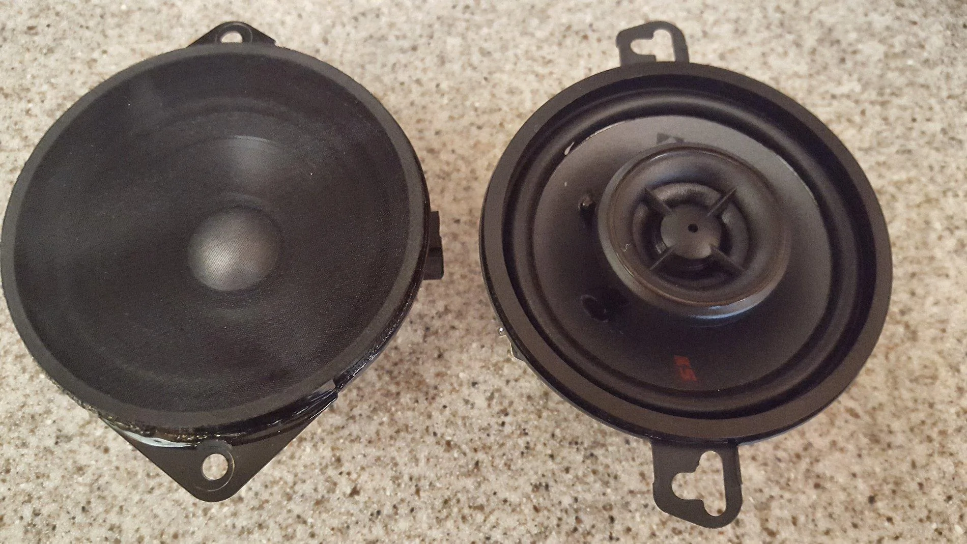

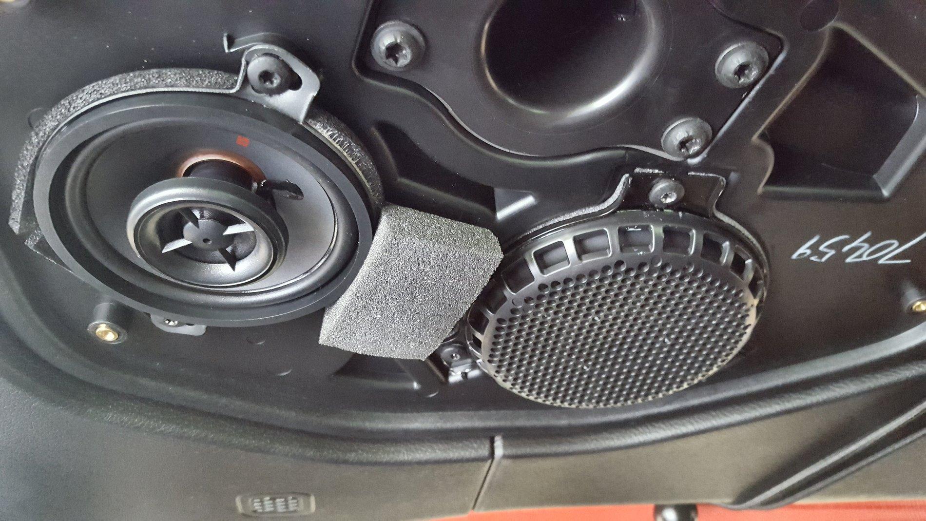

Hello Everyone,
Just a quick heads up one a way to make your Alpine system sound a little better. The dash & soundbar speakers can be easily replaced with 3.5" Coaxial speakers. I started off with some Kicker KSC3504 speakers and I thought they were a little to sharp on the high end. I switched out my dash speakers with JBL CLUB3020 speakers. Unfortunately, they were too big to replace the 3.5" speakers in the sound bar so I left the kickers in there.
The second speaker in the speaker in the sound bar is a 4" speaker with very unique mounting points...unless you want to drill into the plastic sound bar housing. I chose to stick with the factory Alpines there until there is some sort of direct replacement. From what I have researched, the same 4" speakers with the 3 mounting points are the same in the knee panels. The factory Alpine speakers do have small magnets but at least they are not the typical cheap paper cones.
All 4 speakers I replaced screwed in to the factory mounts with no modification needed. Do not over tighten in the sound bar or you will pull out the screw anchors in the plastic. The wire adapters you will need are the Metra 72-6514. You will need 2 of those.
Overall I am happy with the sound. I have much better highs from symbols, vocals, guitar and mid base...this should all get better are the speakers break in from my experience.
