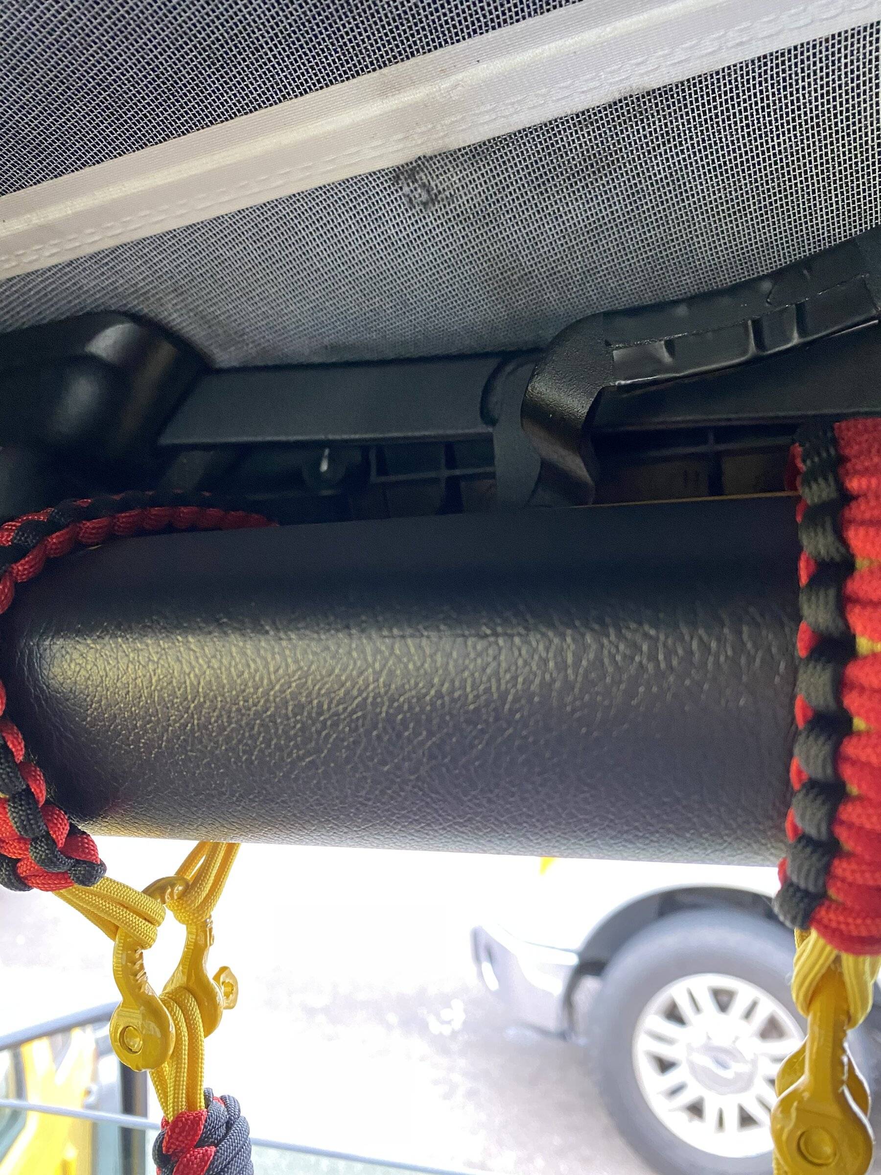

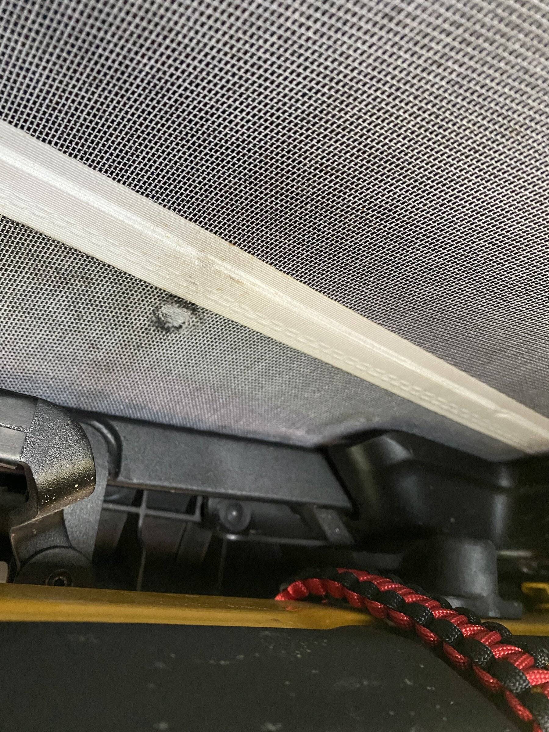

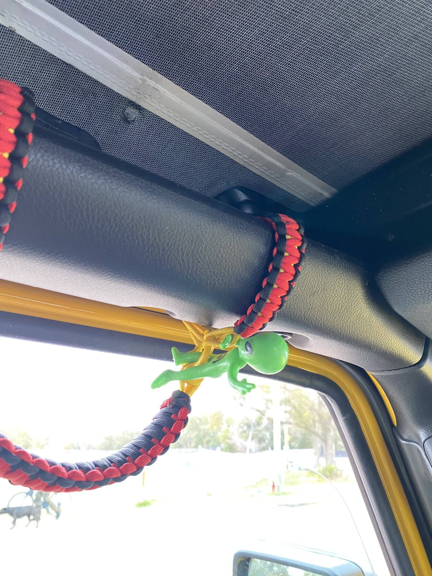

Have a ‘21 JLUR. Same thing happening on mine. Got it June 2021. I use the sinrider position often but only put it back all the way a few times. Then I installed a Fishbone shelf in the back and it can’t be put all the way back with it installed, so it hasn’t been in about 4 months. Sounds like it can be replaced under warranty but still keeps happening.
First two pictures are front driver, side, last one is passenger side in front.
Other than OP, has anyone else had difficulty getting it replaced?

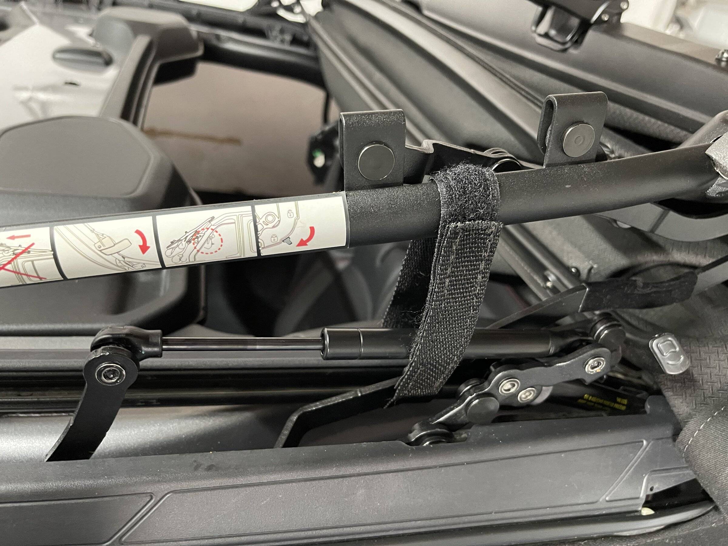

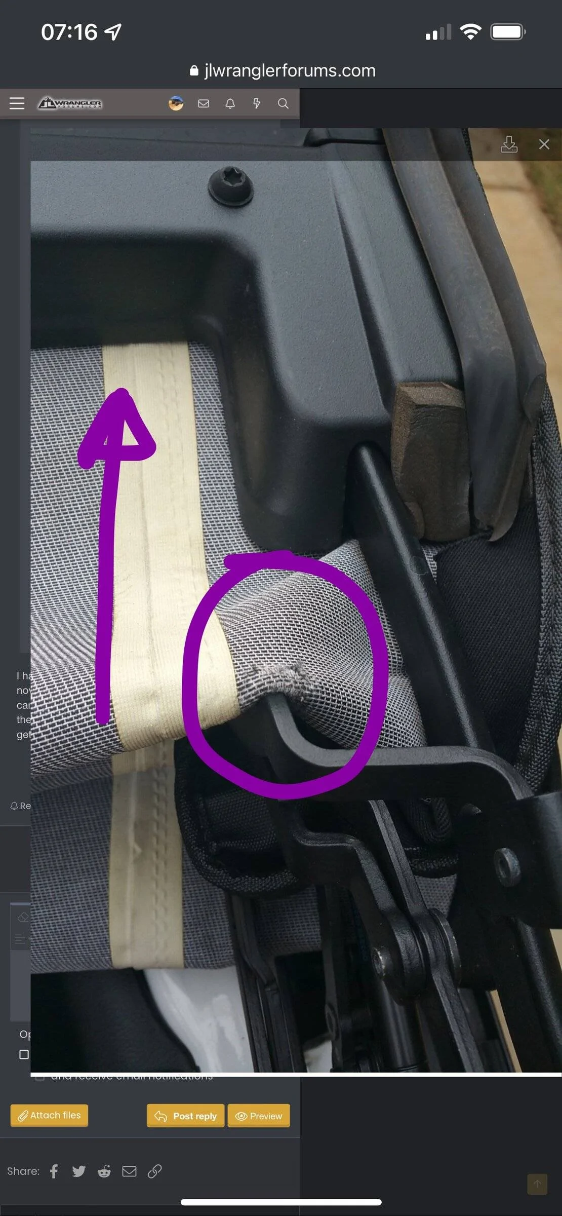

You are folding your tops incorrectly. The material must not be pinched by the metal hinges of the frame. Make sure you fold the soft top material away, I tried to illustrate with the purple arrow.
If you do not want to or for some reason don’t agree then at least get some black rubber hosing and put that over those metal parts where it pinches the soft top. It will mitigate the scissors type of movement by the frame hinges that are causing the damage.
I fold the soft top away from the frame so it does not pinch and use both velcro straps to minimise the movement.

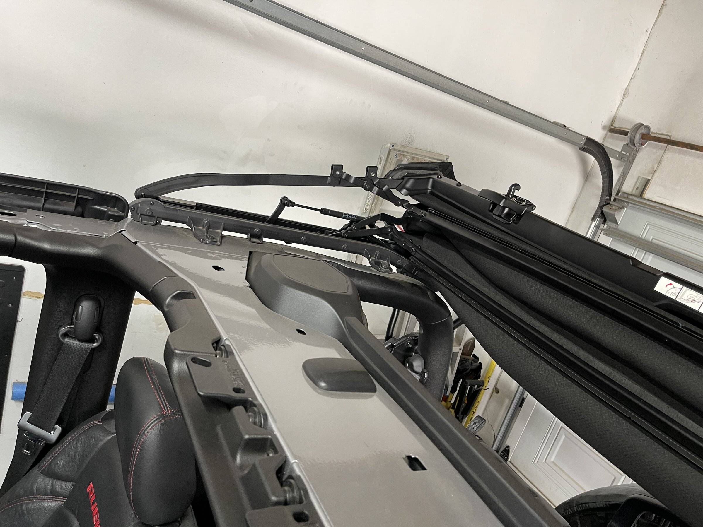

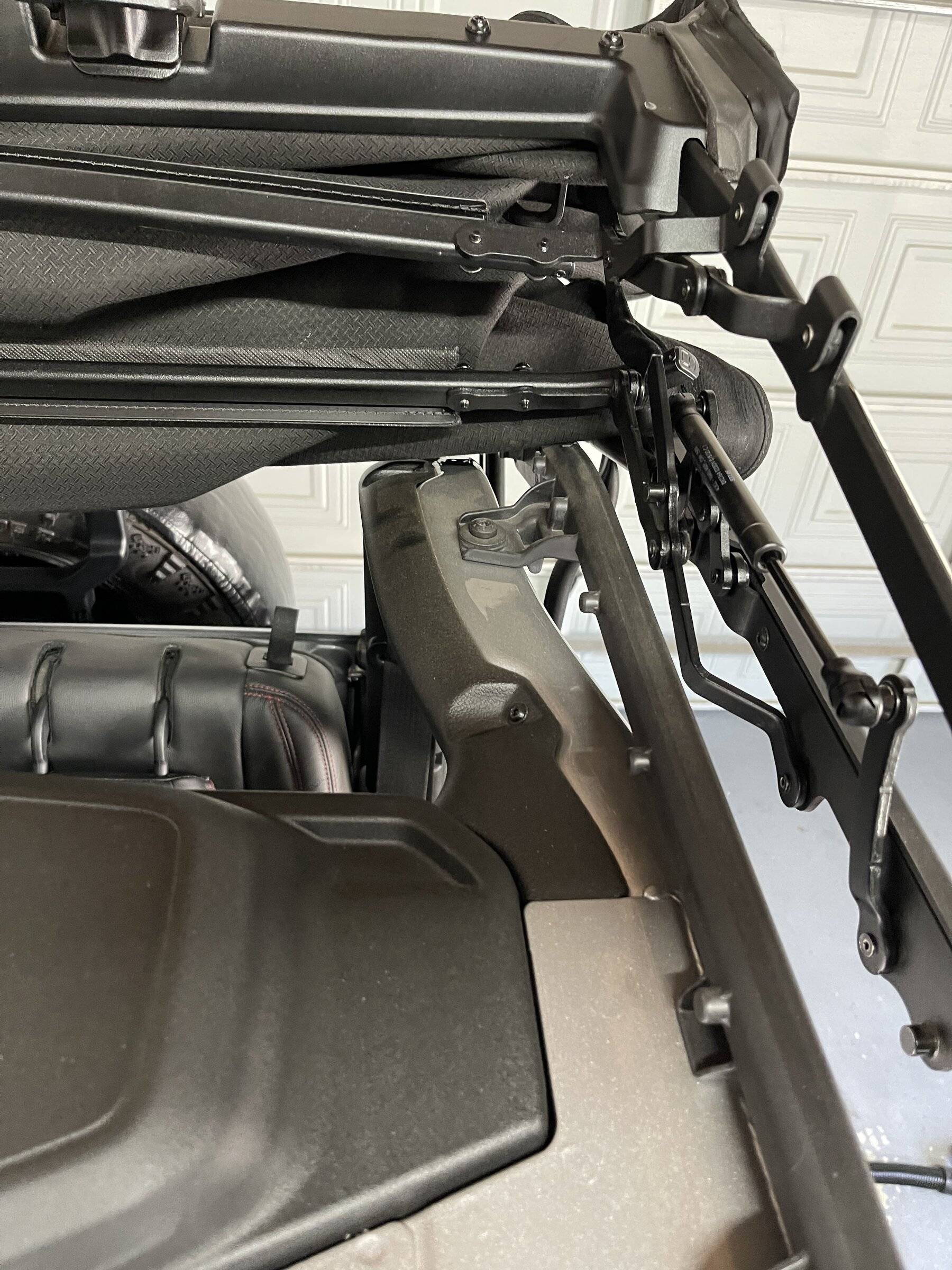

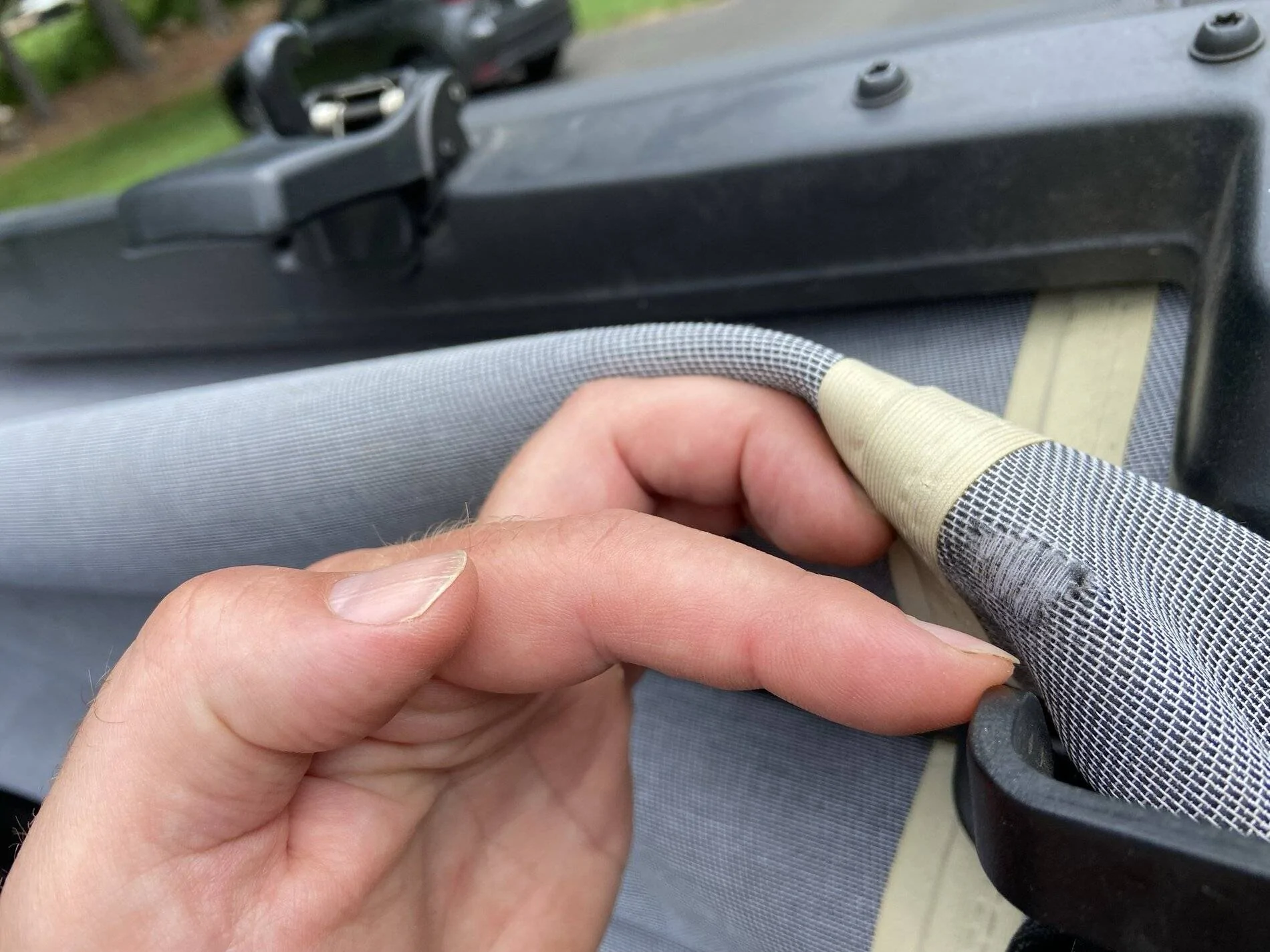

My soft top seems to be made from a different material. Maybe I got the cheap version.
Any case, have a look at these pictures. It will give you an idea of how I fold my soft top to get the material out of the way of the soft top frame (Scissors effect).
