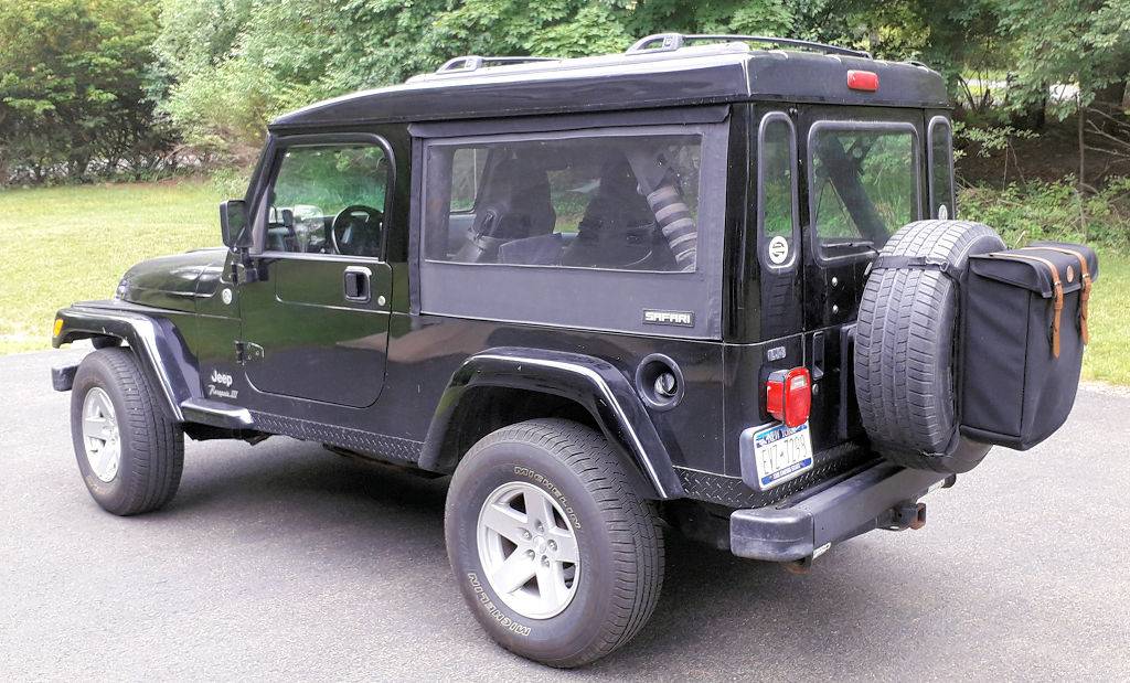

Back when the Sky One Touch top first came out I was surprised that they didn't offer roll-up soft sides for it. I had implemented them to swap for the removable hard sides on my TJ/LJ Safari Cab hardtop design about 8 years before the JL top came out. I did some preliminary design work on roll-up soft sides for the JL and considered creating a prototype set to shop to some of the Jeep accessories companies I've done designs for but at the time there didn't seem to be enough interest to make the project worthwhile. It's not a terribly difficult design to implement, I'm surprised nobody has done it yet. Here are a few photos of my LJ Safari Cab with its roll-up soft sides, the same thing could be done for the Sky One Touch.
Jeep Wrangler JL Sky one touch window alternative? PanelSides3
Jeep Wrangler JL Sky one touch window alternative? NewZipperStripsWithOldSides
