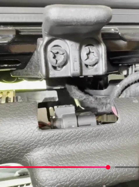

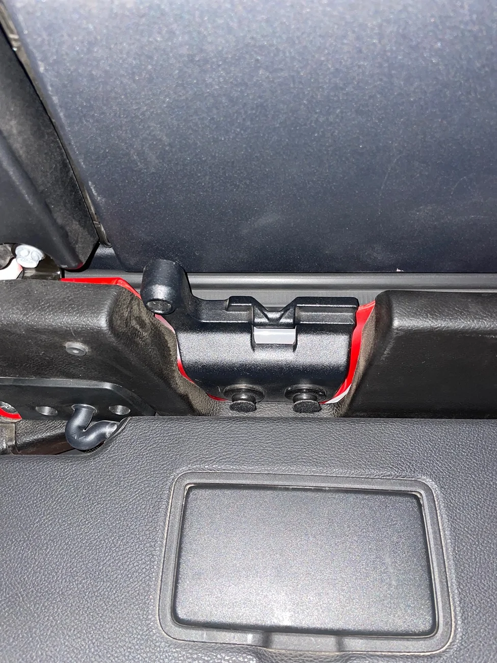

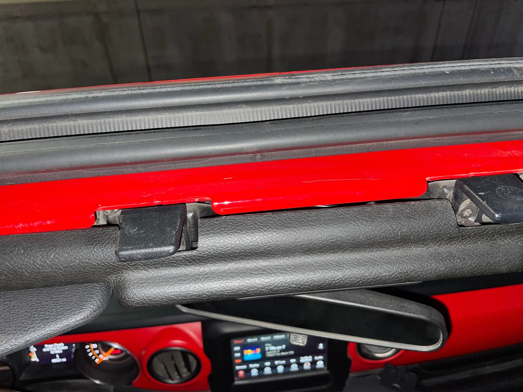

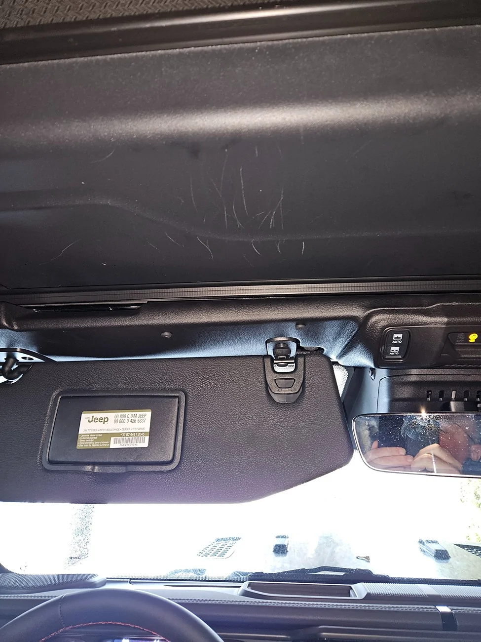

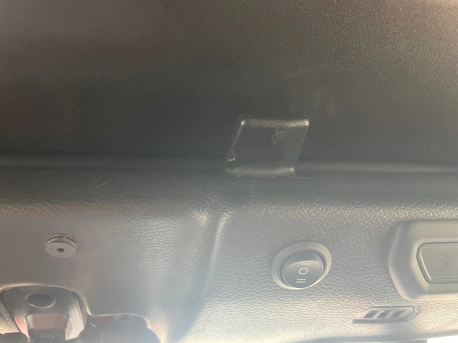

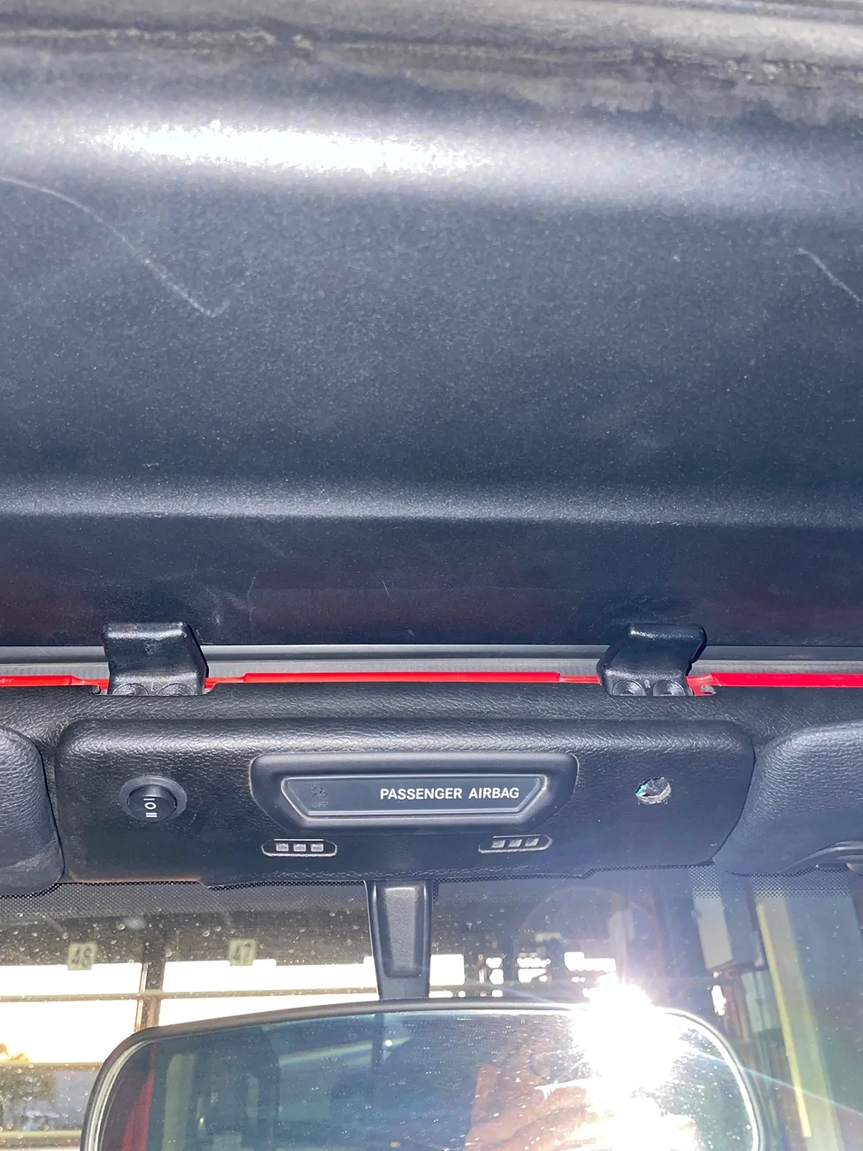

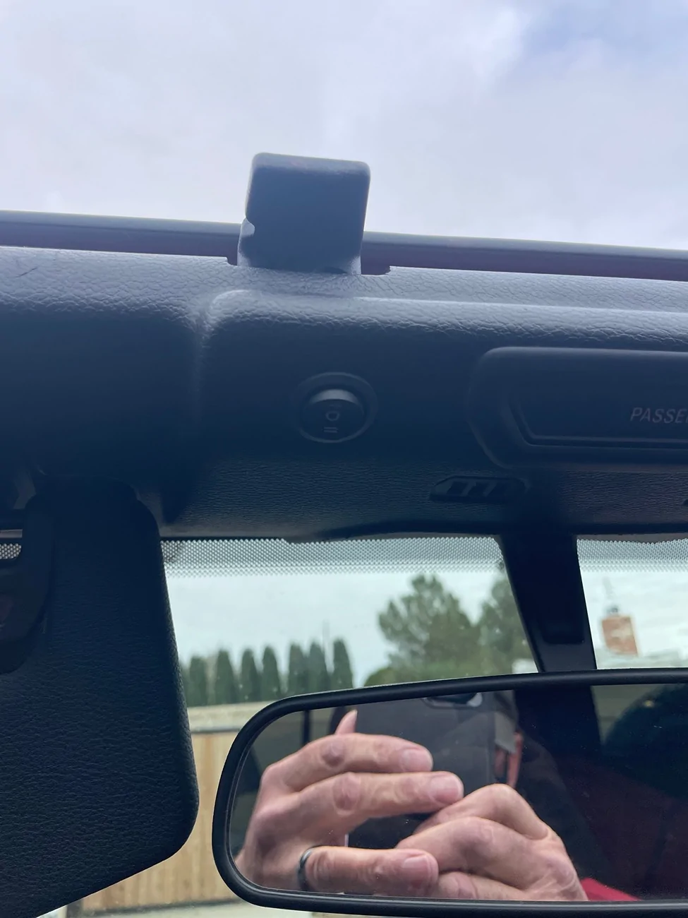

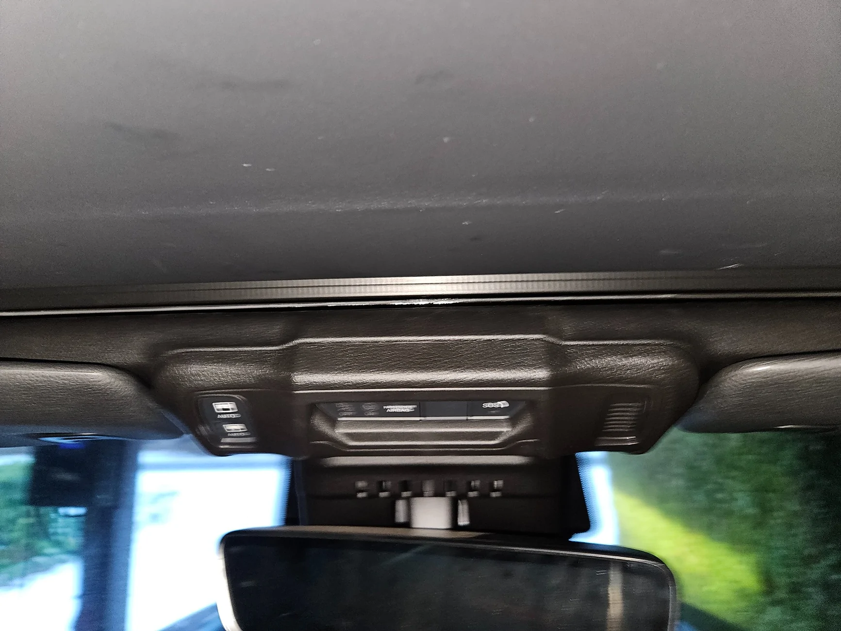

Besides a full Softtop kit, you need the Targa brackets and a windshield header molding with the cutouts for them.What are the parts I need to order to swap from SOT (JL rubicon) to soft top?
68469893AC Targa bracket left
68469892AC Targa bracket right
eBay windshield molding

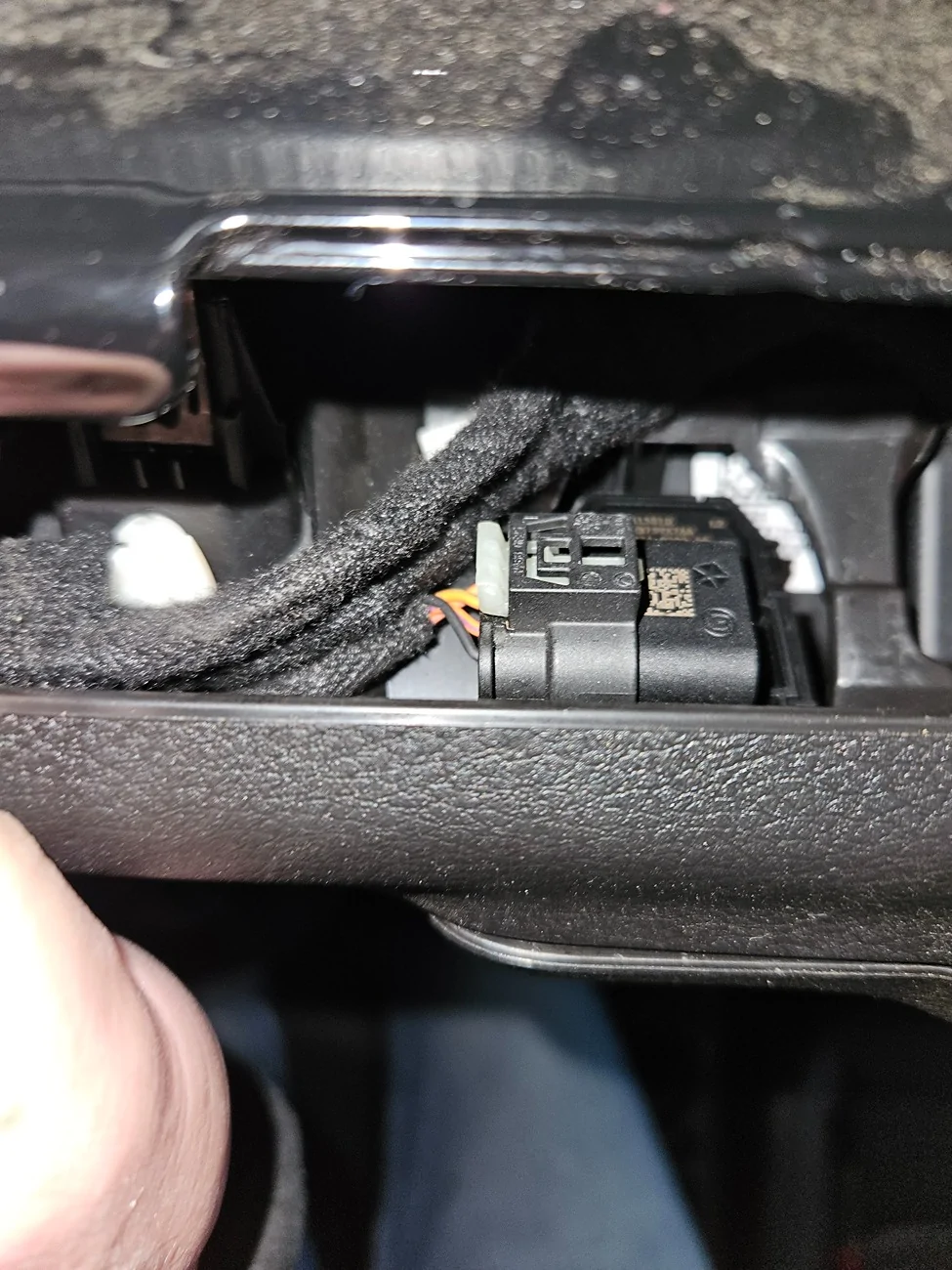

I would buy a windshield molding from eBay and swap all my wiring and seatbelt/Sos/Assist button over to it, you will have the connector for the SOT switch that you won’t plug in but it doesn’t cause any issues.
Gregj
eta you need four bolts for the brackets 6512230AA
