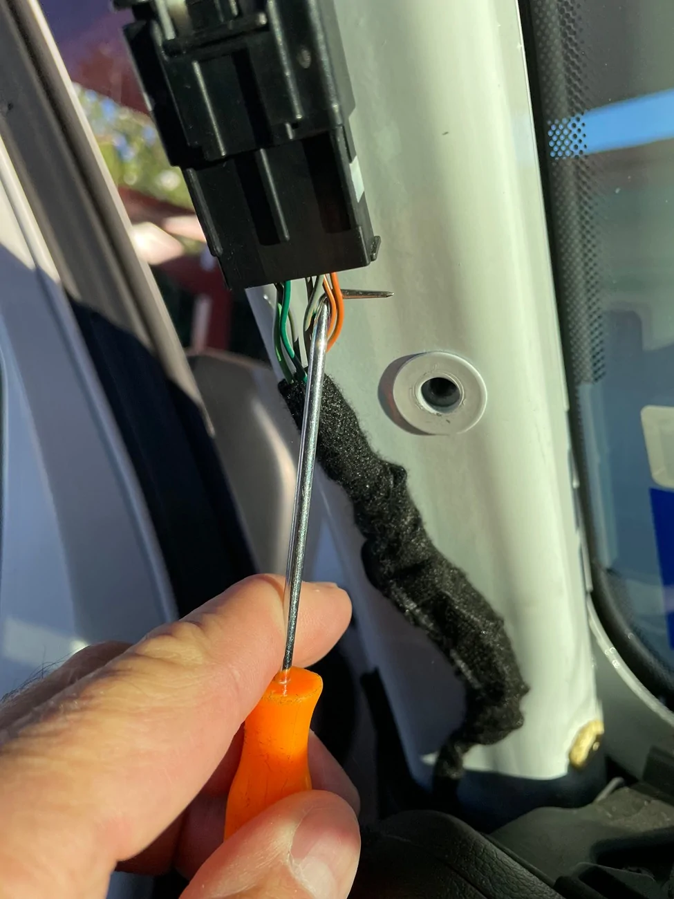

I would set aside a few hours the first time. One caveat, the Jeep you are going to put the top on MUST be a factory hardtop and depending on the trim level it may be missing the two trigger wires for the SOT. If you want to verify the wires are present look for these two wires in the harness under the drivers side grab handle.
Jeep Wrangler JL Sky One Touch Roof Conversion? IMG_4262
the Bosses Rubicon had them but I had to add them to my Sport S, not really a big deal but something to consider.
