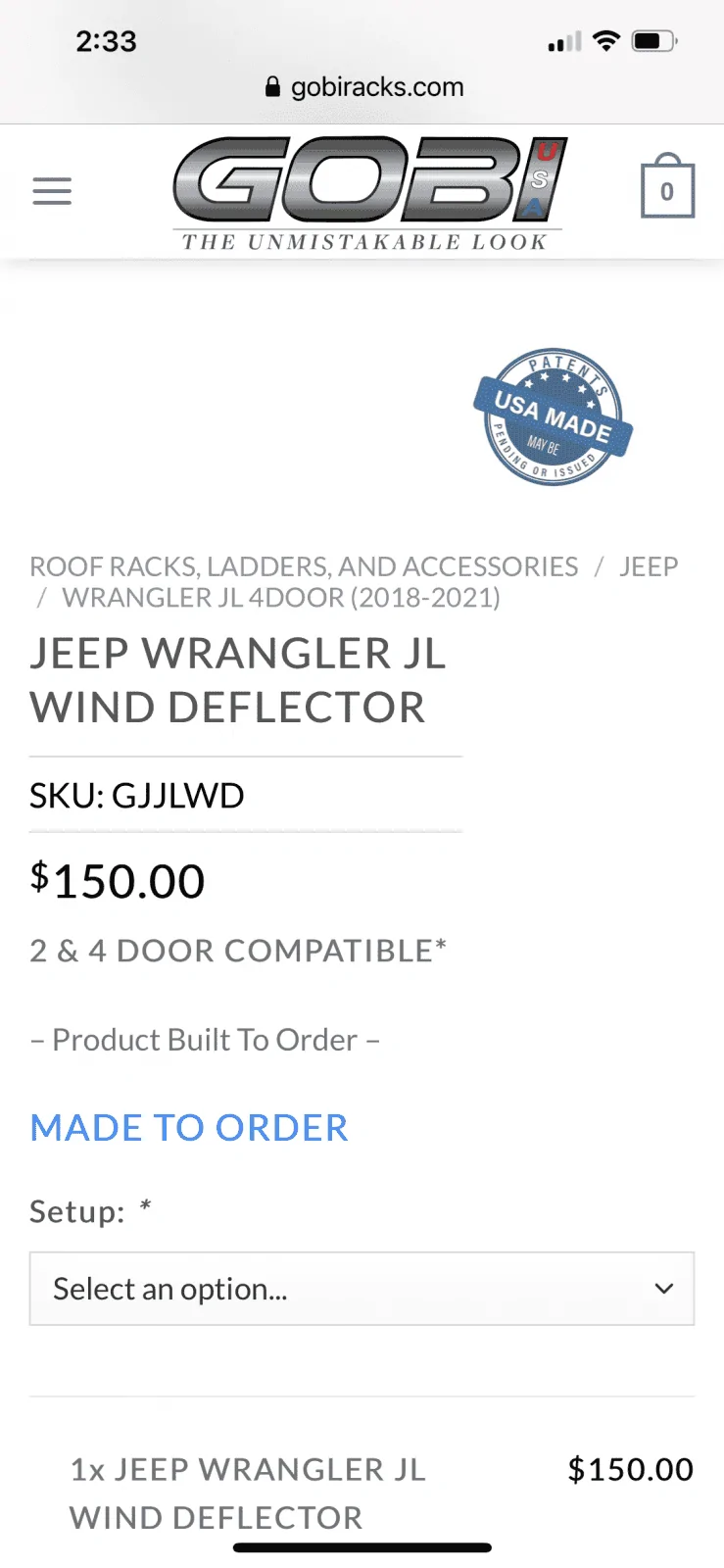

Im not sure if you found a solution, my Rubicon is on order, but I had started thinking about this very subject. I did find these from Gobi that go with their racks, but are also sold separately. Has anyone tried with success?
https://www.gobiracks.com/product/jeep-wrangler-jk-2-4-doorwind-deflector/
Thanks

Jeep Wrangler JL Wind deflector for the Sky One-Touch Roof? B9BB39E5-82E9-49E3-A4BA-376D26D3B045
