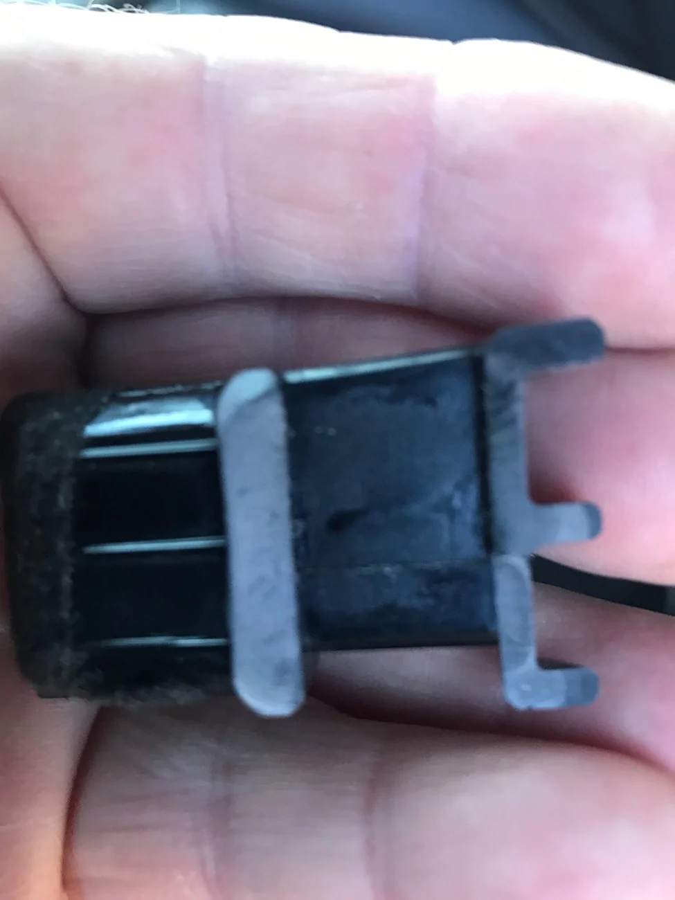

Check all the crossbars for breakage, especially the ends of the ones that run the tracks(two bar sections, one for the track, the rear one folds up) . One of mine broke for no explainable reason and wouldn’t close until the broken piece in the track was found and removed.

@2nd 392 after reading your response, there is roughly a 1/2inch of the bottom of the track rail that it runs back and forth on broken off. When whatever happened that caused my top on the driver side to run off the rail and break, to get my top to close because it was wide open, when closing it I had to use a makeshift 1/2inch placement to make sure that when it closed it didn’t run back off after I had put it back on. It did close. But since then it will only open halfway and when I try to close it, it pops back open. I have to hold the button and when I hear the clicking at the end I have to quickly release the button or it pops back open.

Then it will likely have to be removed and at least partially disassembled to weave everything back together like mine. It would be expensive if not under warranty.
