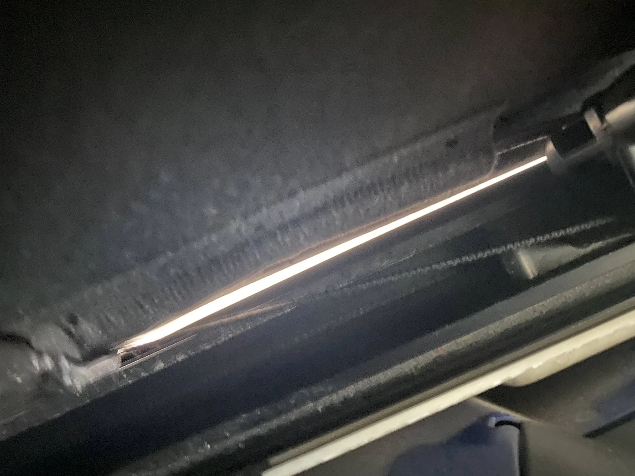

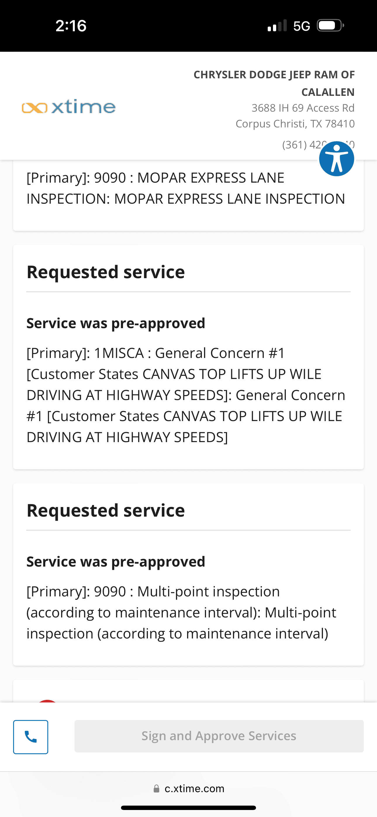

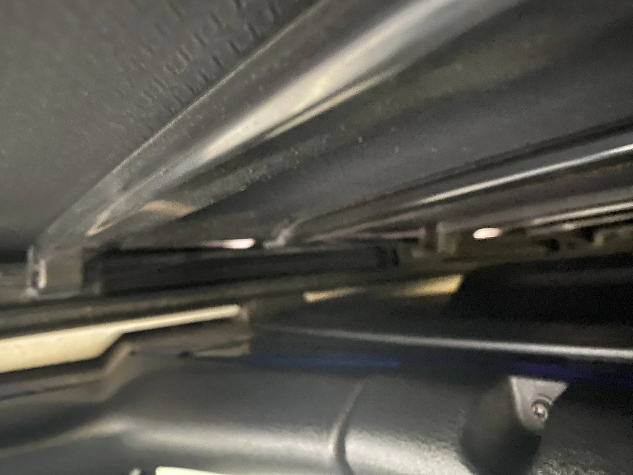

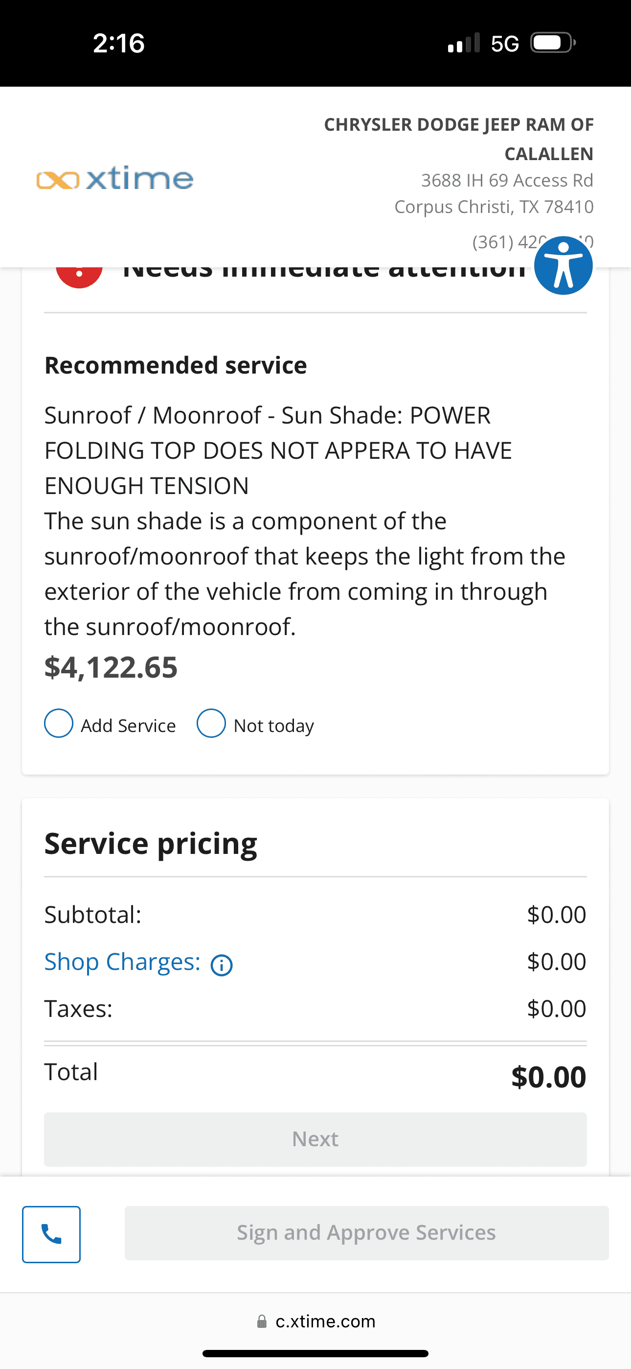

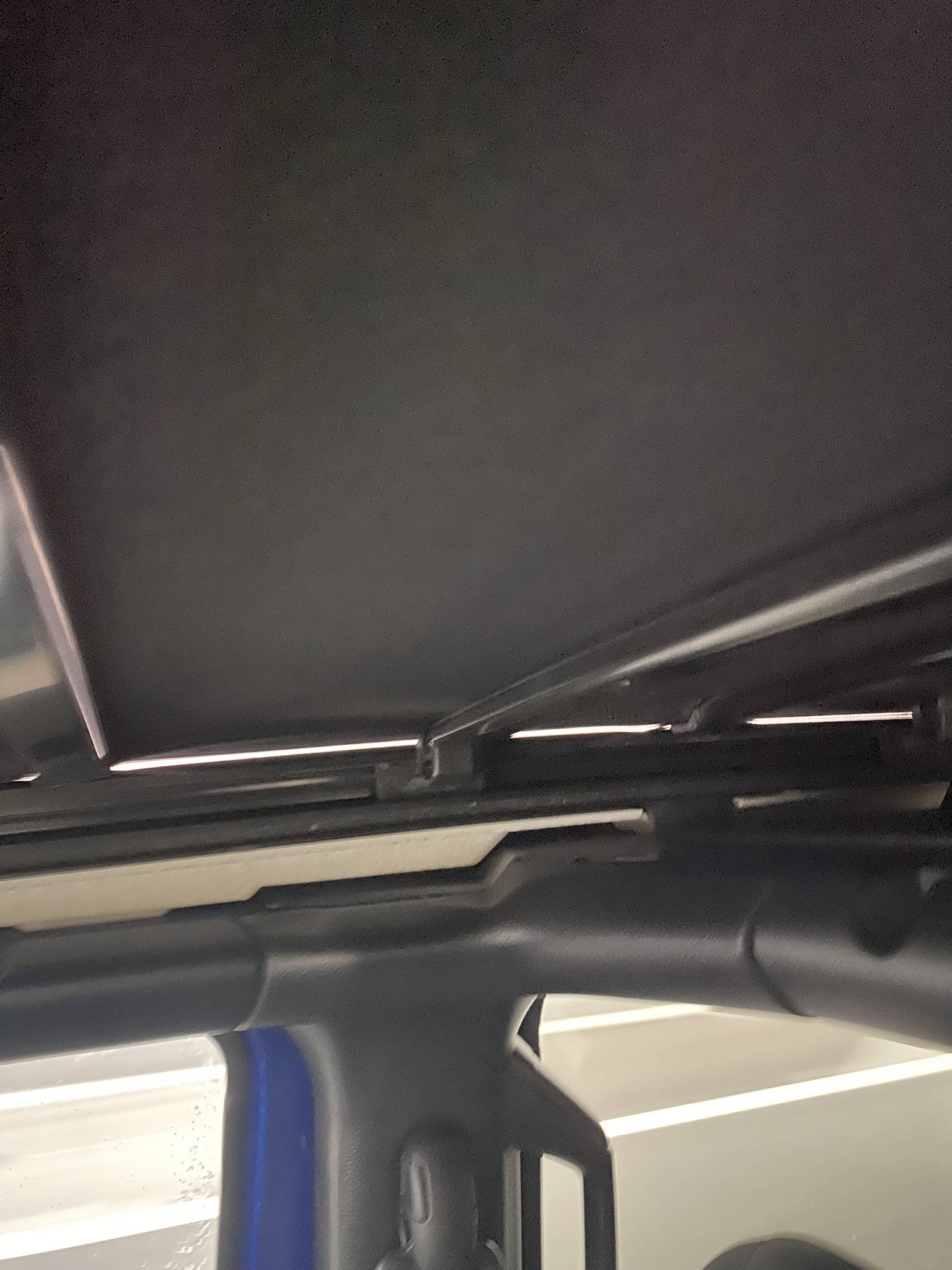

On Monday, as I was driving to work, I noticed that there was a gap between my top and the rails on my passenger side. I immediately contacted my dealership they claimed that the extended warranty I purchased with the used vehicle did not cover it after they diagnosed it. I contacted Chrysler and made a case about it they promised to get in touch with me within one to two days. The dealership is suggesting a new roof. The jeep had 46,000 miles when I bought it. The dealership also stated that there was no way of tightening anything on the SOT. Below will include picture of the problem also what the dealership recommends doing. I am wondering what else could I do to solve this problem. Any advice or suggestions would be greatly appreciated!

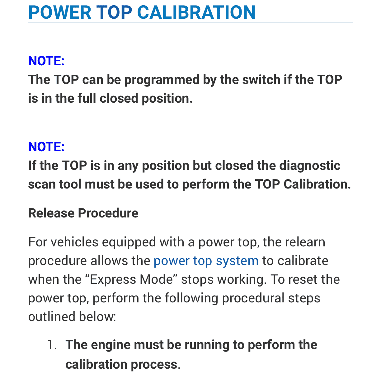

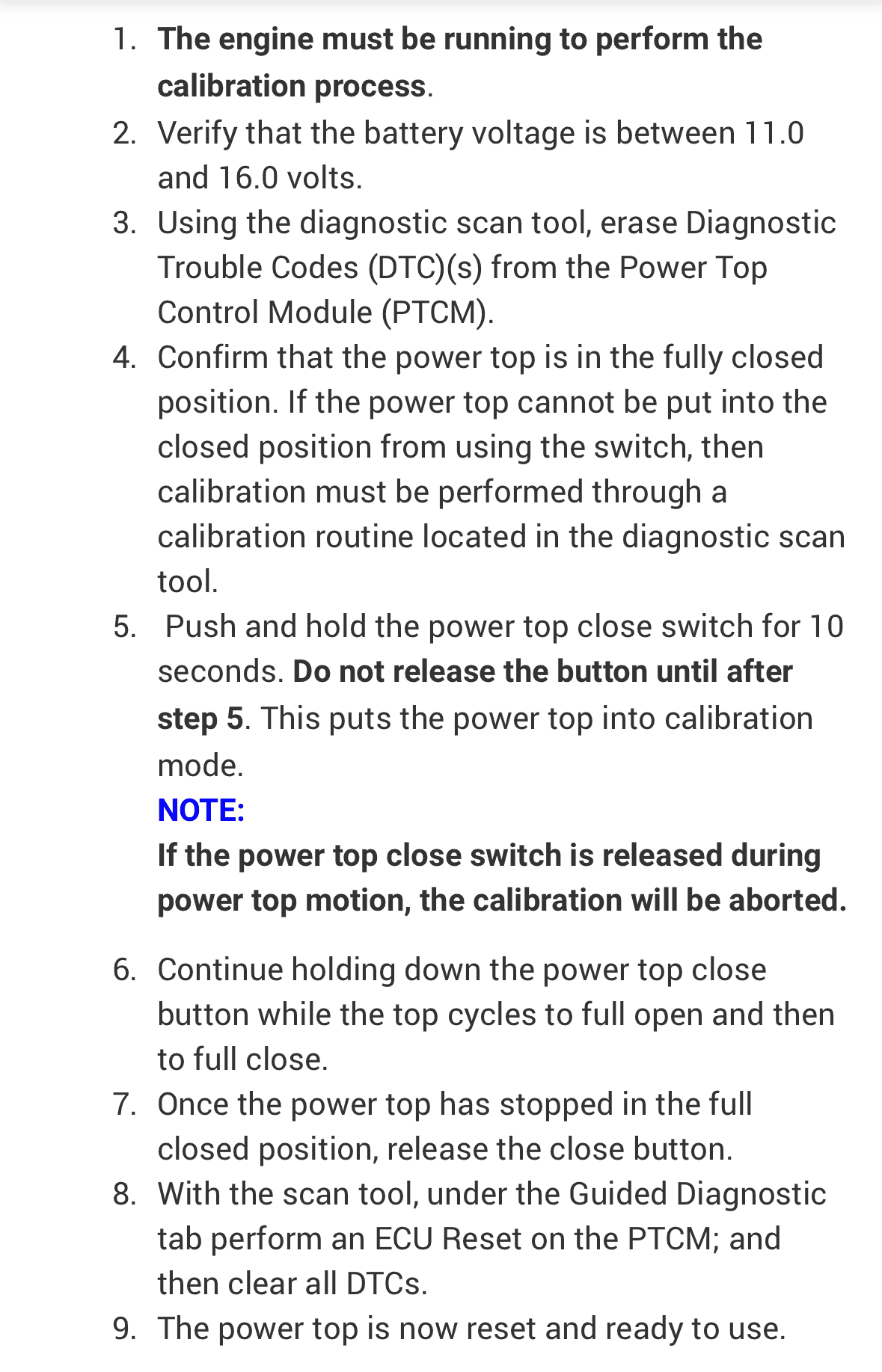

Its a known issue with some tops. There are threads on here on how to fix I think. BUT, it is factory installed so I would talk to your warranty company. Also, do a search for the threads on how to RESET your SOT. I installed my SOT myself, went from hardtop to SOT. I did the reset and it worked.

I got the 4 star extended warranty from MAP. It doesn’t cover it. They do have optional coverage but it’s an add-on fee which I didn’t get.

Easy answer.....stay away from SOT. Tried and true freedom top and panels, all day.

Can you explain how you “reset” your top?

Thank you. I’m not getting messages or errors. I can push the button and release and it opens/closes fine. I guess this is not an issue for mine (yet).
