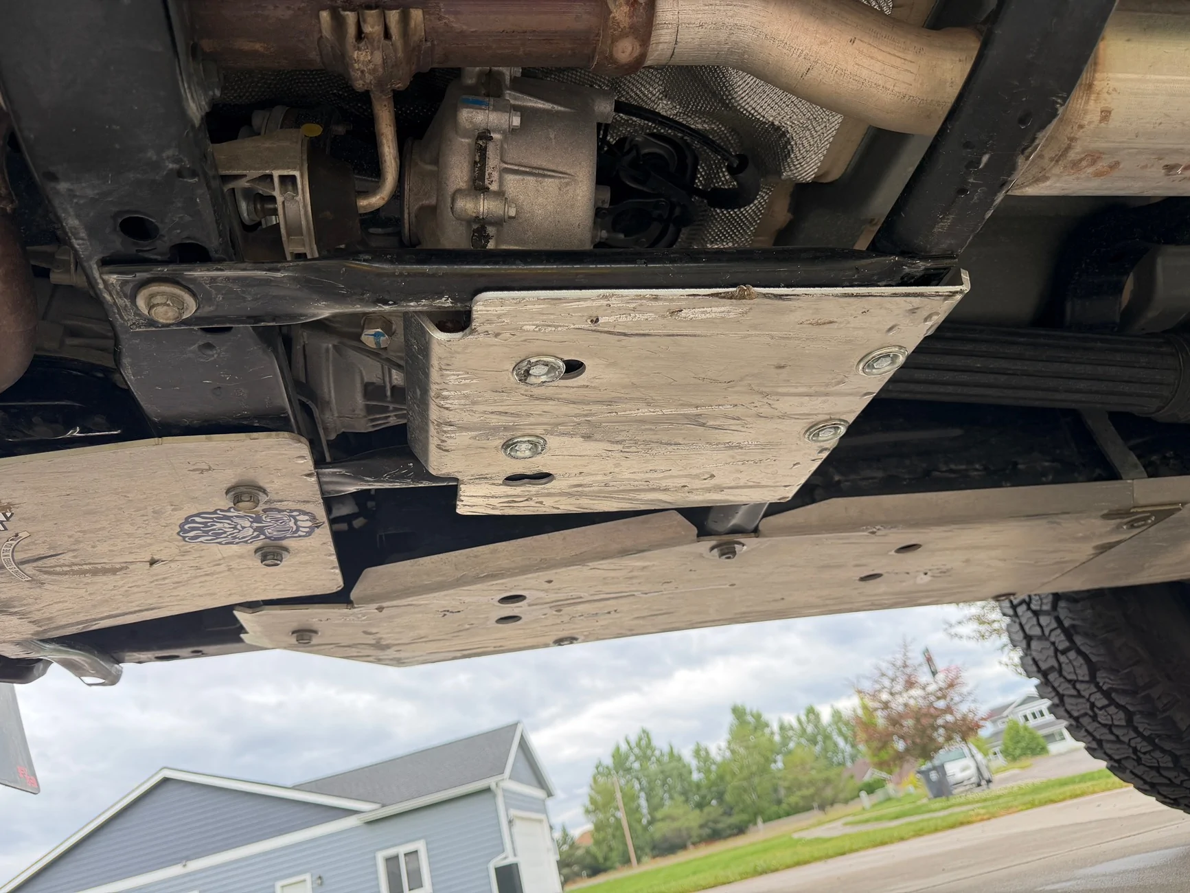

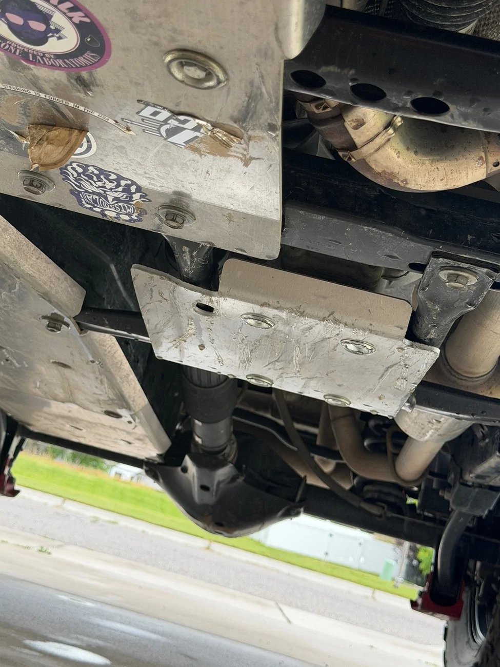

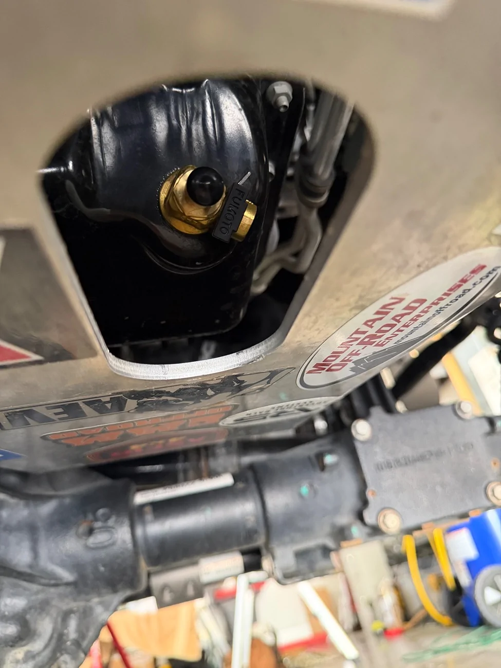

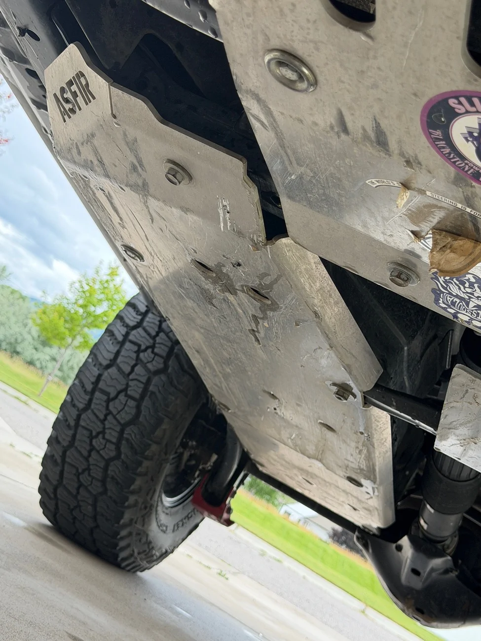

I have the ASFIR skids and for the money are hard to beat. no issues changing oil as I have a fumoto valve....I can say they make a unique sound when sliding across lava rock....I like that they are light weight and won't rust and for what I need they are great. If I were racing king of hammers or really pounding my rig I would probably look at something else but for my level of playing in the rough stuff they are well worth the money.
Jeep Wrangler JL skid plates and frame rigidity? IMG_1467
Jeep Wrangler JL skid plates and frame rigidity? IMG_1468
Jeep Wrangler JL skid plates and frame rigidity? IMG_1472
Jeep Wrangler JL skid plates and frame rigidity? IMG_1536
