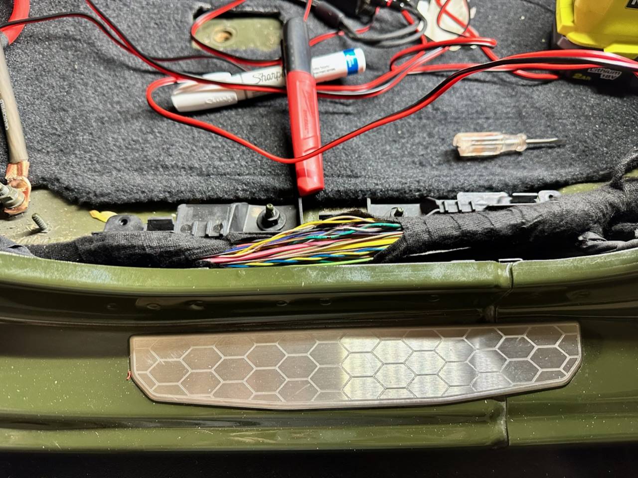

The sub wires are in a plethora of wires located in a harness by the passenger door sill (I have a four door, so the rear passenger for me). Shoot, what a mess, but here’s where I tapped in (you can see the black harness that I cut open and temporarily attached posi-taps)….
I tapped into sub 1 (+ and -) and sub 2 (+ and -). Just look for the twisted wires as they are the ones you want. Then it’s easy to color match…

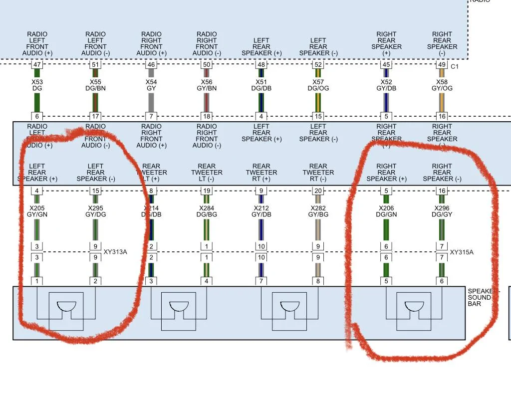

So I'm going to be attempting to install a Kicker hideaway 46HS10 system this weekend. I"m kind of confused now on what wires I should be trying to tap into however. I have the upgraded alpine system and was planning to tapping into the wires that others have called out in the apillar going up to the surround bar. I have replaced those speakers with the MBquart 6x9 kit but all other speakers and sub in the back is stock. I do plan on adding terra accoustics in front but that will be all after this sub. Instead of those wires in the pillar do I need to find the sub wire going to the back and tap into that so that they both get same single? thanks!
So I’m getting the same good bass from both the sound bar full range speakers (not the tweeters) and the sub wire. Here’s the wires you want to tap for the …

I think I’m sticking with the sub wires only because it’s easier to work on as they are directly in front of me…

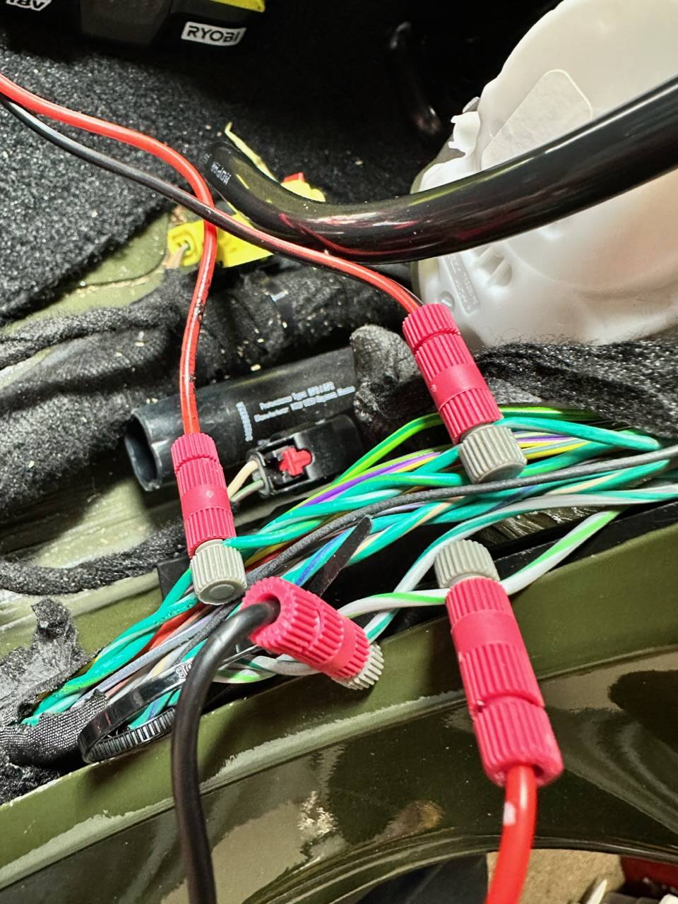

For your information: From electrical books that I’ve read they state that those cheap plastic connectors such as posi taps, t taps, scotchloks, etc should only be used for temporary connections (much like how I used them to test for the correct signal) and I would have to agree.
I also don’t like to use solder for something like this as the connection becomes brittle and can break if moved too much (if you need to get in there and do more work and move the wires around in the future).
It is always a pain to carefully use a razor to shave/pull the wire insulation back to connect wire to wire (in an operation called a “Westinghouse Split”), so I went ahead and did it how @lashlee did it(with butt connectors).

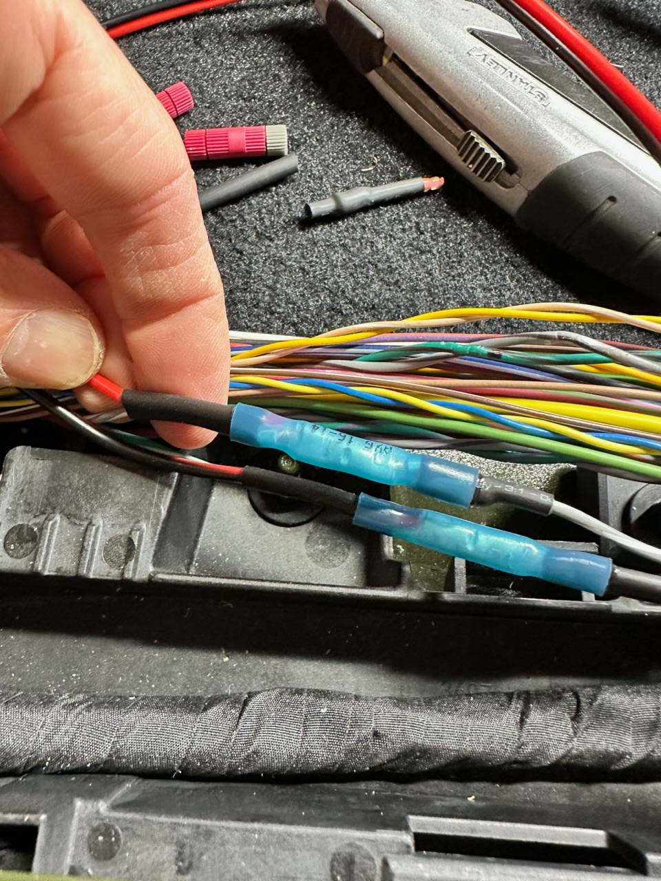

I used heat shrink connectors large enough to have two wires inside. One side has the factory wire and new wire going to the amp or LOC. the other side I cut off a piece of new wire and stripped part of it as a place holder so that both sides has the same diameter of wire going into the butt connector for a solid connection.
In the picture below you will notice I used additional heat shrink on both ends. A couple reasons: 1. To hold the small new wire I cut as a place holder on the one side, and 2. to cover up those little holes I made with the Posi Taps, and for slight stress relief. Tonight I will tightly zip tie 1” from the connector holding the wire running towards my Amp/Loc as stress relief and zip tie the other wire I used as a place holder.
Then I’ll use cloth tape for added protection and to make it look like the factory harness (as seen in my repair on the b-pillar harness in the second photo).

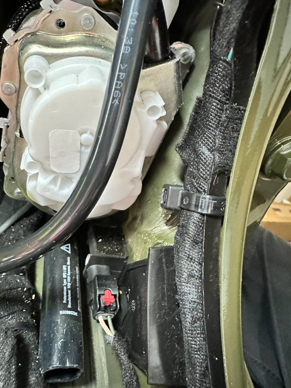

Oh, and it was much easier to do this work on the sub wire which is directly in front of you under the door sill as opposed off to the side on the b-pillar
Jeep Wrangler JL Simple Subwoofer Upgrade!? B7FC5D2D-535D-4826-9377-E7339902CE48
The part I fixed and cloth taped is the part to the right that has been zip tied to the body…

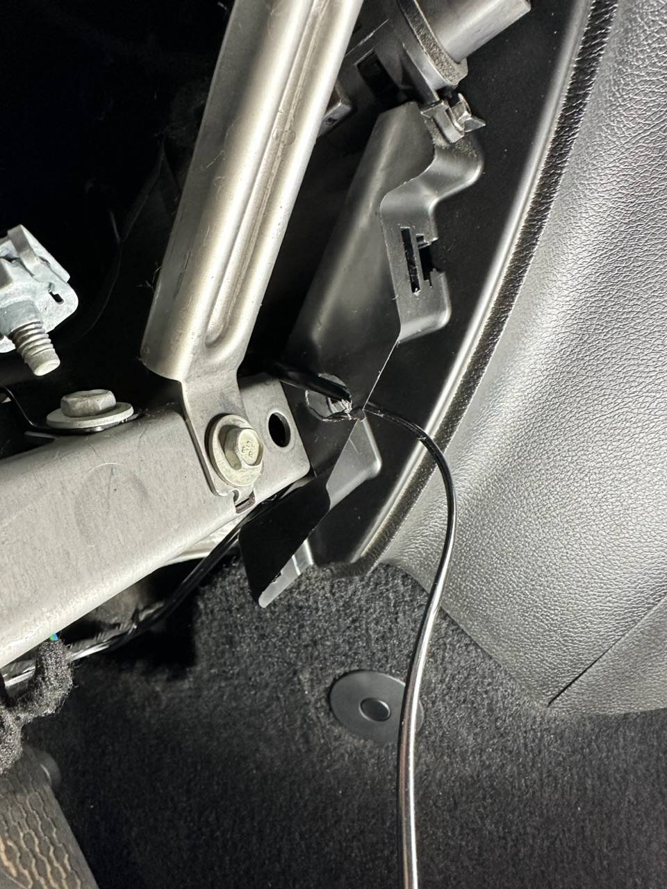

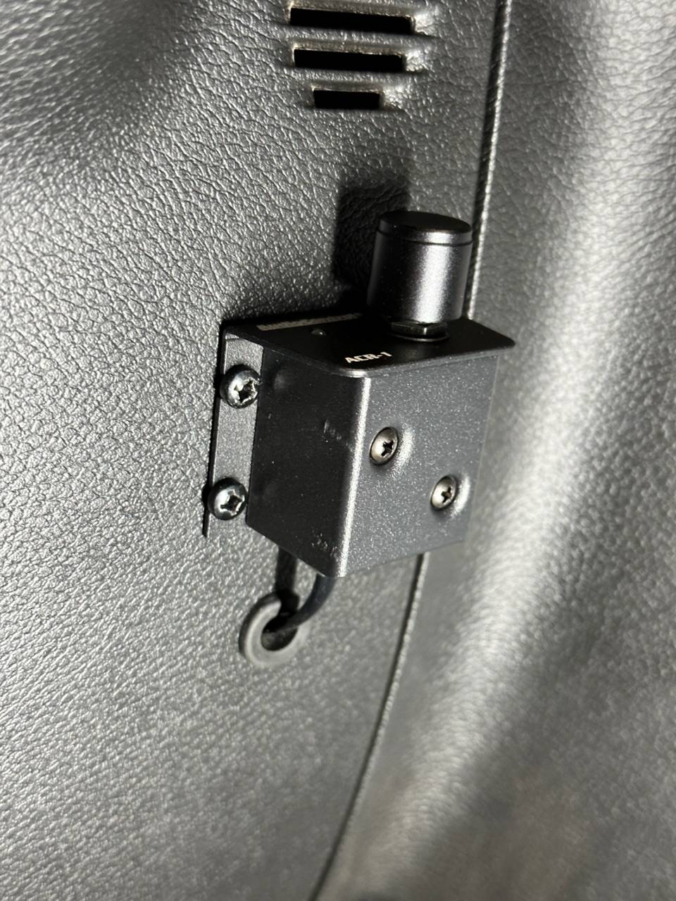

Here’s where I installed my bass knob (right in front of your right knee below the steering column). I figured where I wanted it, removed the trim (super easy to pull off), made sure nothing was behind, drilled pilot holes for the screws, drilled large hole and added grommet for wire, etc…
Jeep Wrangler JL Simple Subwoofer Upgrade!? 8F2F77BC-2FC5-42C0-879C-330B4E96335F
If you use this location, be careful to align with the stuff happening behind. I had to drill that large hole to get my wire in the correct opening…
Jeep Wrangler JL Simple Subwoofer Upgrade!? CF9A9F86-B3AE-41E6-84E3-BF0CD4C89C6B
