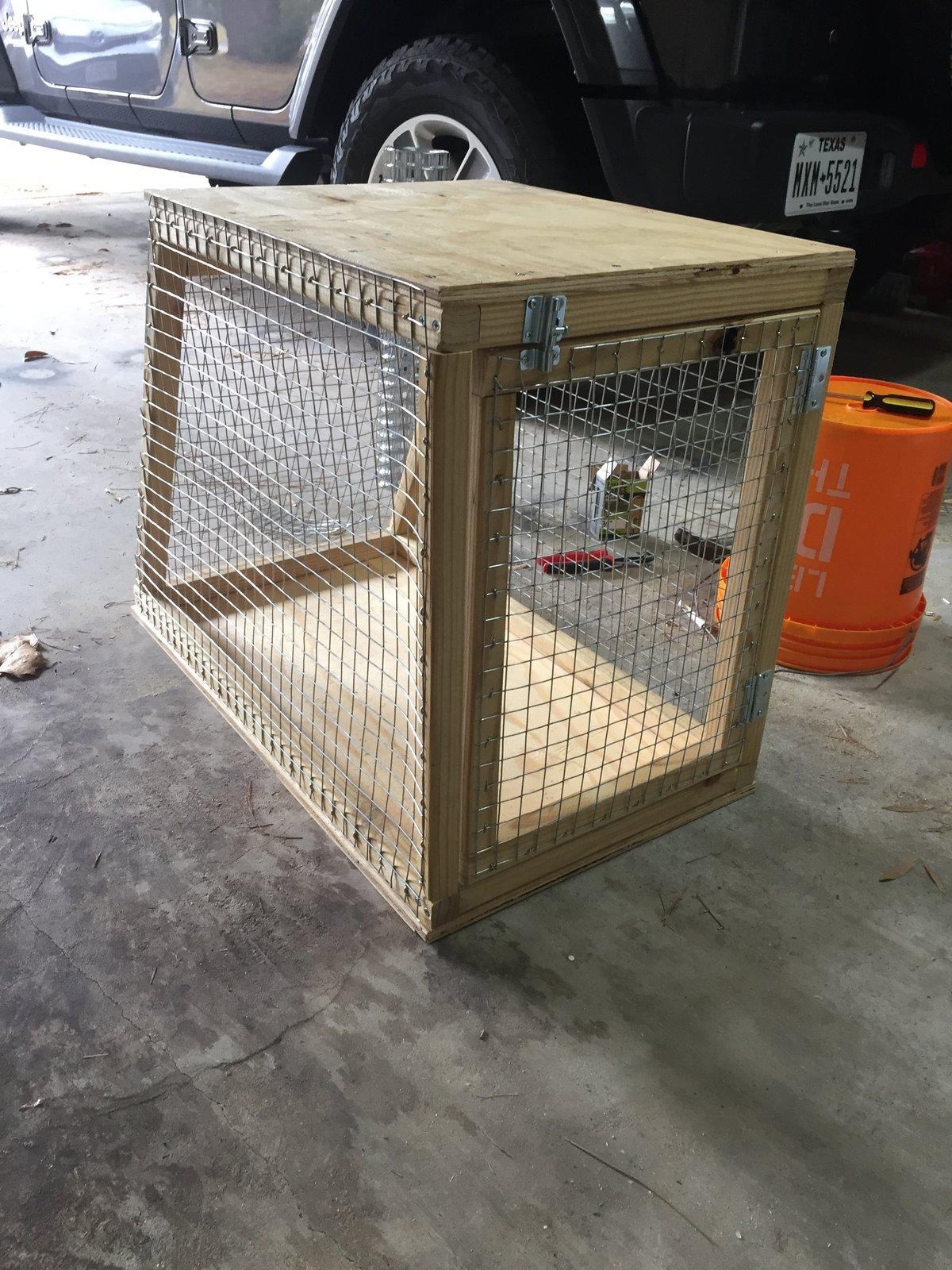

Before I bought my Jeep, I measured the back to verify that my dog crates would fit. Turns out I took bad measurements. My wife and I looked online for reasonably priced crates that would fit to no avail. This is why I love Wranglers. There is a unique solution to my unique problem. I have built one of two crates sized to use all the floor space and slope with the rear seat. This is still a work in progress, but I am uber stoked about it so far.

Looks like a good solution. Did you use normal pine or pressure-treated wood? It looks like you used deck railing but based on the color it is hard to tell. If PT, I would be concerned about the dogs licking or chewing on the wood inside the crate. Even with modern PT there are risks for pets ingesting the chemicals.

I stayed away from pressure treated for those reasons. I found these 42” pieces at Lowes for considerably cheaper than other 2x2 stuff.
Wood is not my medium of choice, so I am not well versed with it. I just wondered around Lowes for a while until I found material that looked like it would suit my needs.
