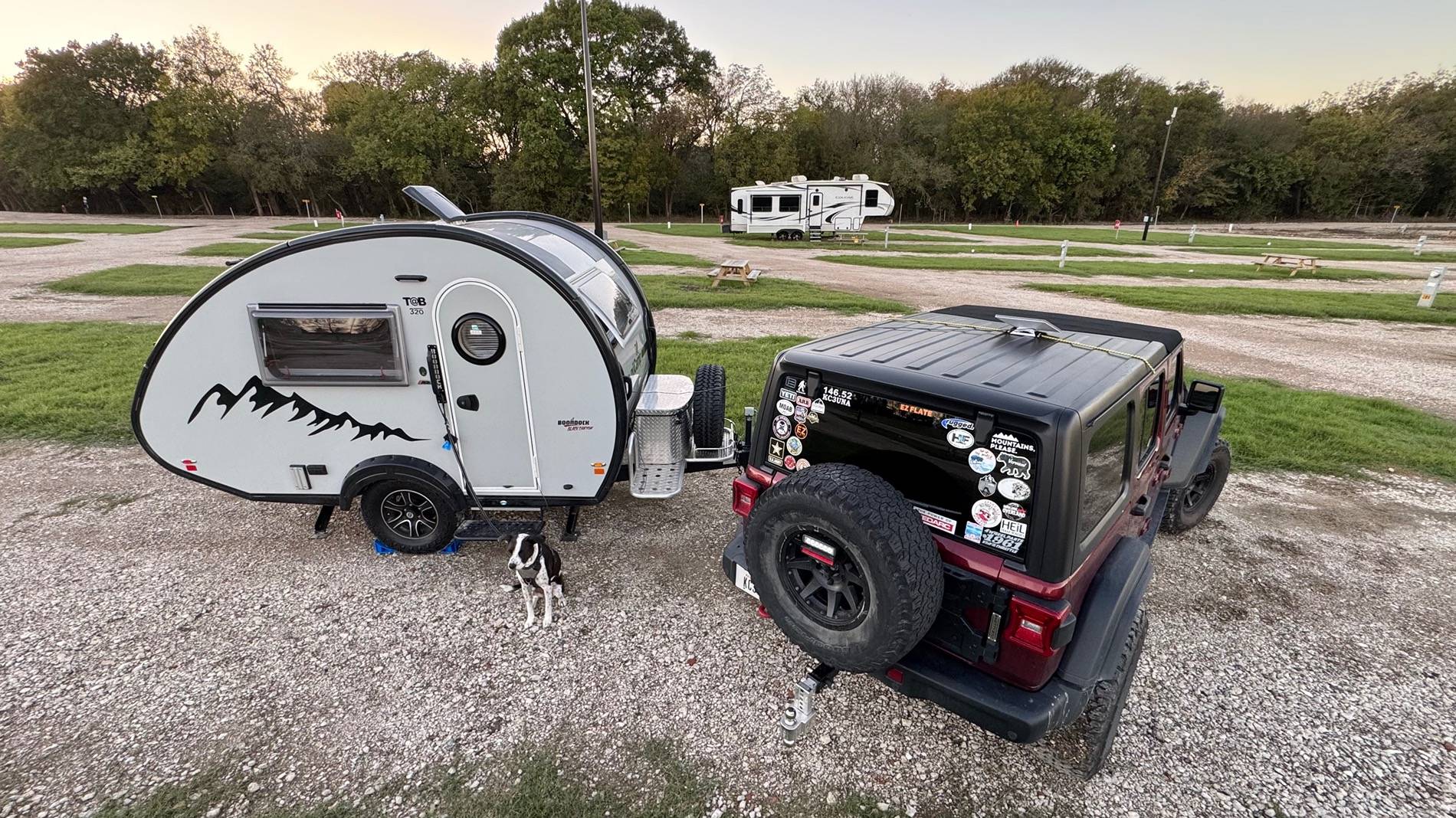

I am pulling a camping trailer. Should I have ParkSense turned off?

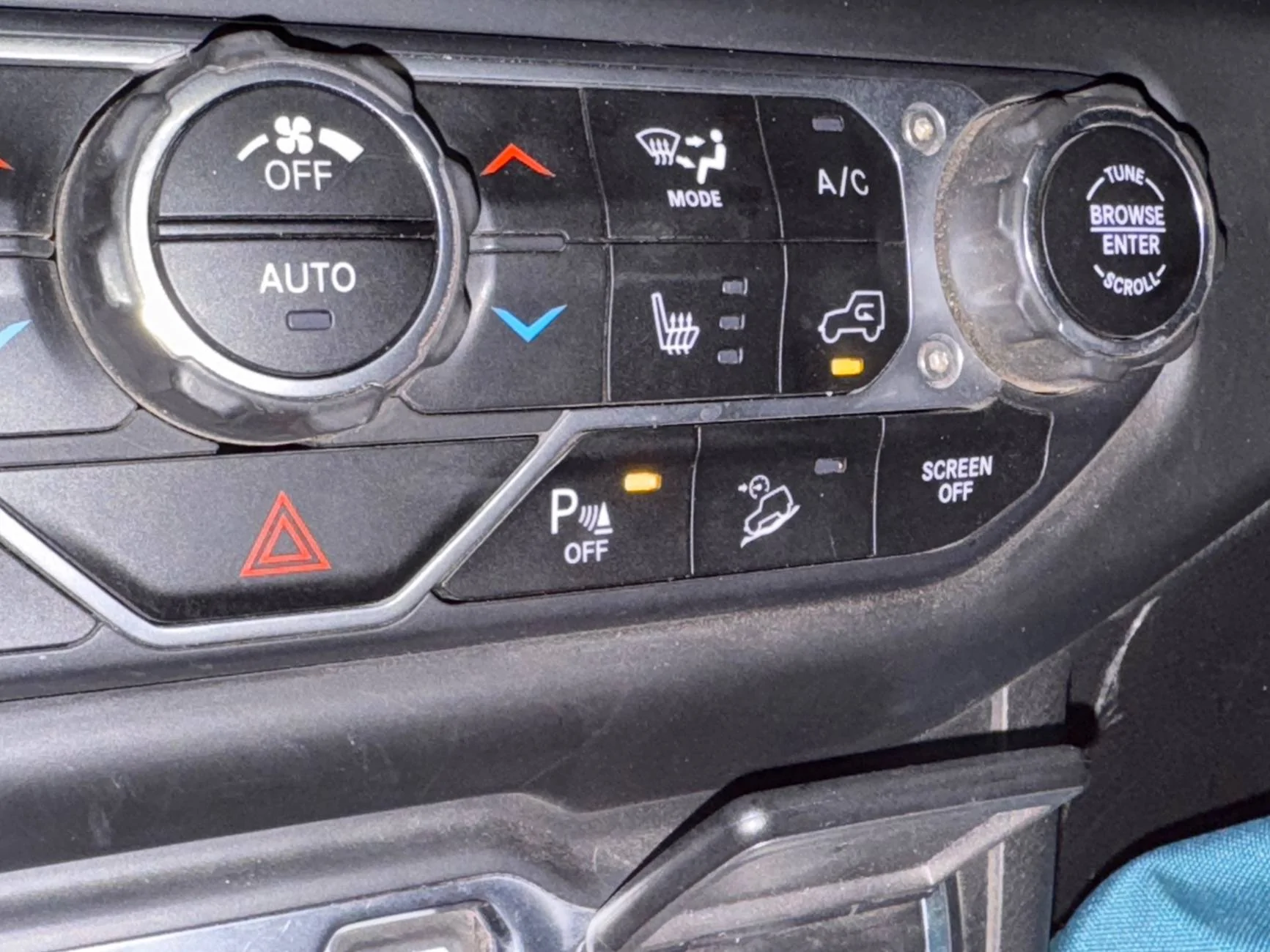

Thanks all, thought I was going crazy. My understanding was if a trailer is attached, the ParkSense feature is disabled.
Nope, it stays on. I’ve been turning it off when I attach my camping trailer. Not sure if that has any affect on other safety features.

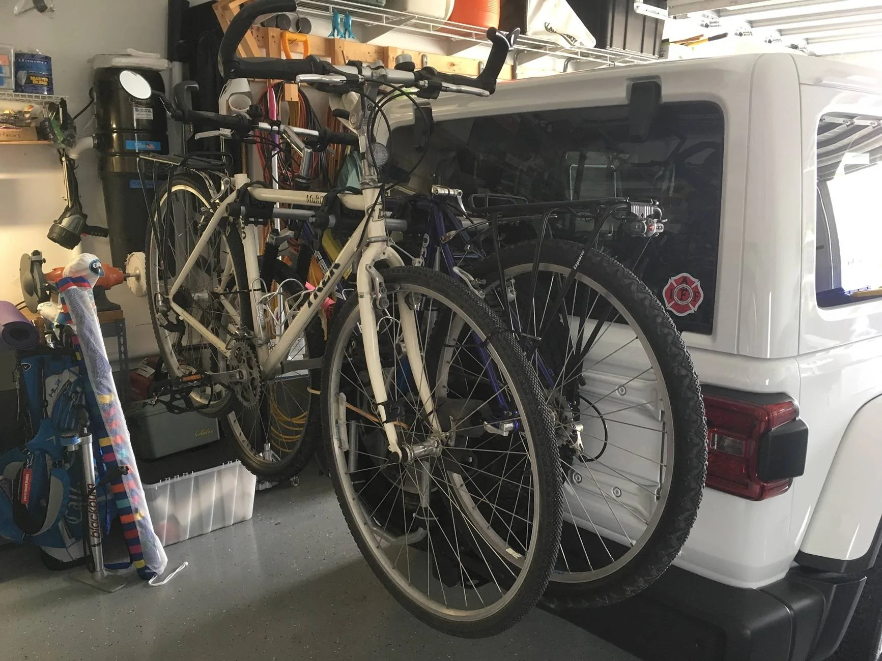

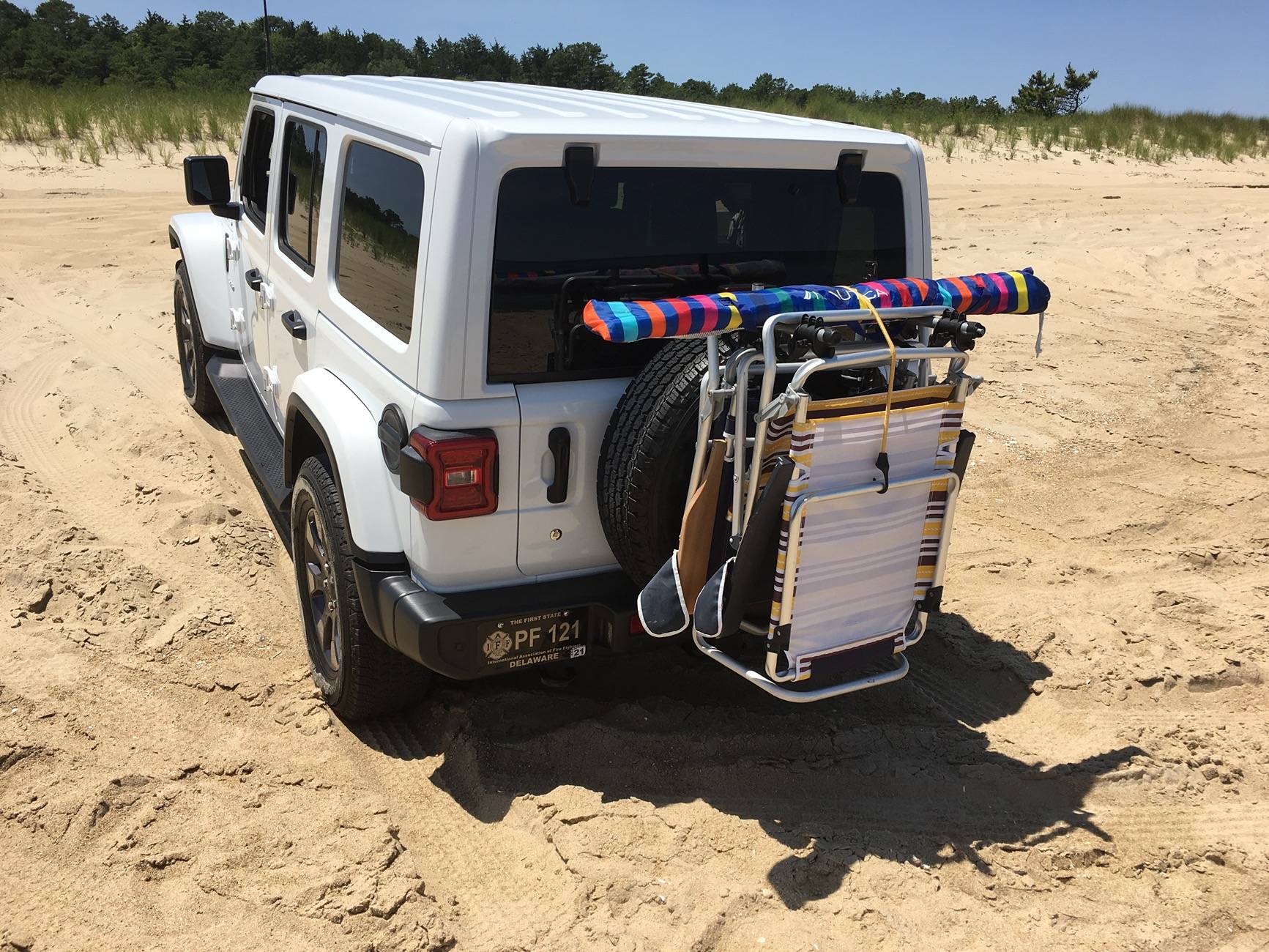

I have to disable ParkSense when carrying. Bike or beach chairs as well.
The sensors ‘see’ the obstruction as soon as you select reverse
