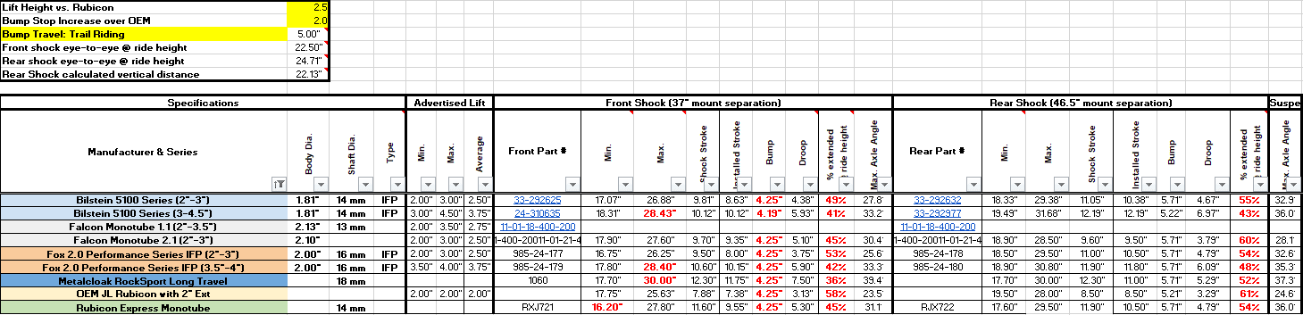

Assuming you have a 2.5" RC lift with 2" bump stop extensions. Here are some options based on AnnDee4444 's spreadsheet. I limited it to mostly monotubes, assuming you aren't looking to pony up for remote reservoirs. I have 2" extended Rubicon shocks listed so you can see how they compare. All of these are in the recommended range of 30-60% compressed at ride height, and give you the full available uptravel with the current setup.
We have the Bilstein 5100 3-4.5"s on ours and they are great and are available at a solid price point of ~$90 a corner. As @word302 mentions, the Fox 2.0s are an option that everyone seems to like as well, not sure on the Accutune cost, but they run around $160/corner.
