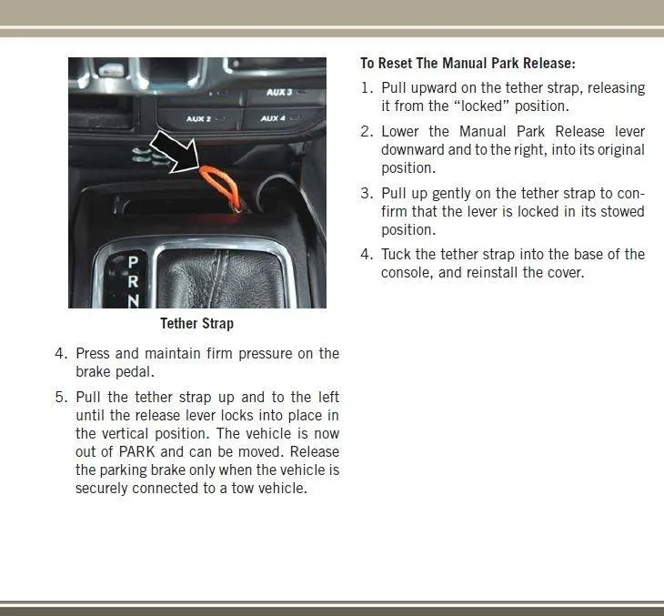

See if releasing will remedy things..
Listen carefully and stop pulling on the orange strap just as soon as you hear a slight audible click.
Pulling too far will release and then undo release..

No luck after resetting the manual park release.
