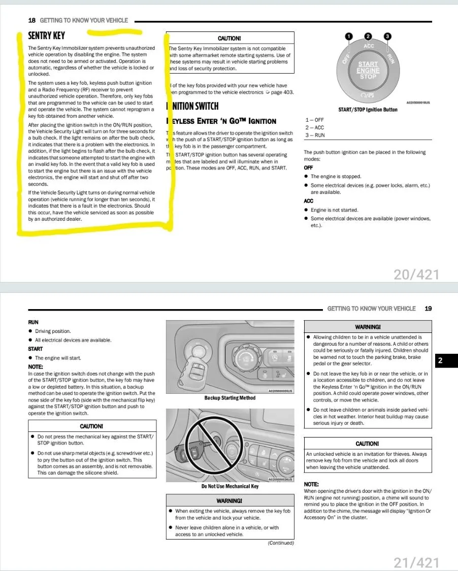

I don't remember the wordage, but I believe that is covered in the manual. I know this isn't much help, but might point you to an answer.
Found it:
Jeep Wrangler JL Security light stays on while driving sometimes Screenshot_20230914_110045_Samsung Notes

Yeah, that's odd. I'm not worrying about it too much for now, as it stops when I turn it off and then on again. I was just wondering if I was doing something wrong. When I open the car door while it's running like that, the car is beeping at me until I start the engine. This is with a key fob going and unlocking through whatever the sensing thing it does when I touch the handle. Maybe if I hit "unlock" on the fob or something it will stop doing that. I'll do some experimenting.
