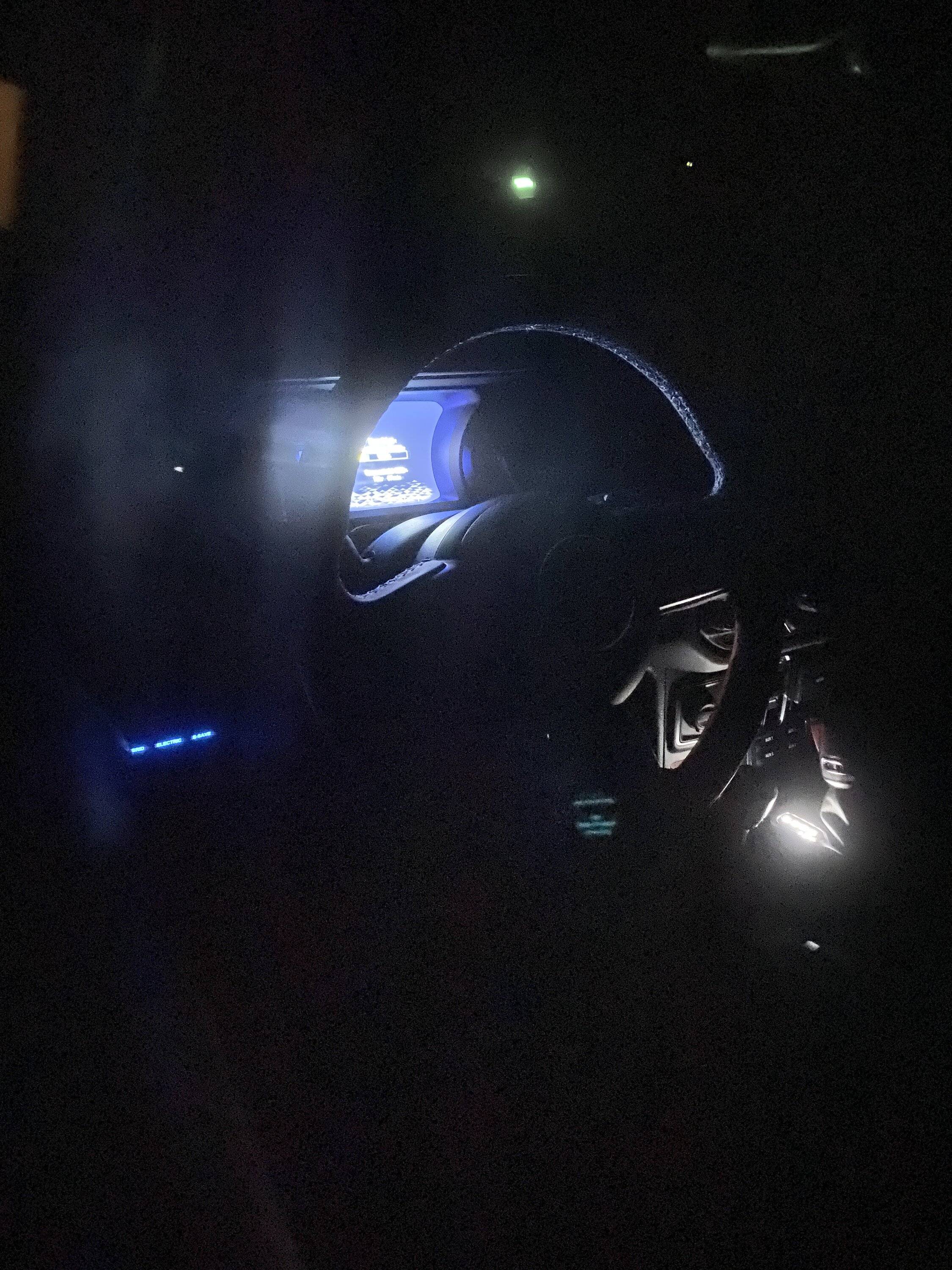

On my 2024 4XE, the Cluster, Shifter & 4XE Mode Switches are only staying On when I’m charging.
When I disconnect the charging cable, they all go off after a few minutes.
They also turn off once the battery is fully charged.
I’m charging on 110 Volts…. I don’t like to have then staying on during 11 hours each day for nothing !
What about you guys ? Any solutions ?

My ‘22 4Xe Rubi shuts off these lights after I shut the doors in just a few minutes. If I open the door, they come on, but they go back off after I shut the door.
I know that doesn’t give you an answer, but it’s a data point. Mine doesn’t act that way. It would bother me, too, if mine stayed on.

That happened to me once when I was sitting in the 4xe while it was plugged in charging Level 2, not sure why, I don't think I did anything.
I opened the door and closed it, nothing, think I cycled the start/stop, and it went off.
I've sat in it a few of times when it was charging and it didn't do that.
Try unlocking and locking it, not sure.

I tried it and they remained On… Thanks for the idea… it was worth the try !

How close is the key fob? I wonder if it is detecting it. Mine will come on when I touch the handle with the fob in my pocket. If not, and its far enough away, the lights come on when I open the door and then go off after a few minutes once I close it. In order to check the state of charge, if I don't have the fob in my pocket, I have to open the door so it will wake up.
Doesn't seem right for it to stay on all the time though.

I would be greatly appreciated if someone (or more) with a 2024 4XE, could confirm if their Cluster, Shifter & 4XE Mode Switches are staying On while charging.

I have a ‘24 Rubicon X 4xe and this is happening to me as well. It bothers me too.

2024 Rubicon 4xe - mine does it as well...i actually like it - i can see from my living room window at night - looks ok to me

I have a 2024 Rubicon 4XE just received a few weeks ago and mine does not light up when charging. I wonder if it has to do with how close your key fob is? My key is kept pretty far away from the Jeep. I will have to go test it closer.

What position do you have the headlight switch set to?
Maybe you need to play with that?
My keys are in a faraday box, they should not reach my Jeep.

It's in the Auto position
