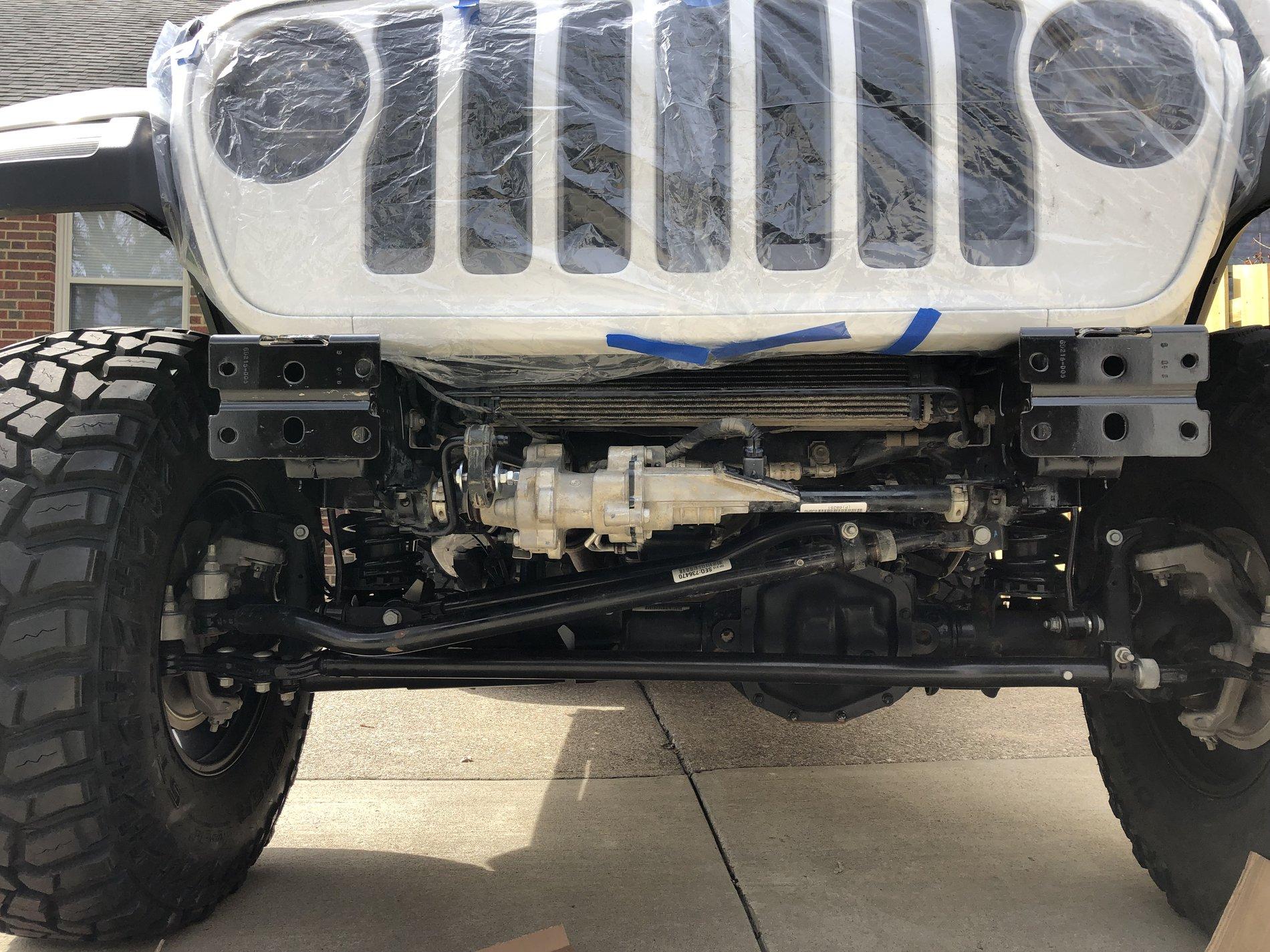

After much cursing, bleeding, cutting, grinding, and filing I finally got this freakin thing installed. What a pain the the ass this was. Much of it could of been avoided though had better instructions been provided, Despite that, I've got to say the Genright has great customer service. I started the install last friday and had some questions. I called Genright and caught someone just before they closed up shop for the weekend. The guy I spoke with said he would get a tech to call me back. 20 minutes later Tony Pellegrino, the owner, called me from Moab no less and answered all my questions. I even called him back the next day with more questions. He was more than gracious to take my call, probably while wheeling. Hats off to them for going out of their way to help a noob out. The bumper is awesome. I'm very pleased with it.
First step was flipping the sway bar motor up for additional clearance. You can also see I've cut off the crash bars as well.

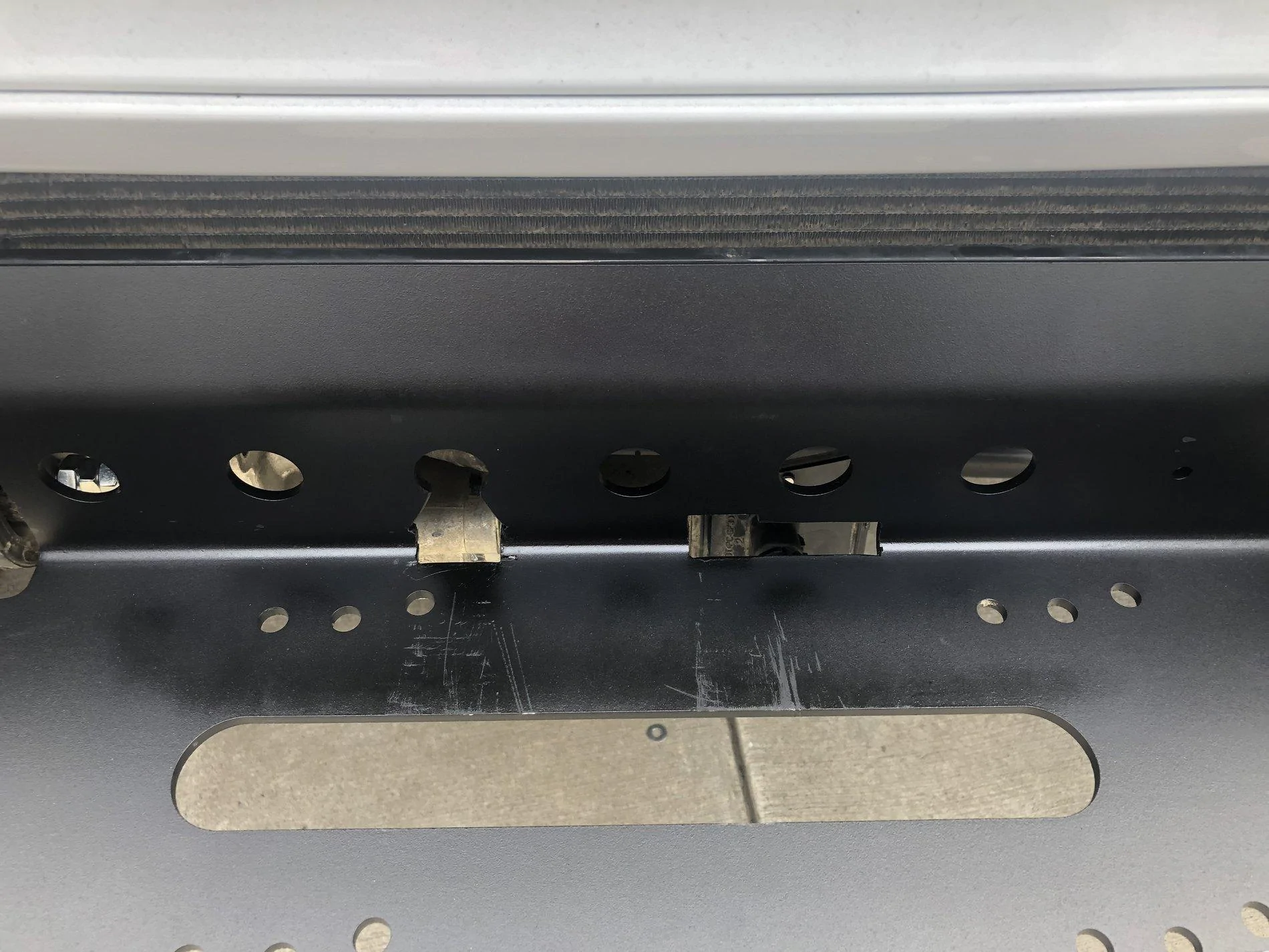

For this particular bumper, they recommend deleting the stock sway bar and running a Currie Anti-Rock. I didn't want to go this route. I like my E Disco so I notched the winch tray to accommodate the motor while flipped. I probably could have got away with taking off less material but it's hard to measure because you have to drop the motor back down to get the winch tray in between the frame rails then flip the motor. Anyways, here is the tray after notching.
Jeep Wrangler JL Scout Trooper 2 Door Build IMG_2764
And here is the finished product.

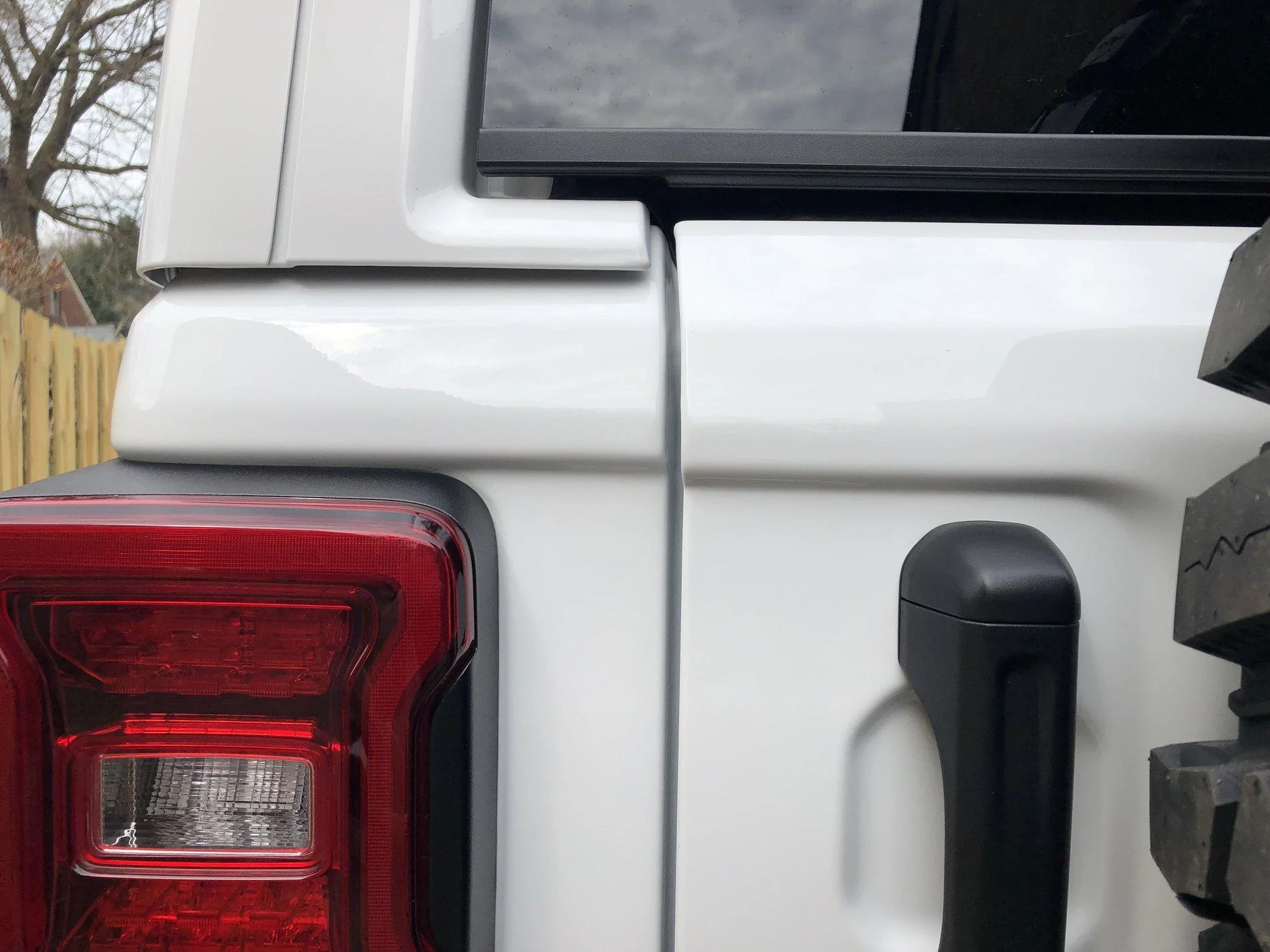

Let me just say that I am extremely disappointed in this solution. I was holding out for the Teraflex tire carrier and was one of the first to purchase it when it was available. All the info that was released was can handle up to a 39" tire. Ok, cool. I'm in. Then they day after they release it they altered their recommendations to needing some sort of reinforcement kit above a 35. Wanting to make it work, I then purchased the Mopar bracket. Big mistake. First, I can't believe how overpriced that thing is. I'm not sure what it does but it's not much. My wheel/tire combo weighs in at 112 lbs. With the extra weight of the carrier and bracket, that's about 50 lbs over stock. I'm calling BS on the fact that this tailgate is rated for 85 lbs additional weight. The hinges are definitely the weak point. After numerous adjustments without what I would consider satisfactory results, I just don't think this is going to work. The tailgate sags about 1/4" and rattles over bumps. I just don't feel confident having the tailgate open and especially for any length of time. So, do I wait it out for Teraflex to get their shit together and release a hinge reinforcement? That's probably a year out considering how long it took them to release the carrier. Again. supper disappointed and pissed.
I adjusted the tailgate up to try and compensate for the increased weight. As you can see, it's sagging about 1/4". Body line was 1/8" above without spare. Now it's about 1/8" below.
If you're thinking about this combo I would advise against it for 37's.
The 85 # tailgate weight includes the spare.

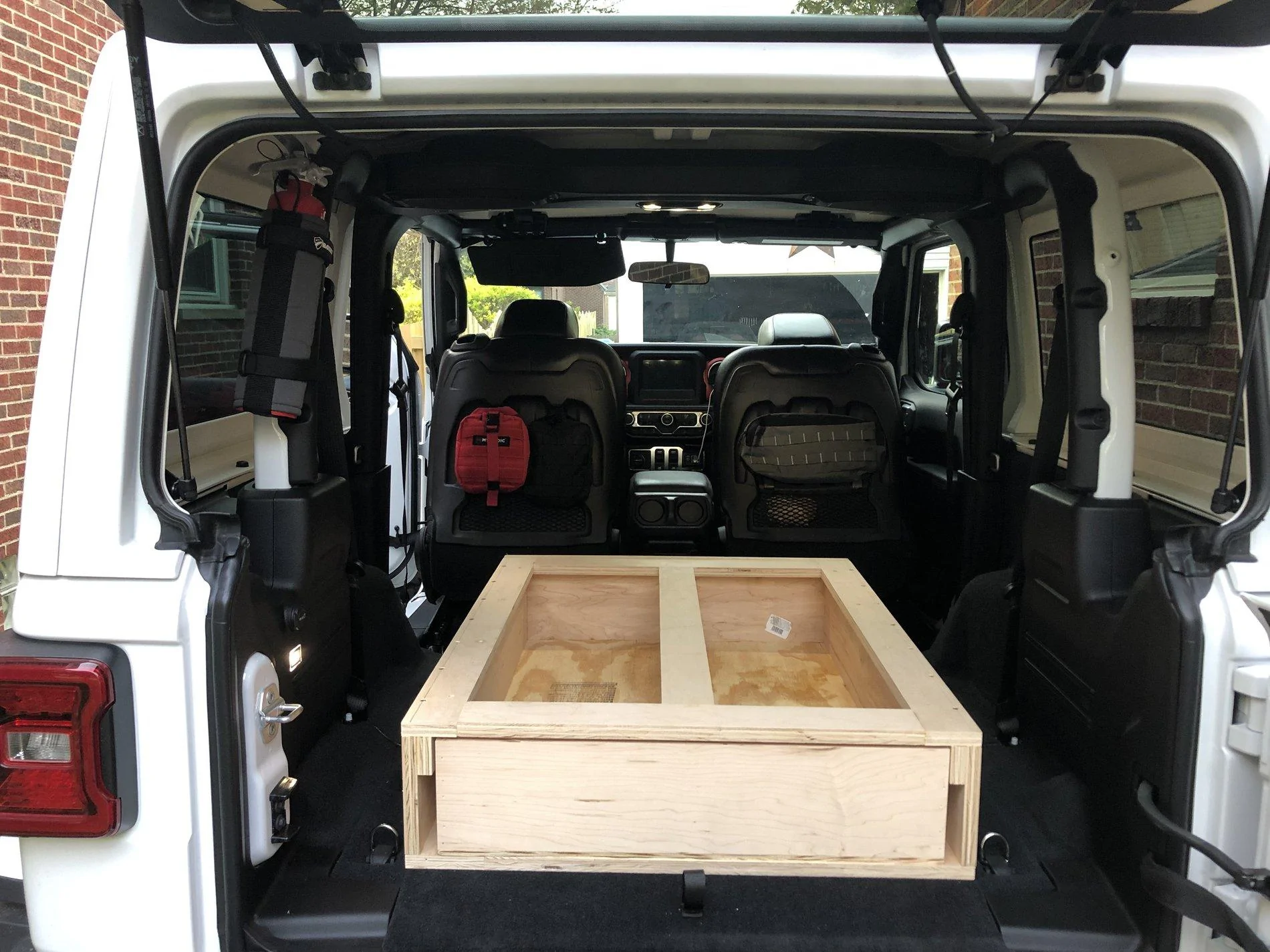

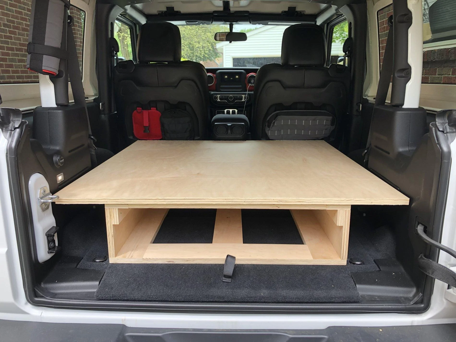

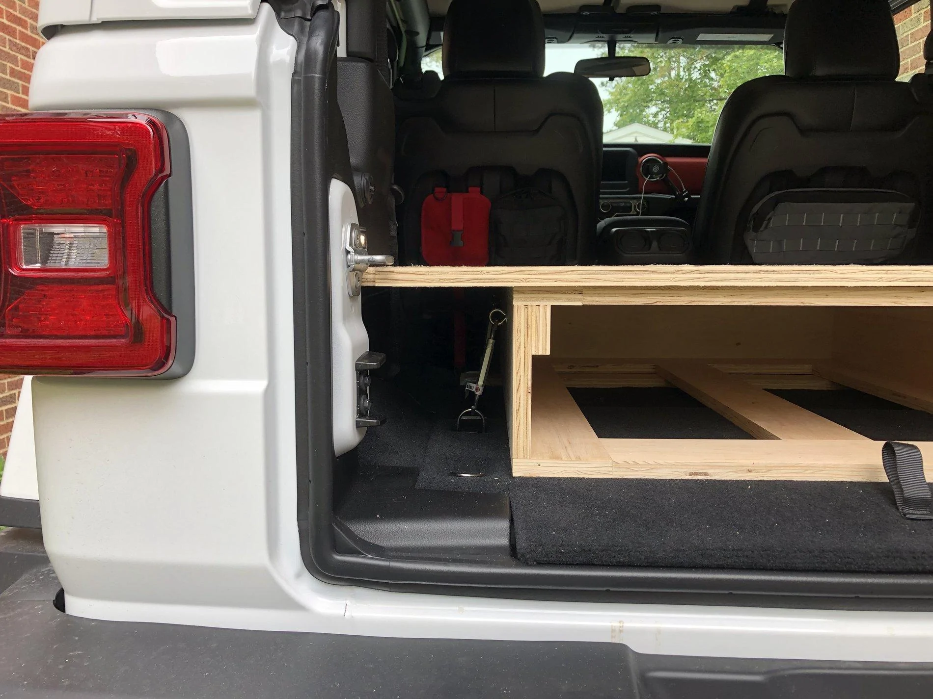

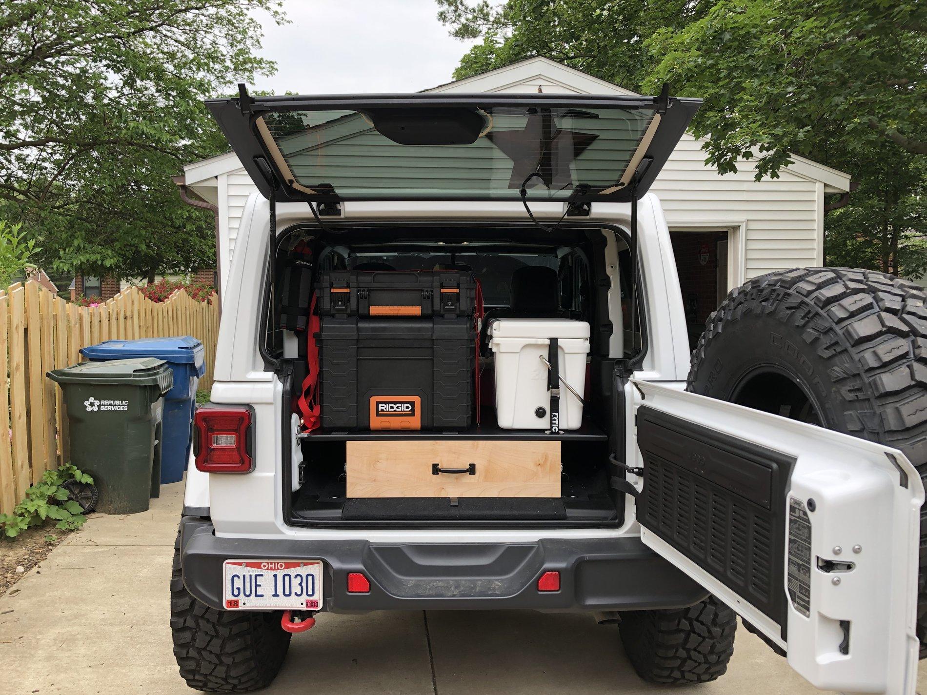

Phase 3 : DIY Overland Storage System

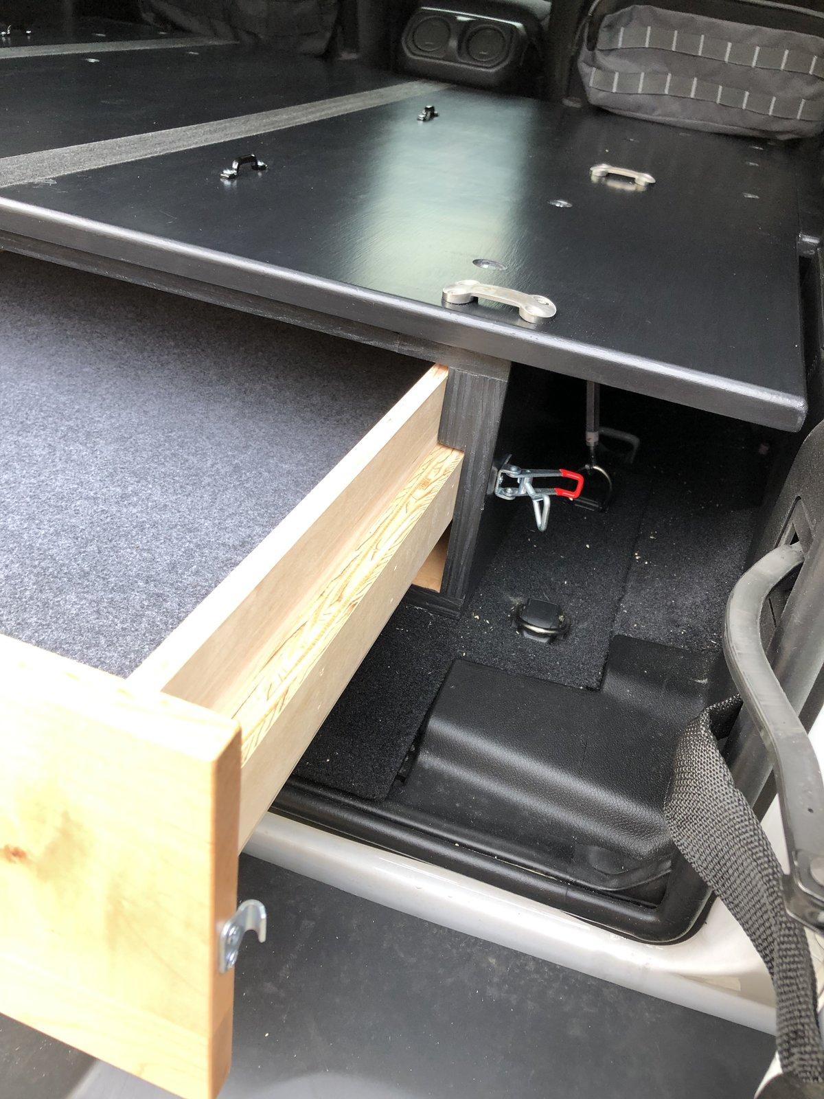

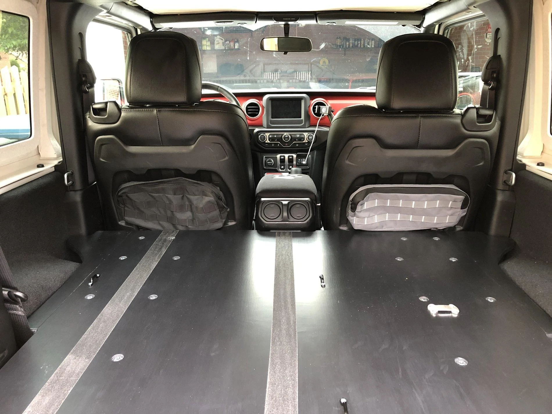

After my first wheeling trip, I knew I was going to need something better than just ratchet strapping stuff down to the floor with the rear seats removed. Especially for camping gear. I went back and forth with the design. I was originally going to get really fancy with slide out tables and the like, but in the end I decided on a simple design. The back seat still needs to go in often as I cart my kids around to school and such. So, the design needed to be somewhat easily removable when the time comes to pull it out and put the rear seat back in. It's coming along. I'll probably have it completed this weekend... weather permitting. :fingerscrossed:
Jeep Wrangler JL Scout Trooper 2 Door Build IMG_2821
Jeep Wrangler JL Scout Trooper 2 Door Build IMG_2822
Jeep Wrangler JL Scout Trooper 2 Door Build IMG_2825
Jeep Wrangler JL Scout Trooper 2 Door Build IMG_2826

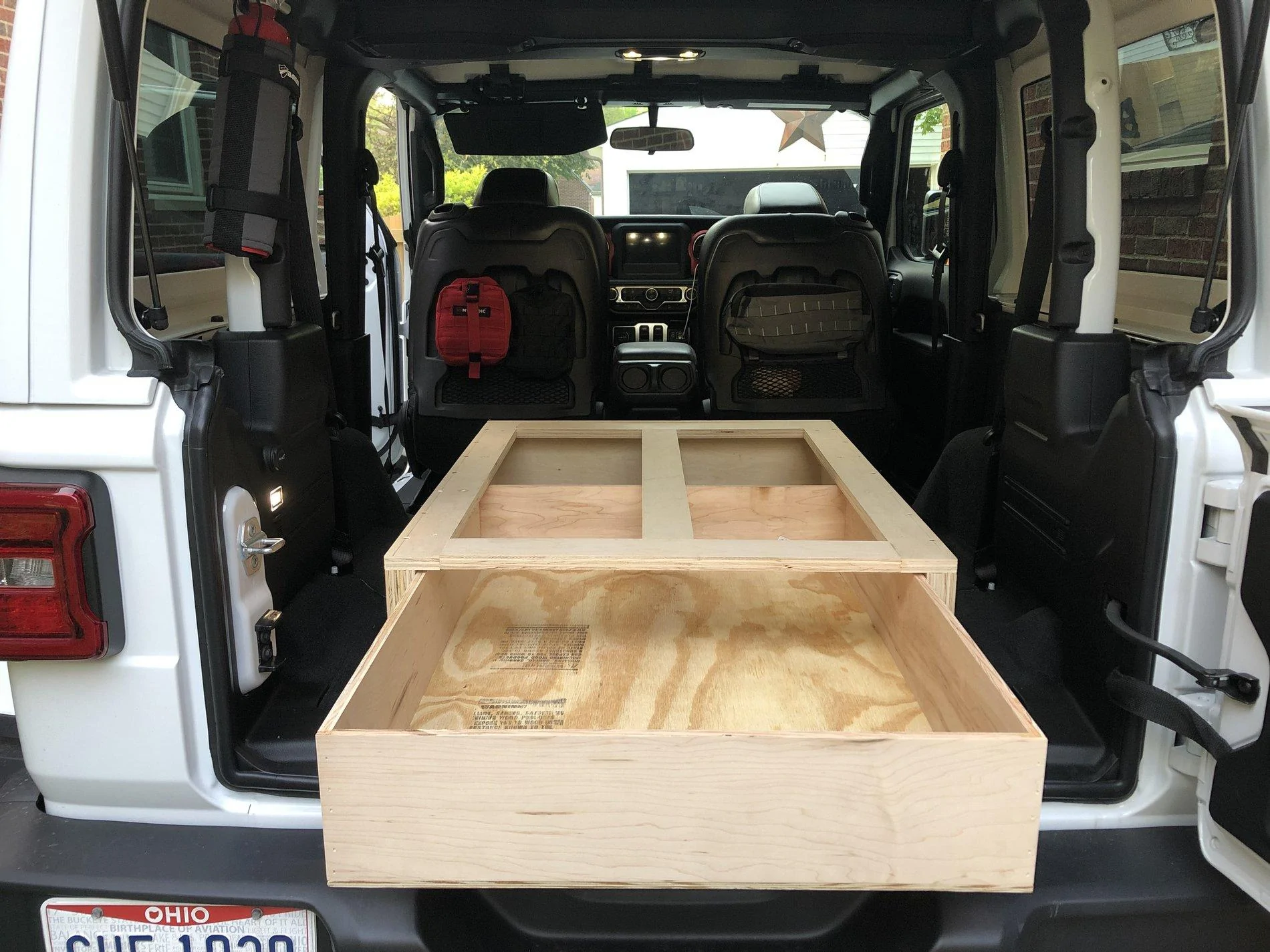

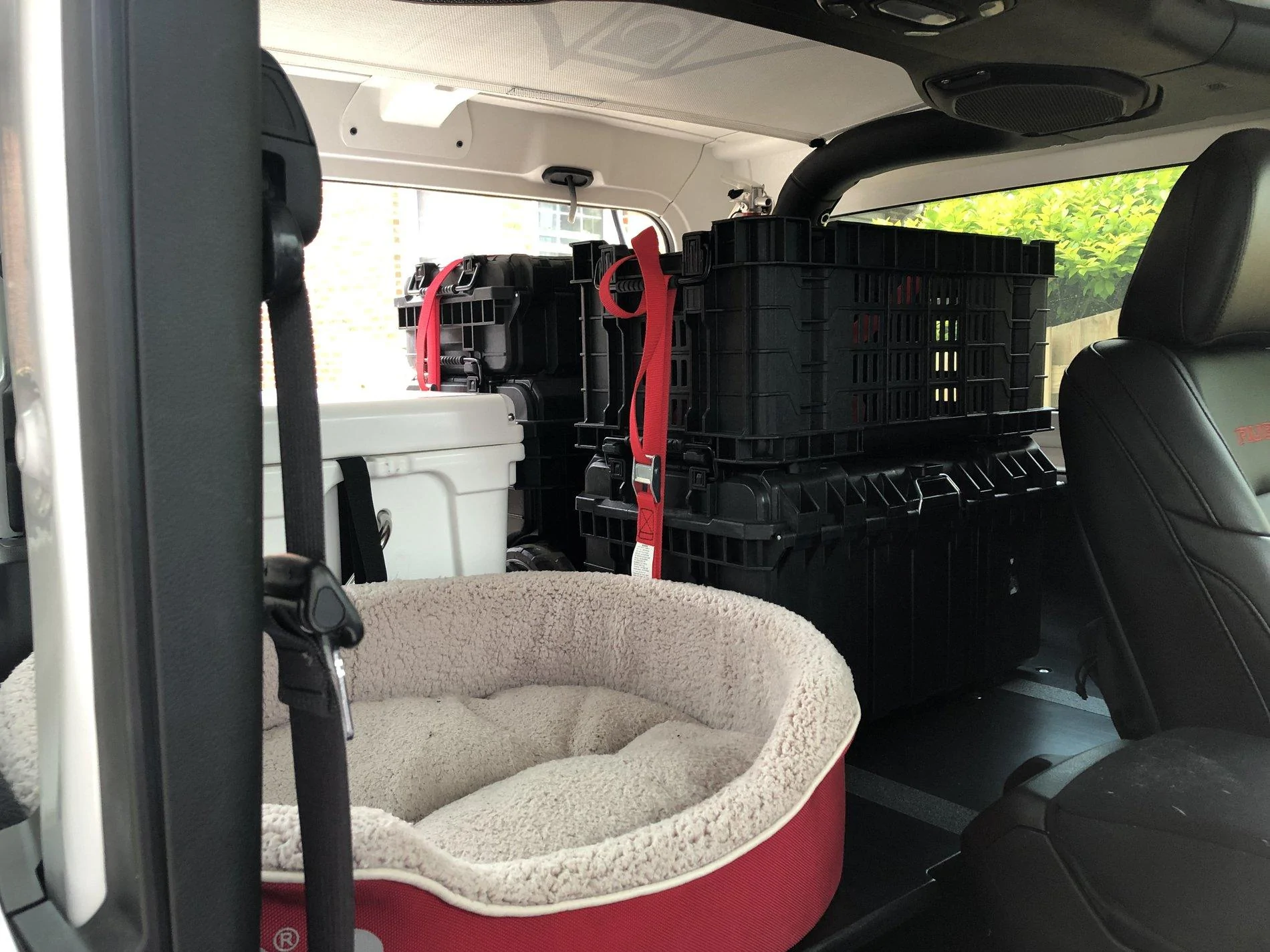

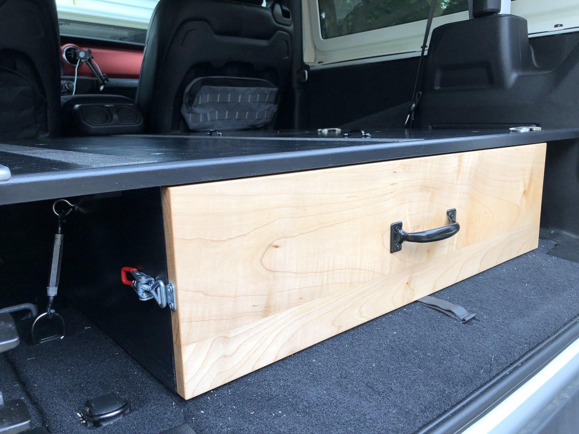

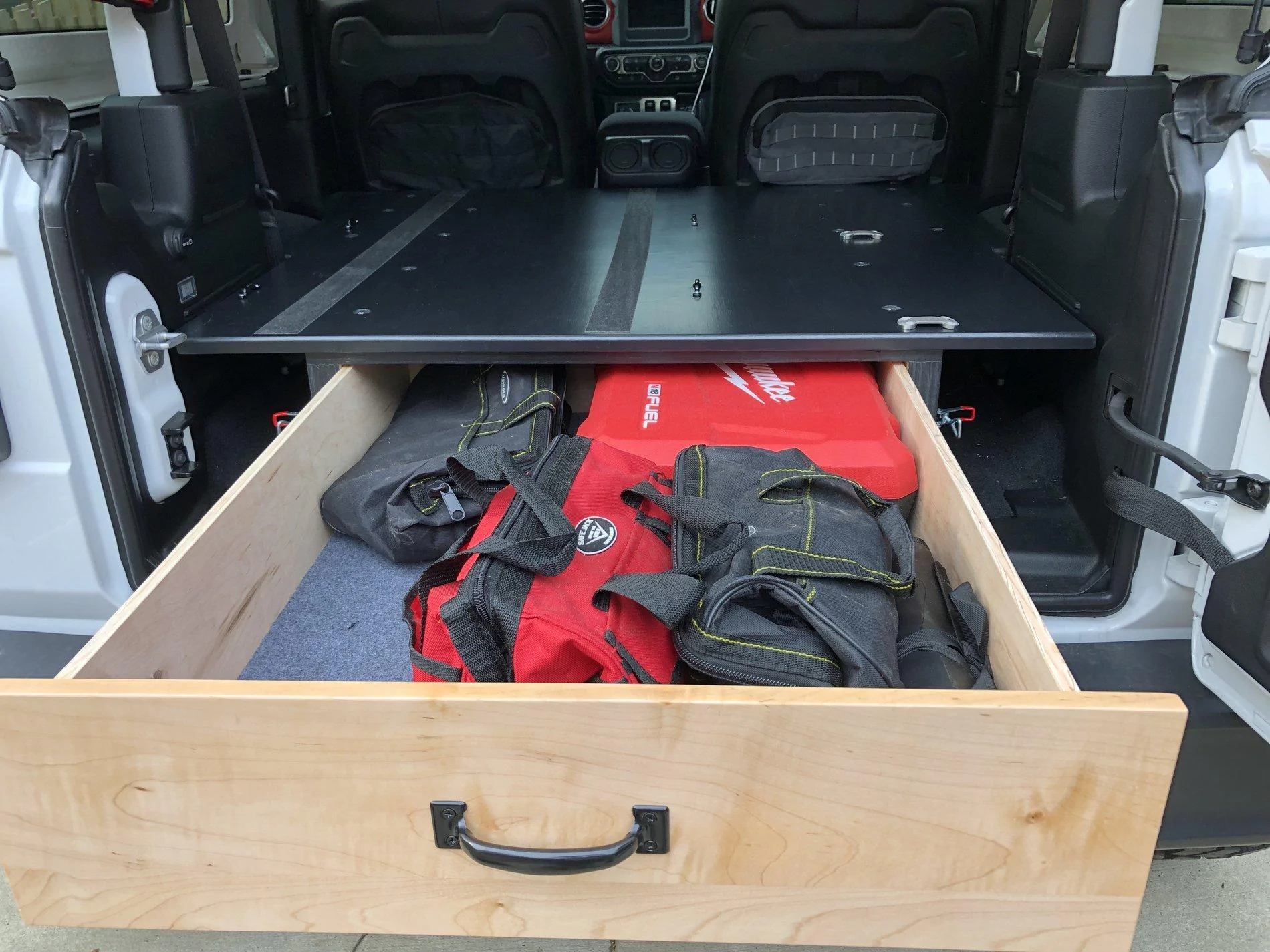

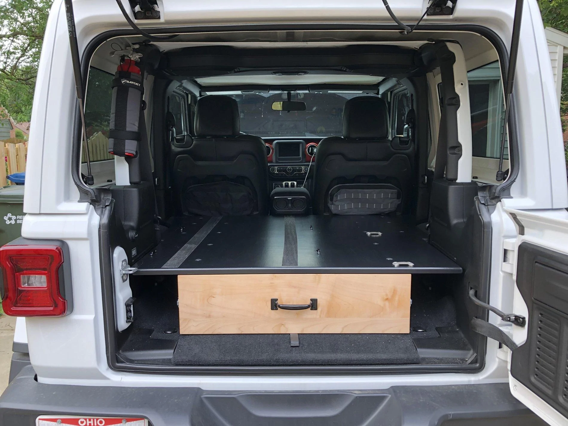

Finished up my storage system. While not perfect in design, I'm still extremely happy with how it turned out. Can't wait to give it a go. I still may fool around with some drawer dividers. I'll see after the first use whether it's needed or not.

Did you extend the rubber snubbers so the spare tire sits firmly against them? If yes and the tire is still bouncing back there, is there any other adjustment that can be made to pull the tire closer to the tailgate?

The rubber isolators are stock. The carrier has enough adjustment to get the tire snug against the tailgate. It's not so much that the tire is bouncing around at the mounting point. It is a very snug fit. It's the lack of strength in the stock hinges that allows for sag and movement of the entire assembly. It's fine for driving around town, but I'm not confident wheeling with it like that.
