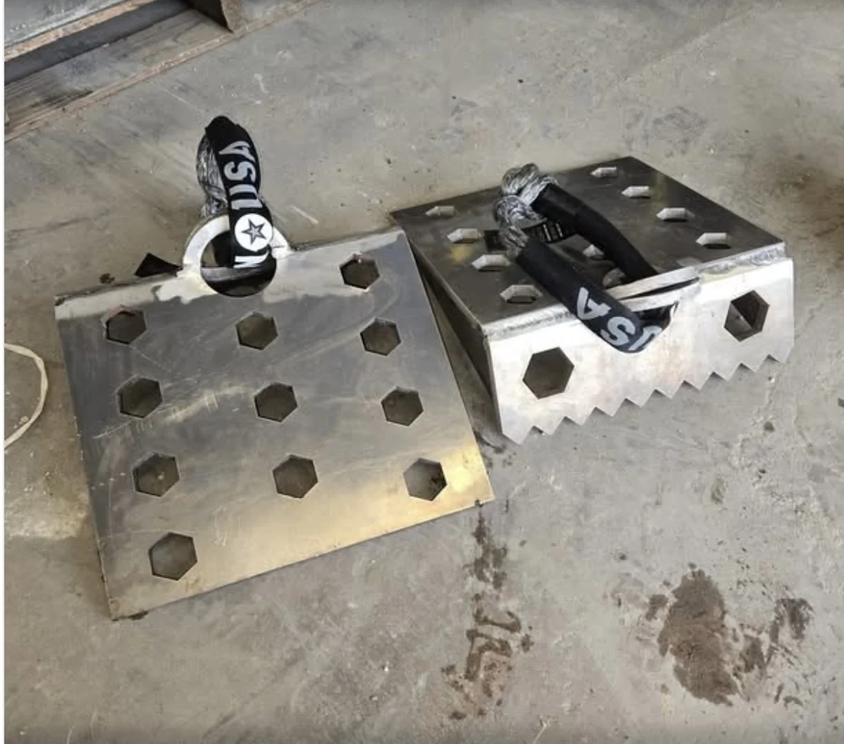

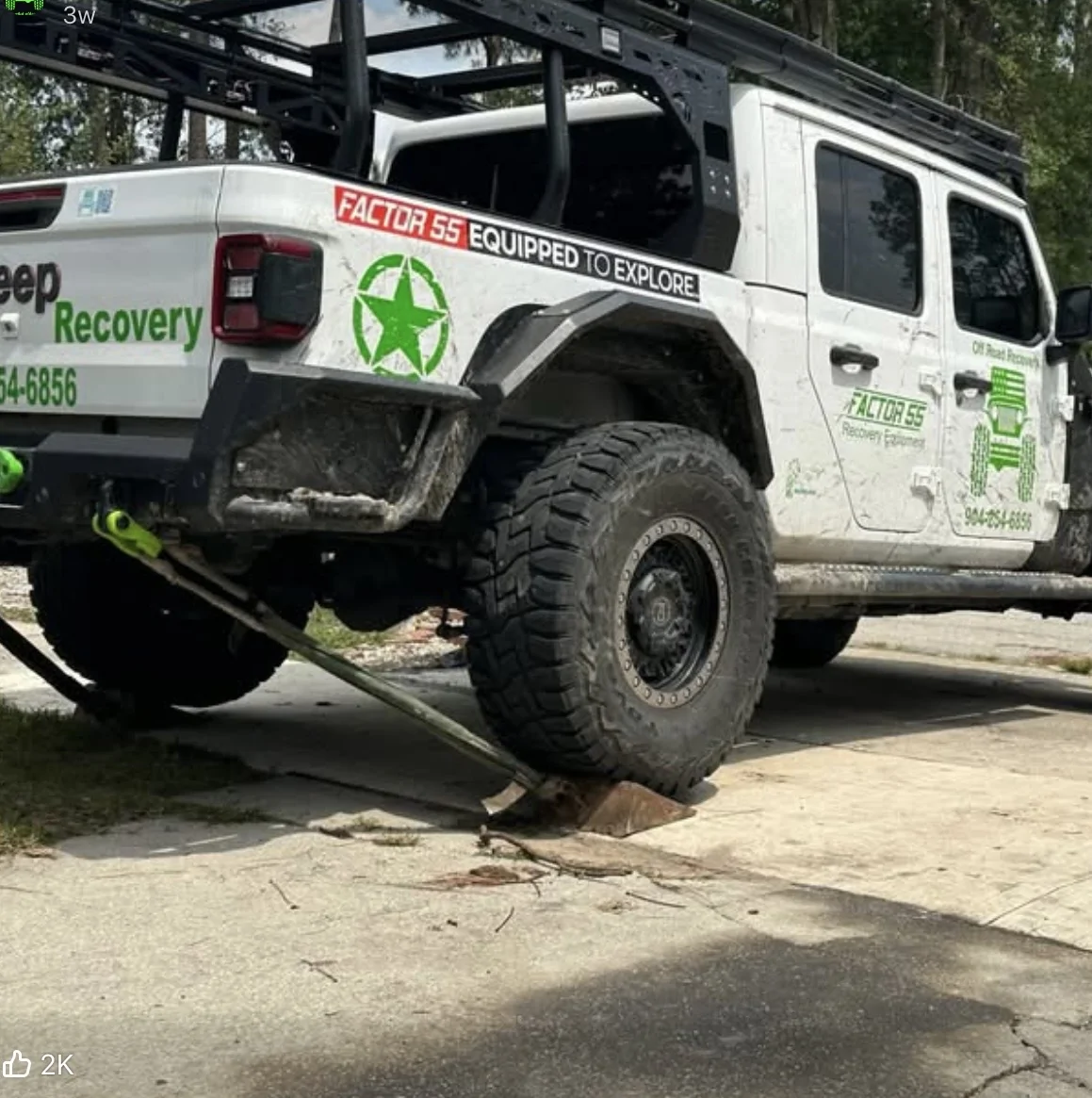

I’ve seen a tow truck use these to stop sliding while trying to winch on slick mud. The chain or straps stop the vehicle from over running the chock and forces it to dig down for better traction. I’m sure you’ve seen a Jeep with nowhere to anchor itself attempting to winch recover a stuck vehicle and just sliding toward it. Anyway looks like they would take up a fair amount of space, could bend the frame, and would have limited use, but I’m bored, so what are your thoughts? Not the best pics but you get the point

I've not used them, but I like them in concept. I don't think there's much in the way of risk to the frame, as the straps just keep the chock blocks from being able to slide, and keep the vehicle from being able to climb over them. I'm not recovery professional, though, so take that opinion with a grain of salt. ;-)

Probably no worse, and potentially better than, running a line to another vehicle, tree, or whatever to anchor the winching vehicle. If possible, to me a better idea would be to use a pully or snatch block to run the other end of the line to a second anchor point to cut the load on the winching vehicle in half. But I like the idea of a set of wheel chocks as a quick and easy solution -- if they work in whatever mess I'm sitting in whilst trying to winch. My main question is if they are big enough to dig down enough in a soft dirt road or whatever to actually hold the Jeep in place.
A quick search only turned up a couple of large steel ones, and they are $600+ for a pair, pricey! May need to find a friend with a welder.
Then there are these: https://baileystowinginc.com/product/baileys-scotch-block/ for $1485/pair (!)
I have an old Pull Pal I quit carrying when running with other Jeeples but kept just in case I need a back up anchor when there are no trees around. I can attest that getting it to dig into rocky ground can be a PITA.

I wondered that too. Would they just plow forward and only slow you down slightly. If the front lip was taller and it dug down deeper maybe. Obviously not suitable for all conditions you find yourself in, but I found them interesting. One upside is it seems like once you’re done, if you back up slowly, the straps would easily unbury blocks.

Also wonder how slick they get with moisture/mud on them. Seems like adding some ridges or something to keep the tires from sliding would help, which is what many of the plastic blocks have. This is when I wish I knew welding and had a welder to gen up something.

i feel like this would be easy to test, winch to a tree on some slick grass and see if you can load the winch more with or without these before sliding.
at the very least i can see these being a gamechanger winching people back onto, and from an icy road. especially when i cant run a line across traffic to a tree somewhere else.
