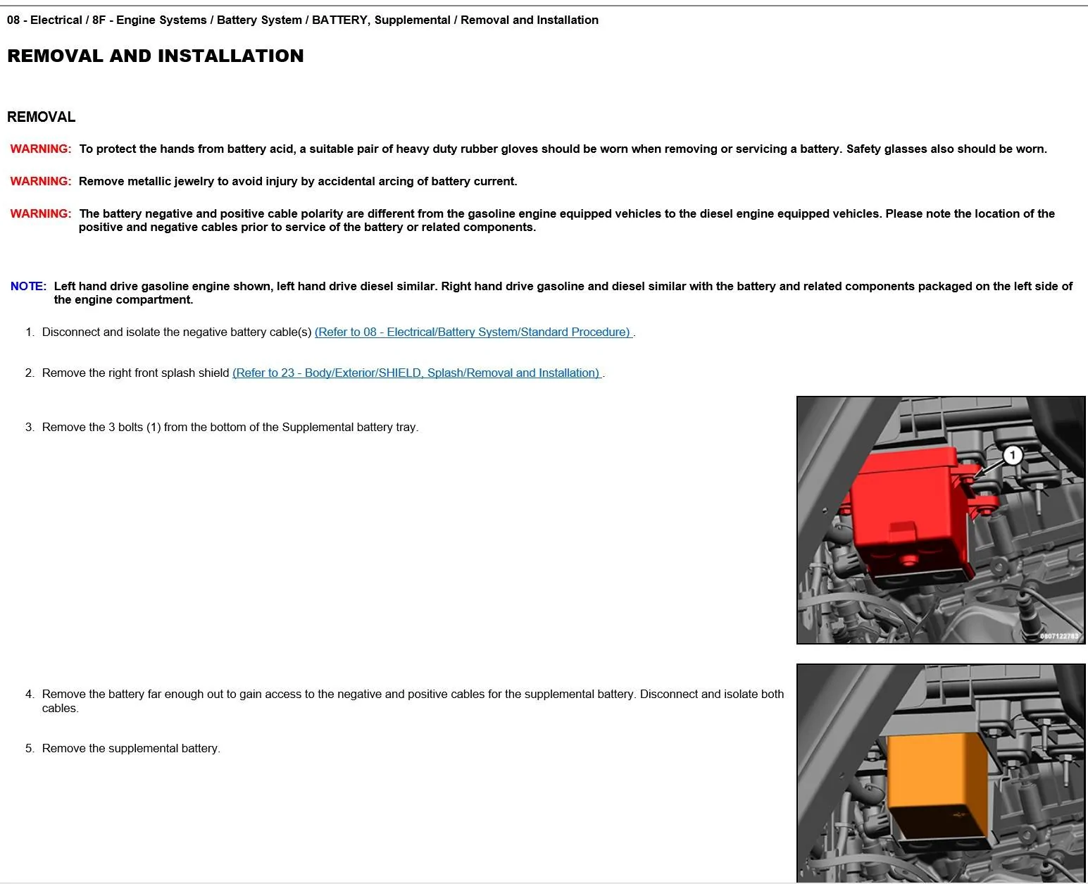

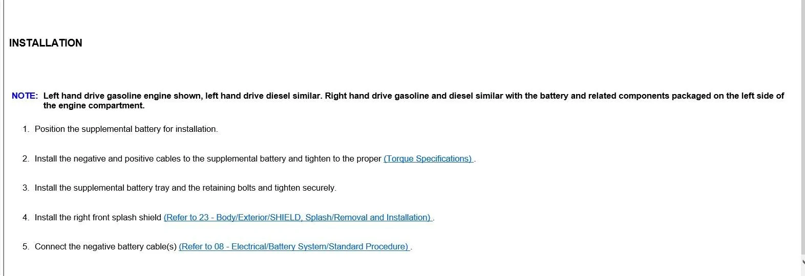

Not familiar with the schrader valve in the fuel system. The fuel lines should self-purge of any air when cranking.
In the states, we have a two battery system in the JL. The main battery is obvious. But the small auxiliary battery is mounted under the fuse panel (power distribution center). This small battery is sometimes the crux of electrical gremlins.
Jeep Wrangler JL Schrader Valve aux battery removal1
Jeep Wrangler JL Schrader Valve aux battery removal2
