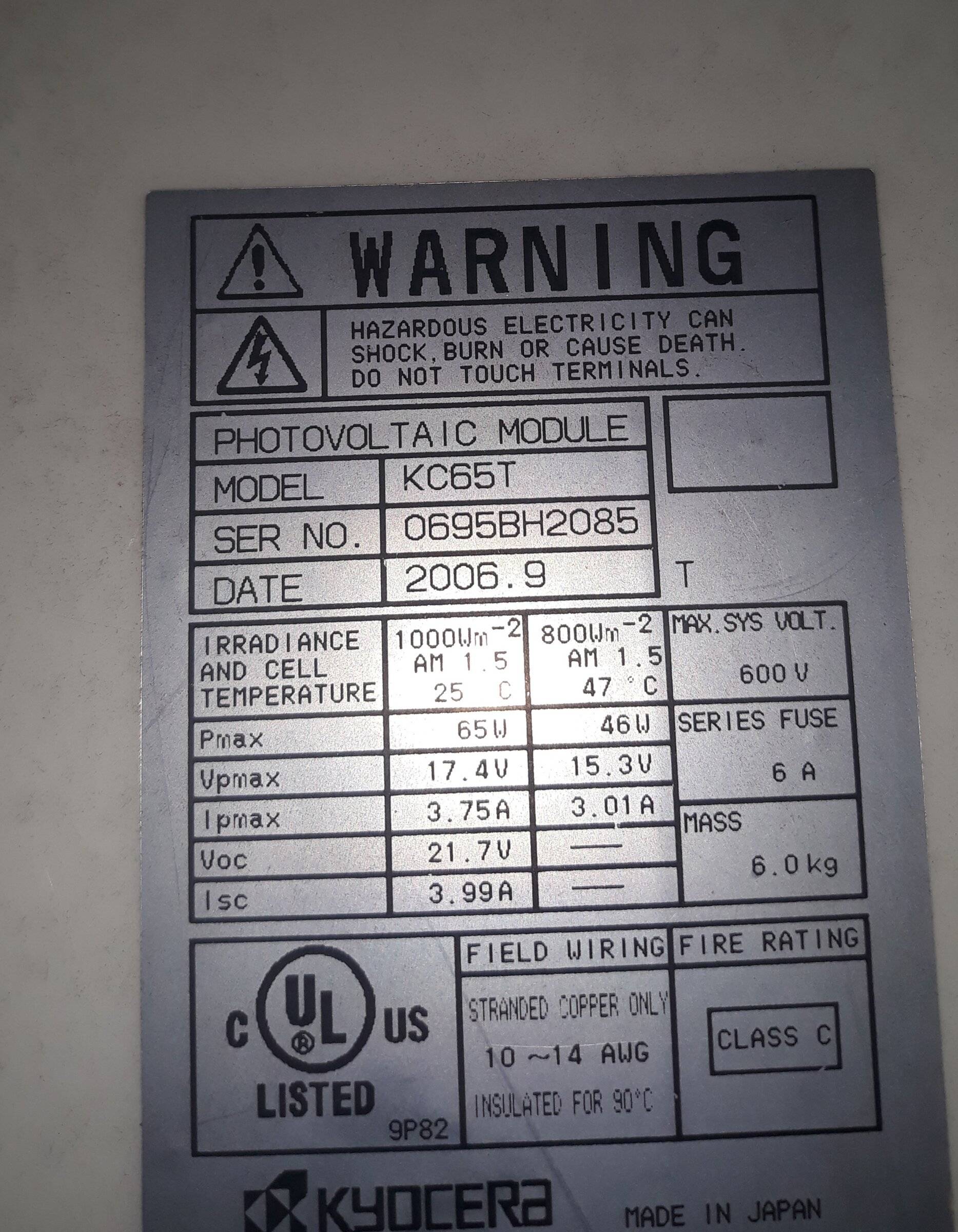

Example, here is the name plate off my gennys panel. A toy compared to the systems I've installed, but its served me well over the last 16 - 18 years.
