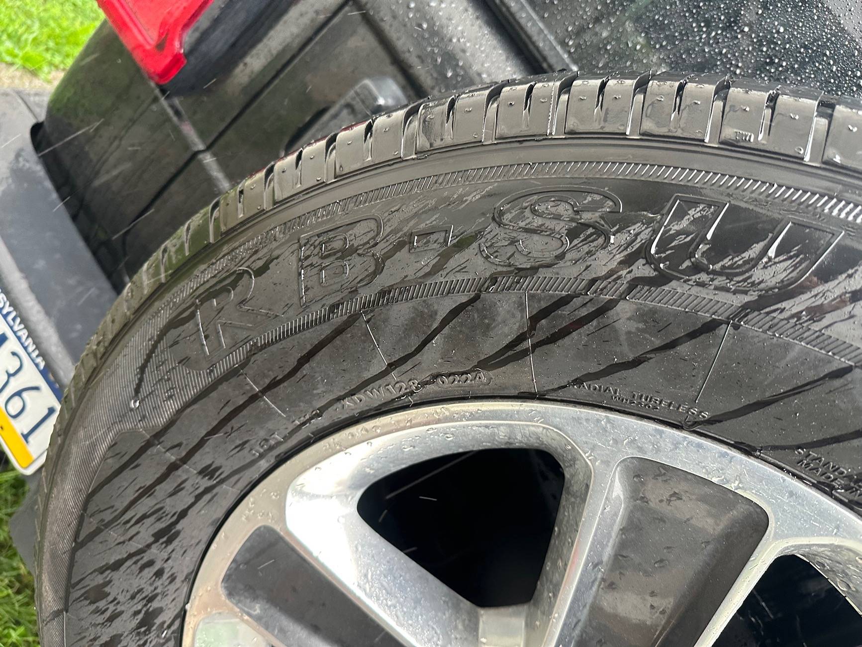

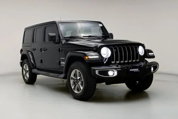

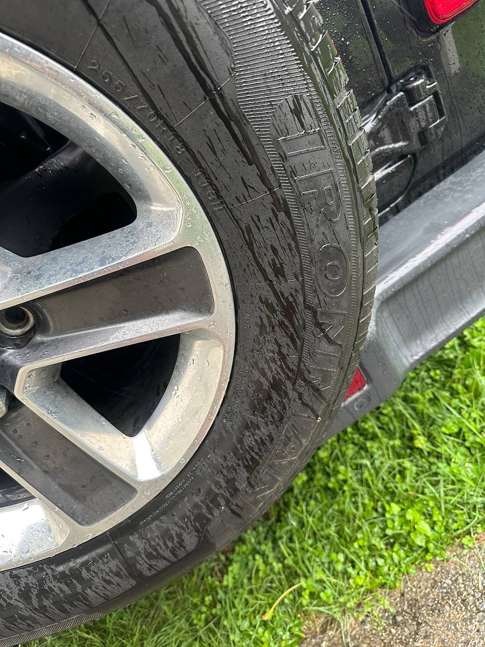

I was wondering if ride quality was affected with adding stock tire size ko2s (255/70r18) on sahara jlu? I know some sites don’t let me make the selection because speed rating, I think or load rating so I was wondering if there were any downsides. I’m currently running some cheap tires (Ironman R-B SUV) bc those are the tires that CarMax just puts on every car they sell, smh. But there’s a picture of my jeep from carmax site and then the tires that are currently on them for reference.
