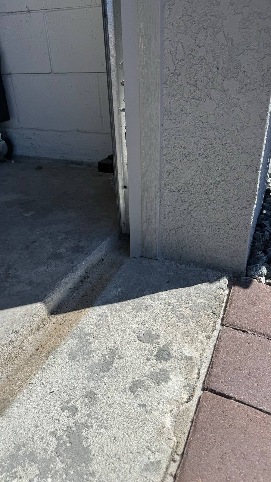

Looking for something to protect my JuiceBox cable when closing the garage door on it. I tried a few of the rubber mats from Amazon but they don't fit. The "lip" that my door closes into makes it a little tricker. Anyone have something they'd recommend? Thanks.

I'd bolt in a pressure treated 2x4 or 2x6 right against the lip for the door to rest on and add a slot for the cable to rest in. You could also cut the outside edge at an angle to make the lip less lippier. Depending on the thickness of the door you may need to chisel out a little bit of concrete so the cable doesn't get bent too much, but the lumber will hold all the weight of the door and not crush the cable.

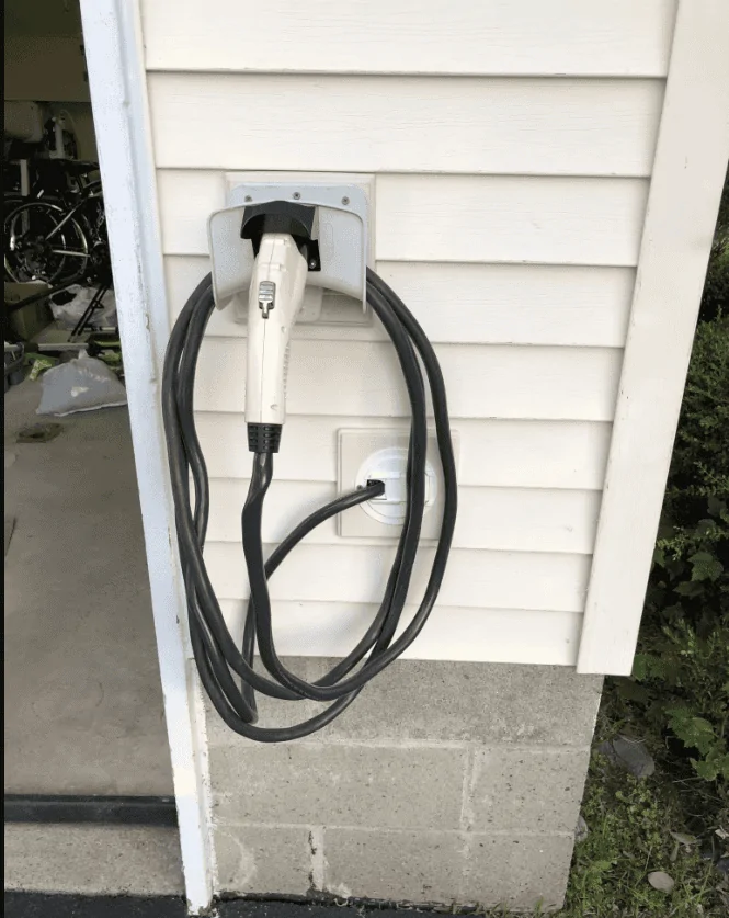

Jeep Wrangler JL Running cable under garage door Captur

I have a solution to this….?

Looking at the picture, your garage looks to have a 2-3" lip to... so water probably doesn't enter your garage.
Would it be possible, (not sure of the correct terminology)
In the corner (in-line with the outside weather sill, where you already run the cable, "grind/grate" more of a SLOPE removing the 90° angle
THEN
On the flat surface where the garage door sill actually shuts and touches, make a channel just barely bigger than the cable.
Seems like that would take the tension off of the cable caused by the 90° angle and the channel would protect the cable from the door being shut on it.
Hopefully I explained this well enough to make sense... Because I swear it did in my head ! ?
