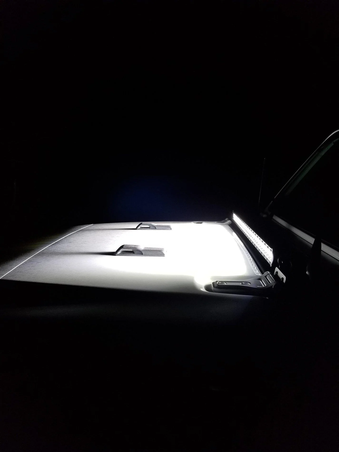

I went with the RC 30 inch bar. There is glare from the hood but it doesn't bother me. When it warms up, I will be putting on a matte black hood decal to fix that.

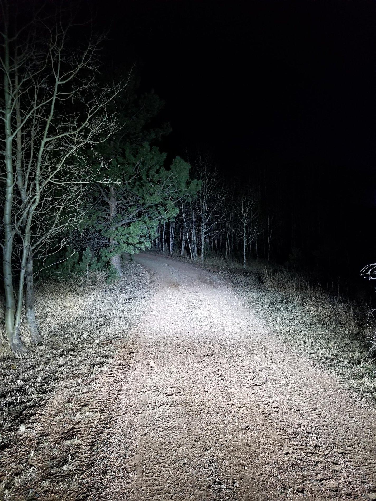

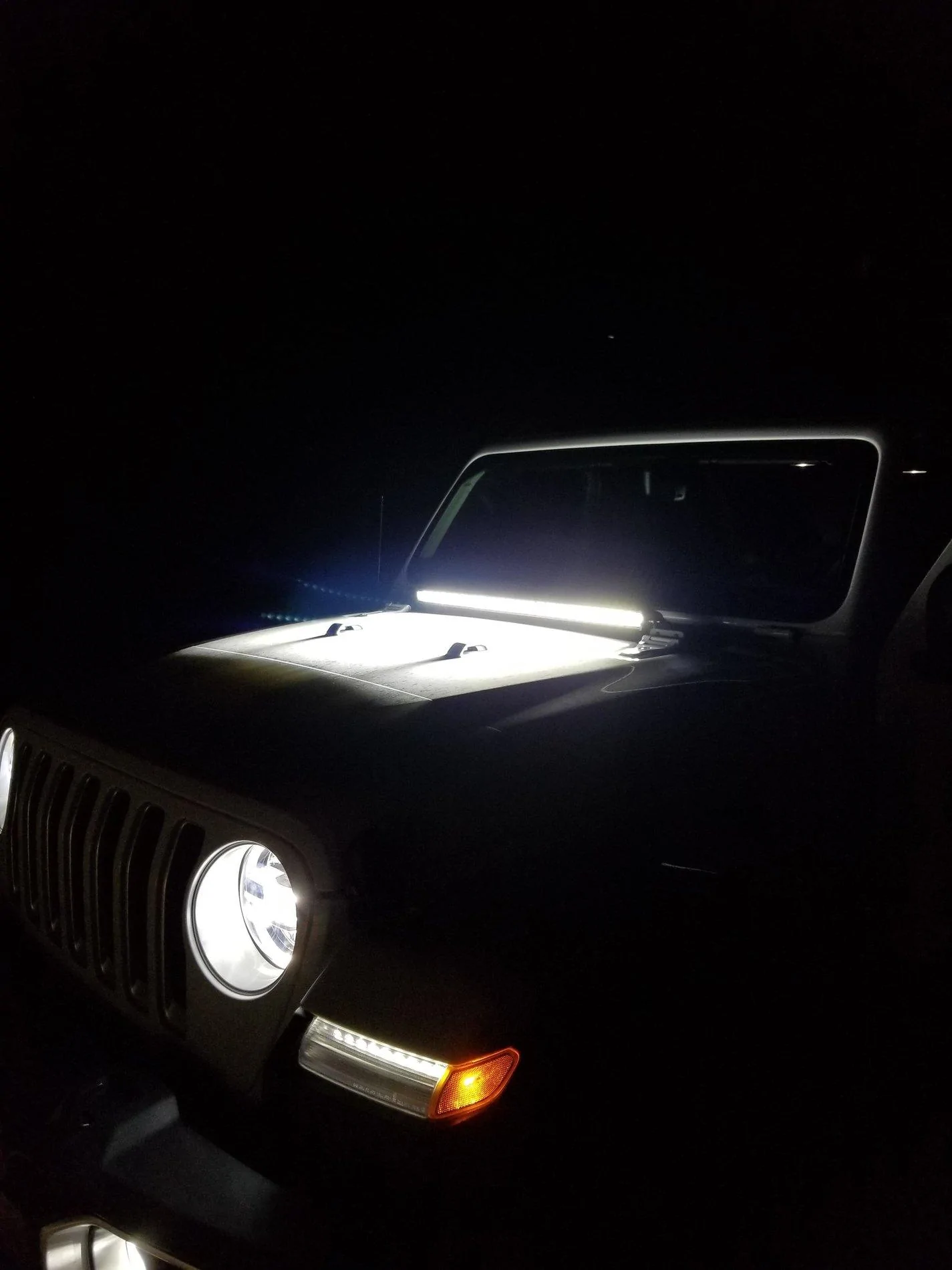

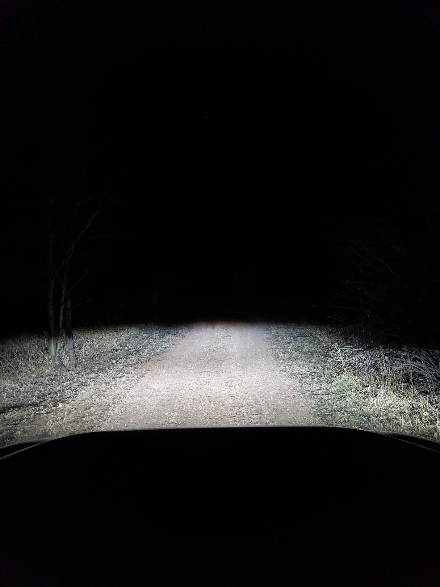

Here are some pics with the hood LED off and on on my driveway. Also some shots of the hood. Right now the hood glare does not bother my eyes at night because it is not reflecting back towards you. I plan on installing a matte black hood decal in the next month or so. That would take care of it. Overall I like the light very much.
Left click each pic to enlarge them....The hood of the JL has a slight downward angle from the wiper blades to the front edge of the hood. Therefore, there is no loss of light beam. However, you would get a kick back reflection from any light on the A pillar or the hood, thats why matte black hood decals are a good option or simply go with a front bumper mount.

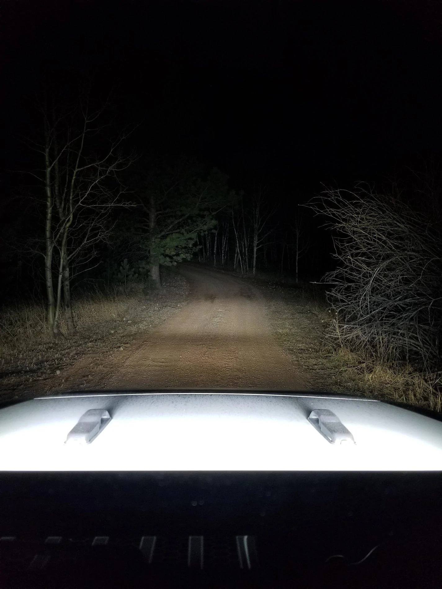

and a shot from inside the Jeep...disregard the light output from this vantage point. The camera iris does not pick up the light well in this pic.
