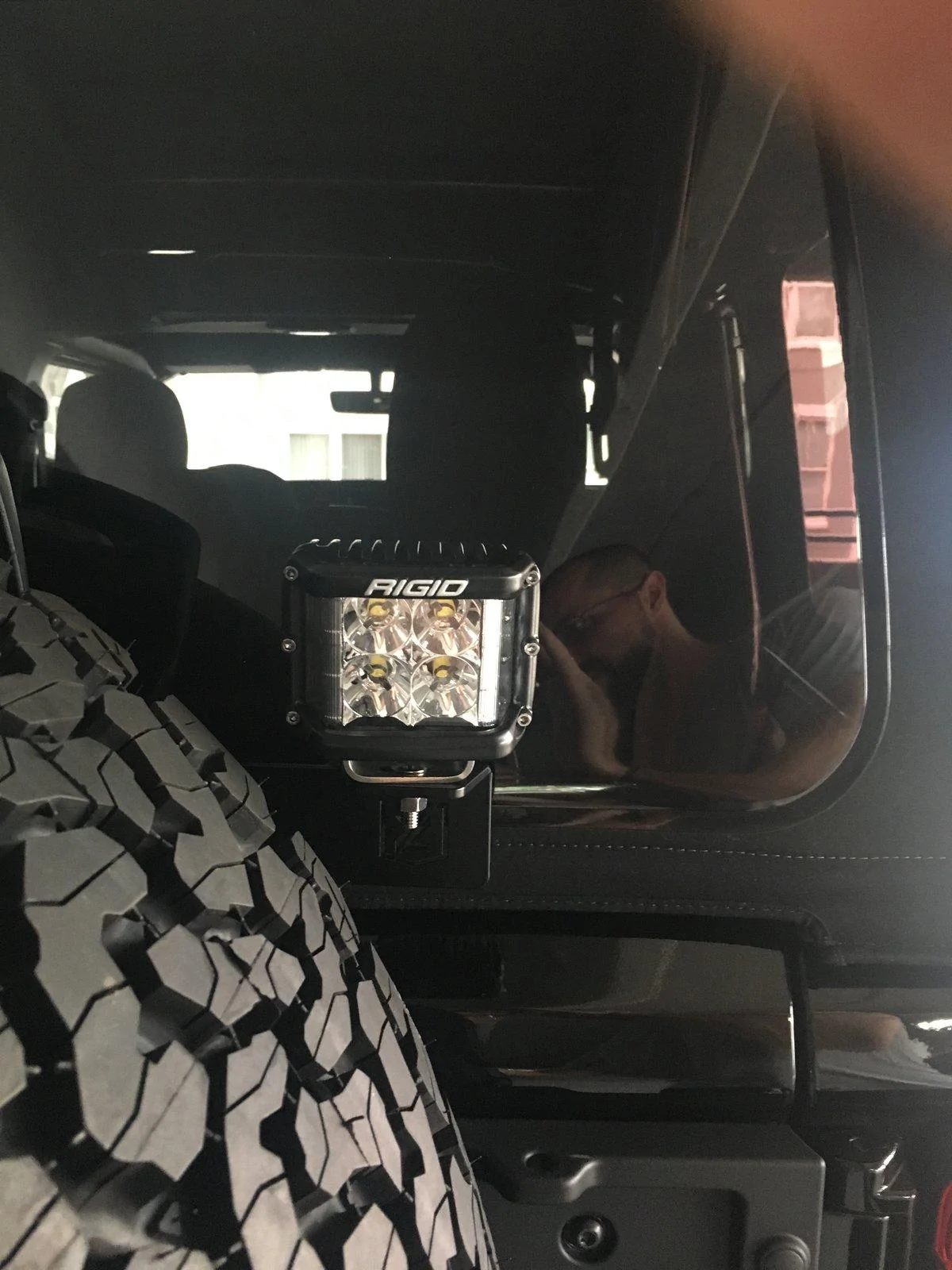

    Hey guys,

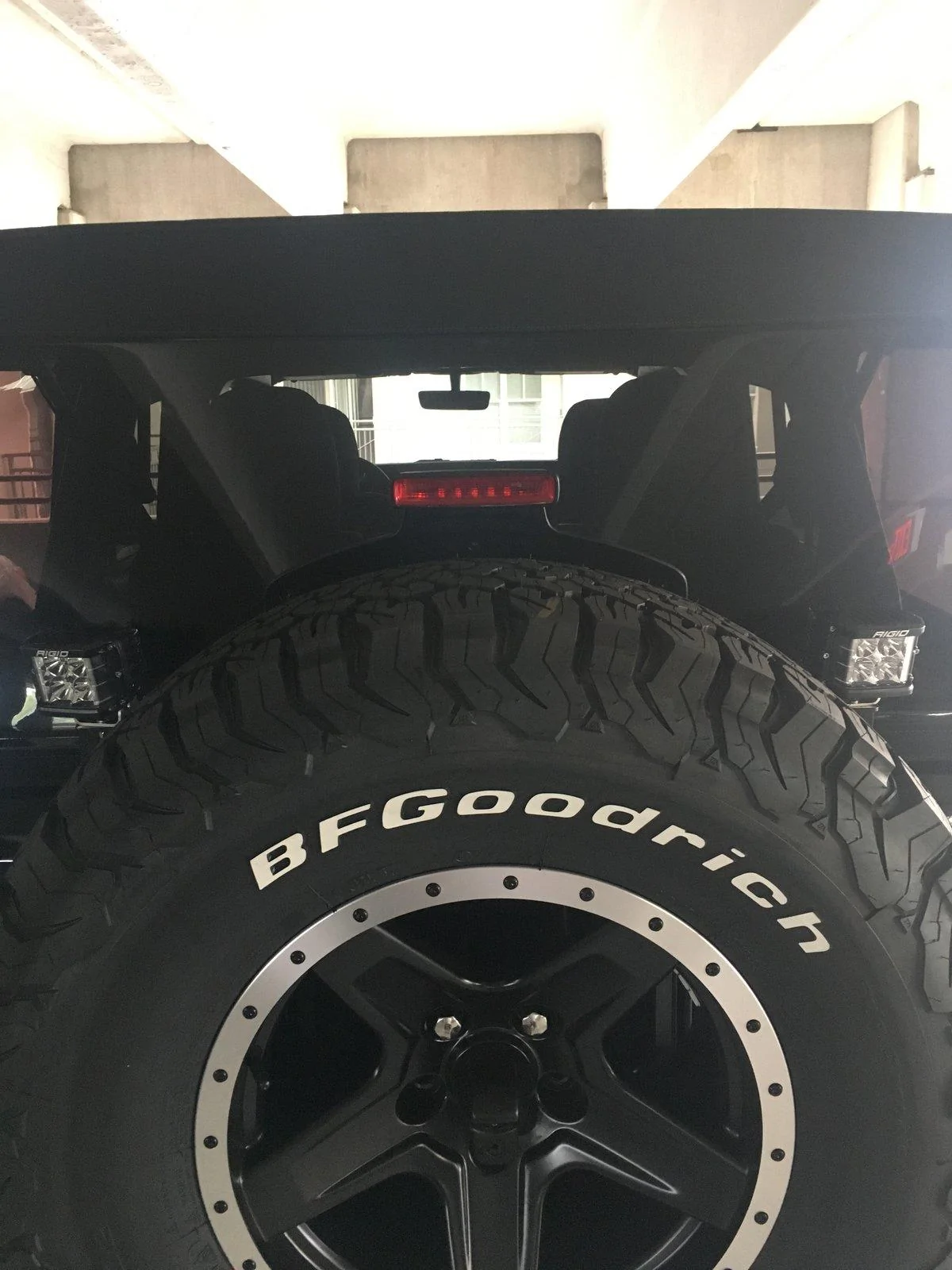

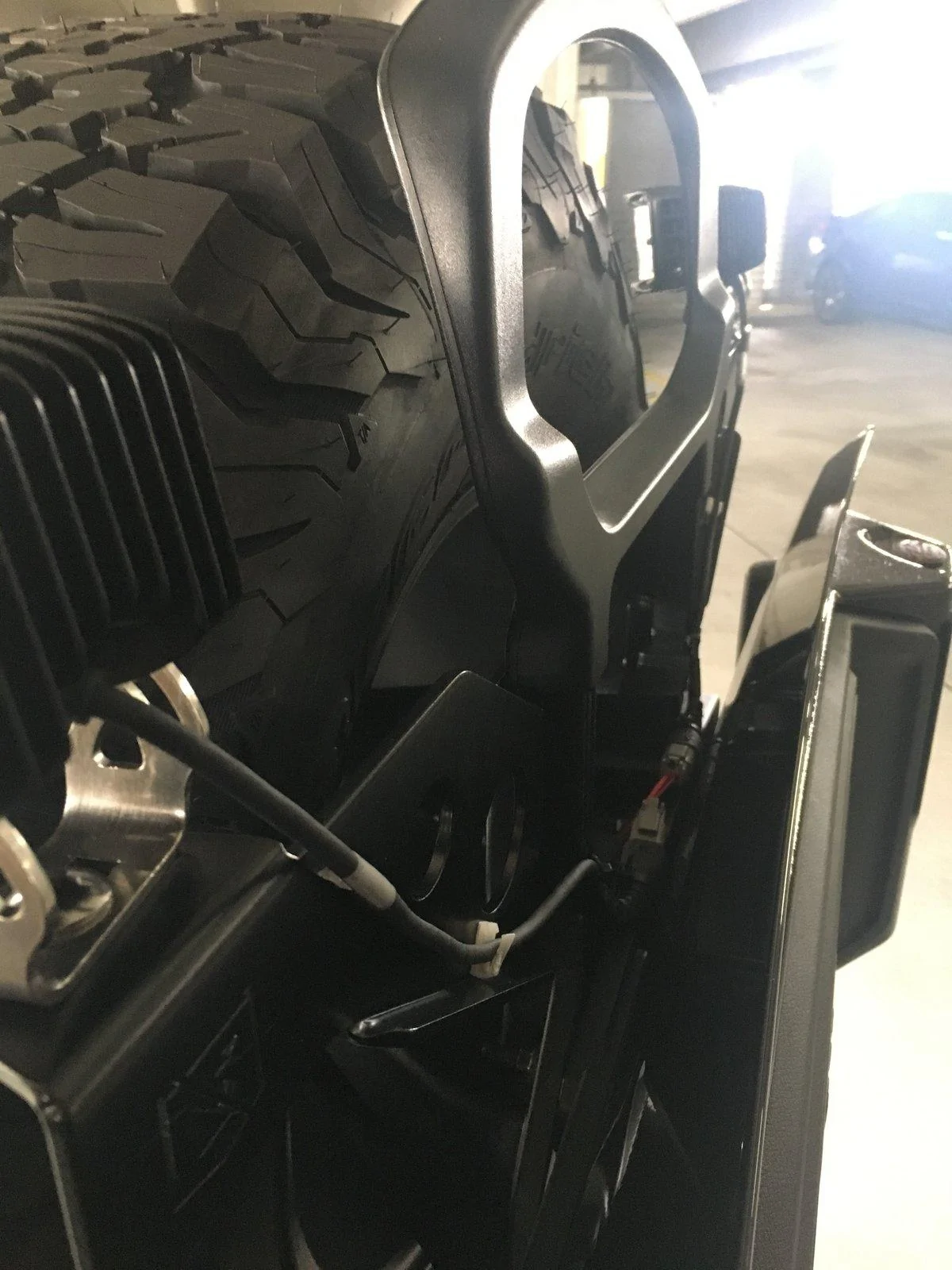

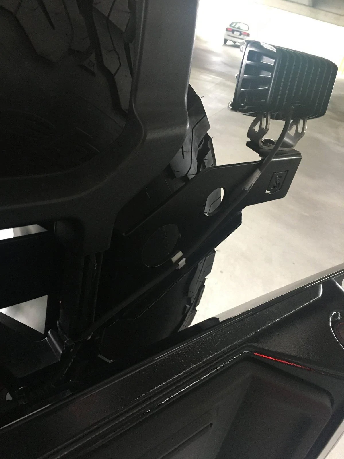

    I’ve seen a lot of people discuss lighting options for the rear of the Jeep, but haven’t seen anyone mention the ZROADZ bracket I recently installed. I’m sticking with the Mopar steel bumper so I didn’t really have anywhere in the bumper to mount lights, and I like the fact that this bracket mounts them higher up than the bumper. Easy install, you just use the four screws that hold the center tail light for the bracket. I had already moved my center tail light to its highest position since I installed 35s, so I just used a few spacers for the top screws. Not sure if this bracket is being discontinued, but I was able to get it at Extreme Terrain for $119. Usually goes for $165 I think. Also, their website says the bracket only works with 32 inch tires, but as you can see there’s more than enough room even with 35’s.

    That's a pretty neat bracket. To bad it wasn't adjustable for larger tires. Does it vibrate at all while you're driving? Nothing annoys me more than lights that shake.

    hey, sorry just seeing this.
    Yea I was concerned at first because their website said it only accommodates tires up to 33”, but I have a 35 on the back and I’m pretty sure It would easily accommodate 37’s. Even with 40s you could probably make a little bracket to extend the light out a little bit. That’s what I was planning on doing if the bracket was too small for my 35s.
    And no the bracket doesn’t vibrate at all driving. The light shake a little bit when you close the tailgate but that’s it.
