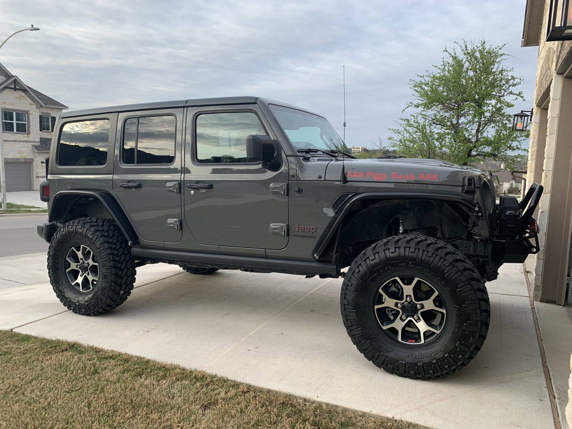

So I finally pulled the trigger and went with the 3.5” Clayton Overland Plus. It’s been on for a week (just got tires today though) and it rides really nice. The install was pretty easy but I have a somewhat minor complaint for @Clayton Off Road. Why don’t y’all cut the sway bar links before sending? That seems like a really silly place to skimp out.

Looks awesome! Can't wait to see some more photos. We're happy you found the install relatively easy and appreciate your feedback as well! At the moment due to supply chain issues, it's easier for us to keep a one size fits all rod stocked and shipped out with kits, that way we are not pre-cutting any rods and running out of a particular size which could possibly extend lead times further out. Hopefully that makes sense, it's also just another nice way to fine-tune your build and get that rod cut exactly to where you need for your specific build and vehicle!
