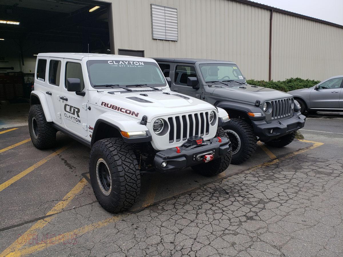

Can you tell me where the bumper on this Clayton JL is from?
Jeep Wrangler JL Rock Krawler vs. Clayton AE5F86EA-5C20-48A5-B8D1-9428DB10A121
