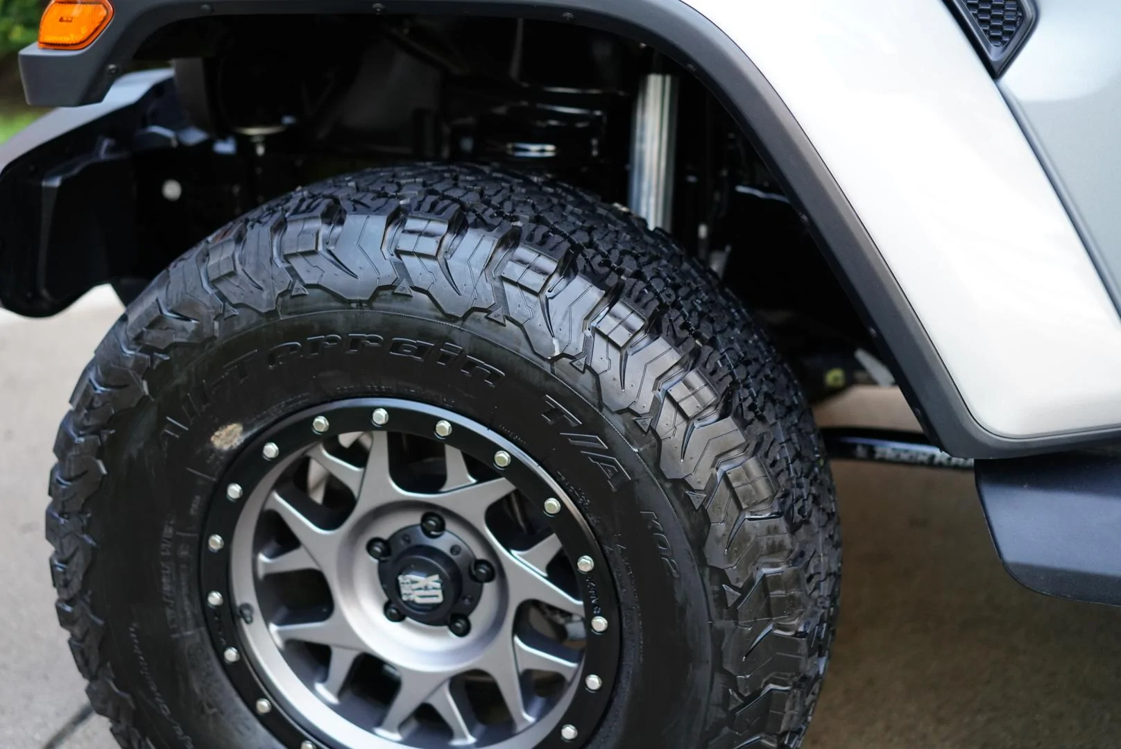

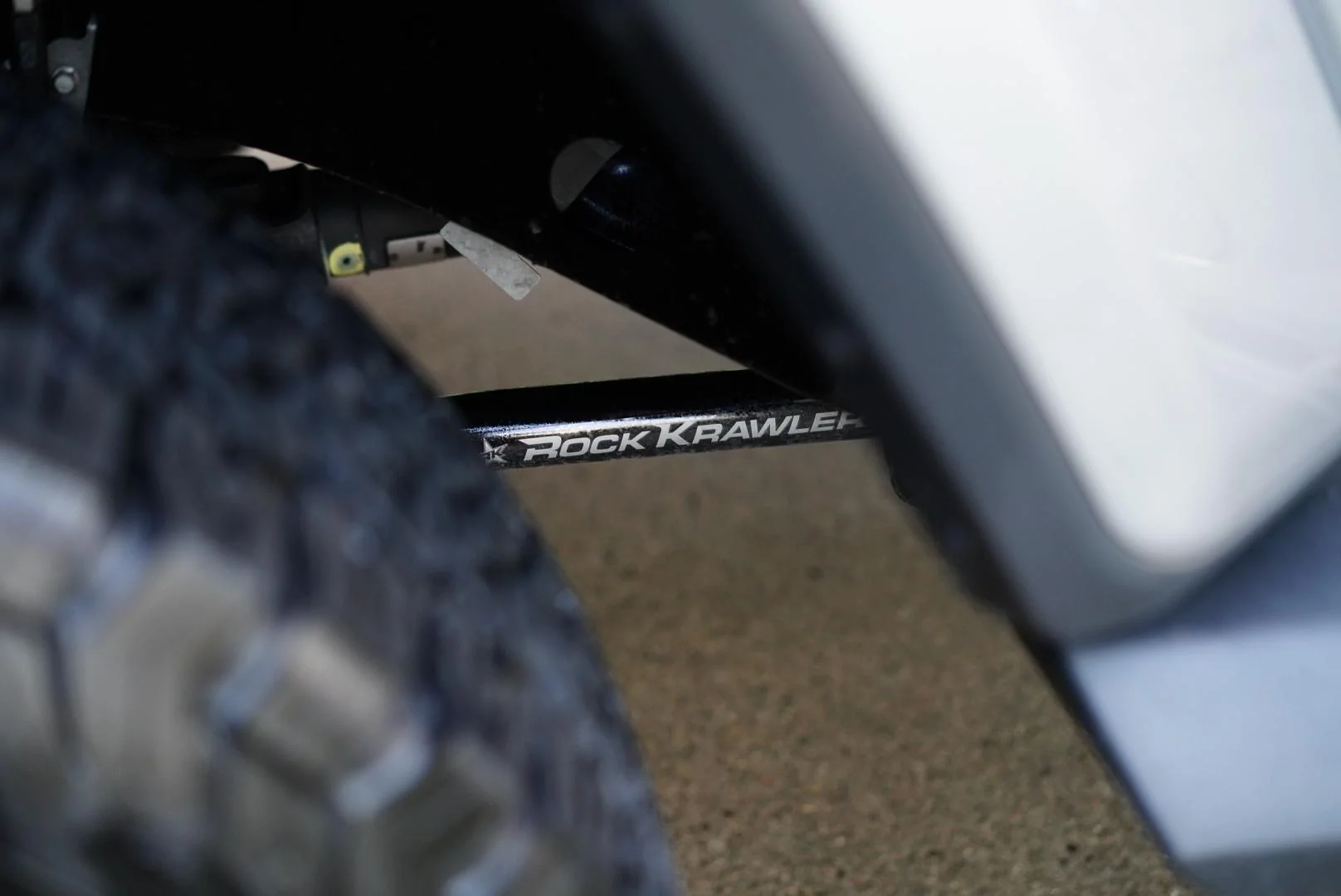

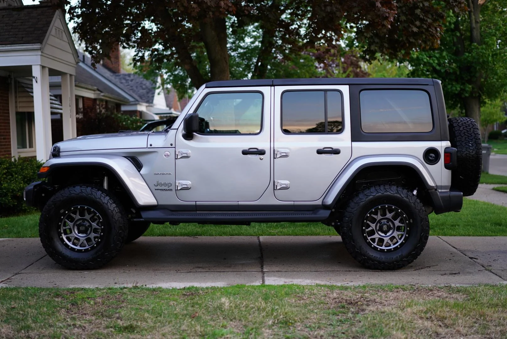

How was the install? How is the ride?
TroyBoy
Troy
Jun 14, 2017
95
1,413
1,549
Vancouver Island, Canada
how did you get that lift? Are they shipping now? I've ordered and paid for mine a long time ago.
