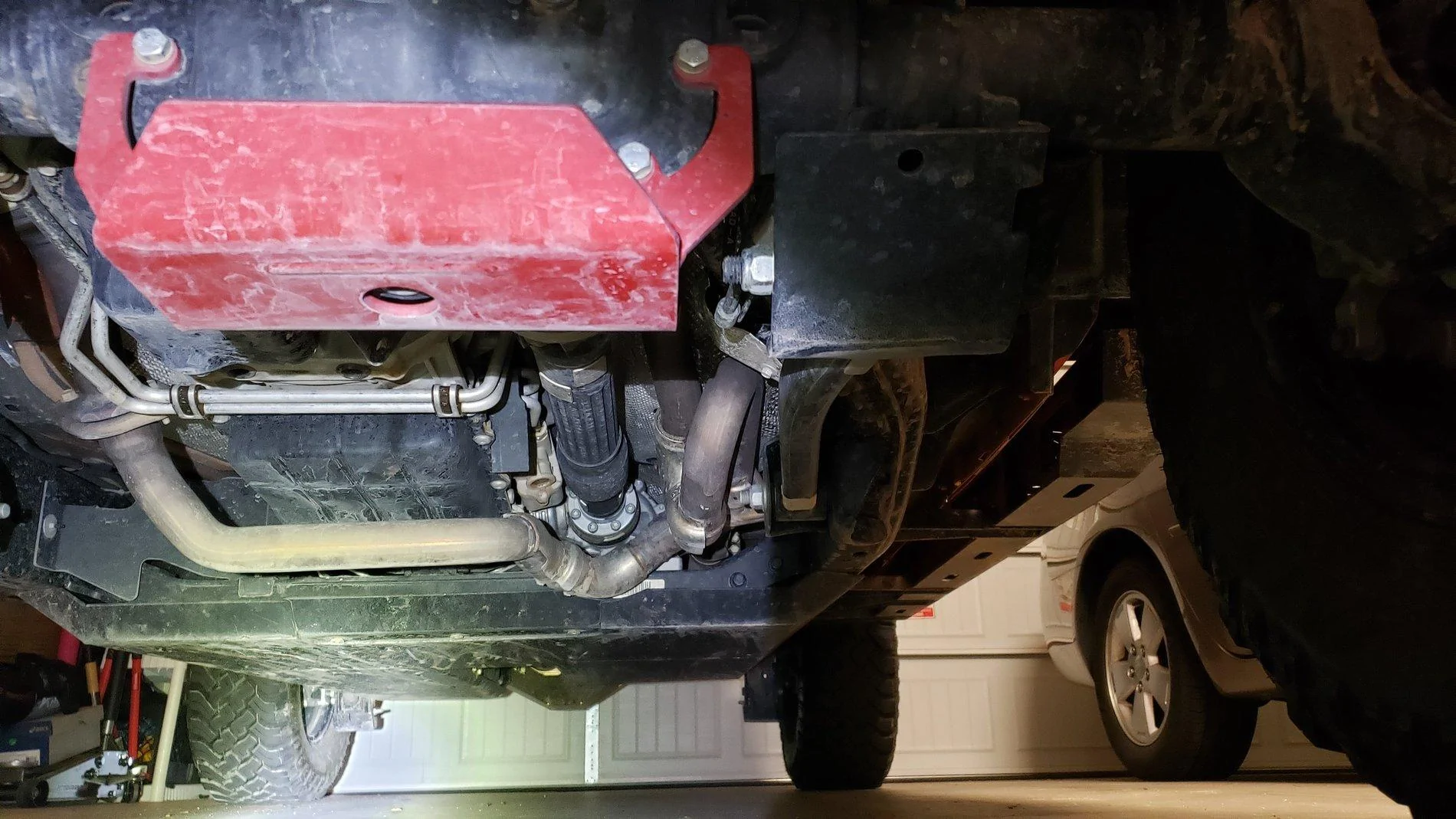

I went with Rancho rear control arm skids and have never had a clunking issue with them. I'm on my second set of RH front skids and now with the aftermarket bolts and they still clunk! I've gone through having both sets powdercoated red (to match the Ranchos and my Yeti track bars), then had them installed, removed, new set installed with aftermarket bolts..... just for them to start clunking again not long after :( RRRRRRRRRRRRRR!!!!!!

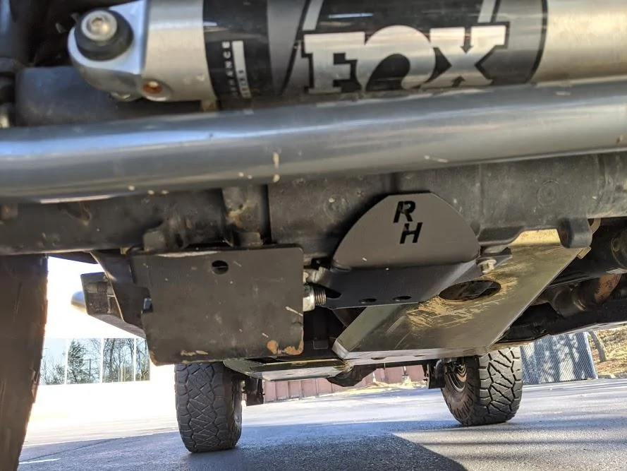

I’m using RH on the front axle and frame sides, Rusty’s rear frame, and Artec rear axle. As of now, with all torques correct, no clunking. Fingers crossed.
I kinda liked getting the bare metal Rusty’s… get them powder coated red :)
I spoke too soon. Now I have clunking. Ugh,
