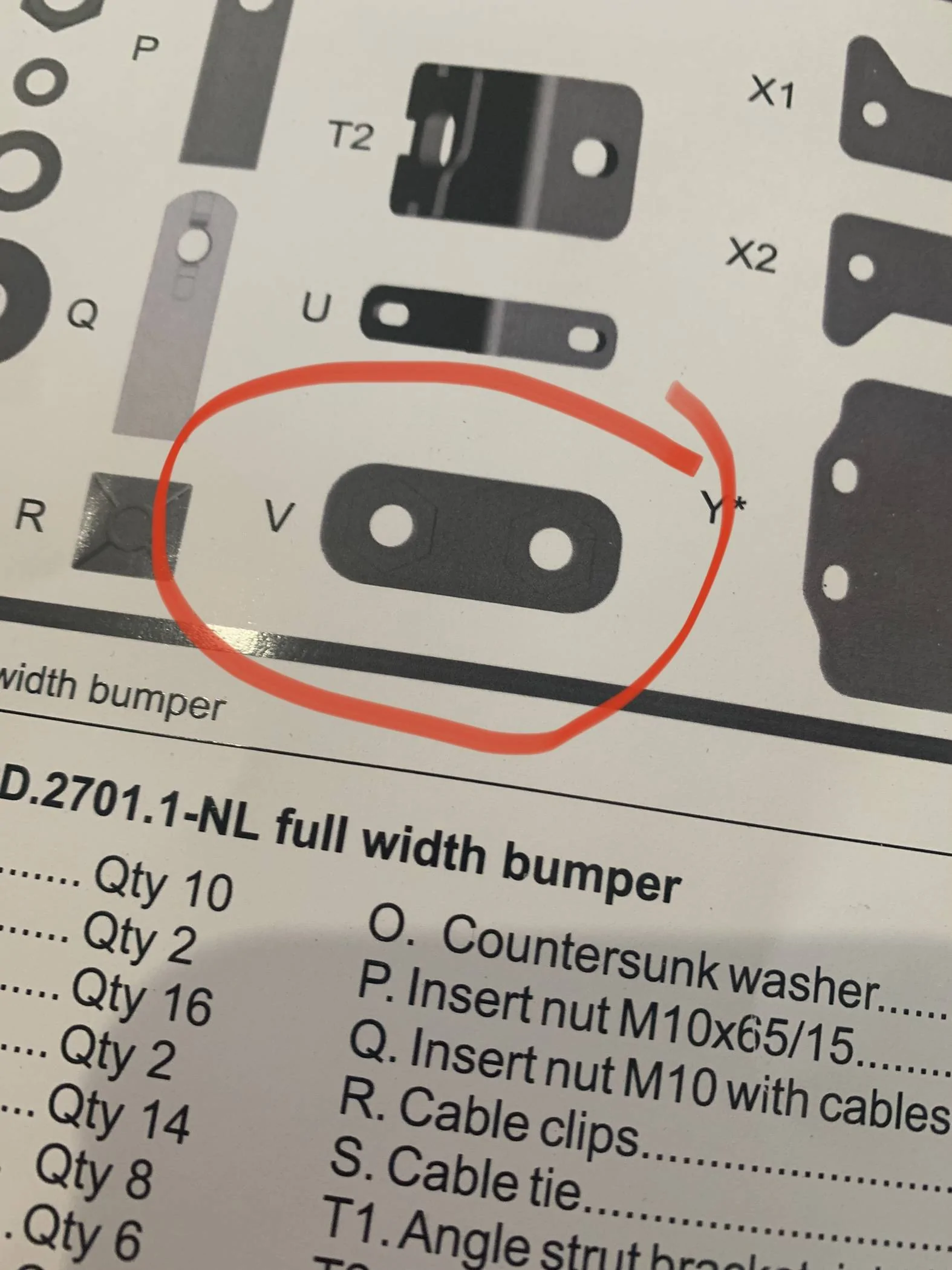

Hey all,
I’m currently in the middle of installing this bumper…am now at the point where I need to install the skid plate brackets…..now I have an issue. It says if I don’t have rivet nuts in the frame (which I don’t) , to use the inner bracket M10 pos . V….which I also don’t seem to have but was supposed to be provided.
Here’s a pic below to what I’m speaking of. Double checking everything looking everywhere and can not see this.
Jeep Wrangler JL Rival 4x4 stubby bumper DC447515-C6AB-4326-9D5E-0451D49304DC
Any help would be appreciated, as now I’m stuck with the Jeep in limbo not being able to proceed with the install. @Rival 4x4
Thanks in advance for any and all help
Edit: By chance did any of you install rivet nuts instead?

Hey all,
yea I believe you need that piece of you don’t have the steel bumper group from the factory. Rival is good about sending stuff you if you are missing it.
Yea I started trying to find some install vids, came across quadratec Vid (not an install one) but they were promoting the bumper …at one point (I’ll attach a pic) you can see that they have the riv nuts on the frame…so I started thinking did they install this or possibly did they have the steel bumper group.
I’ve tagged and now emailed rival about it. Just sucks as who knows how long that will take to get out to me and now I’ve got the bumper more than half way through (done the hardest part) and now I can’t finish it.
hit them up on their Instagram page. They are usually pretty quick. I got the hood struts and the package arrived destroyed. They sent a whole new package the next day.
