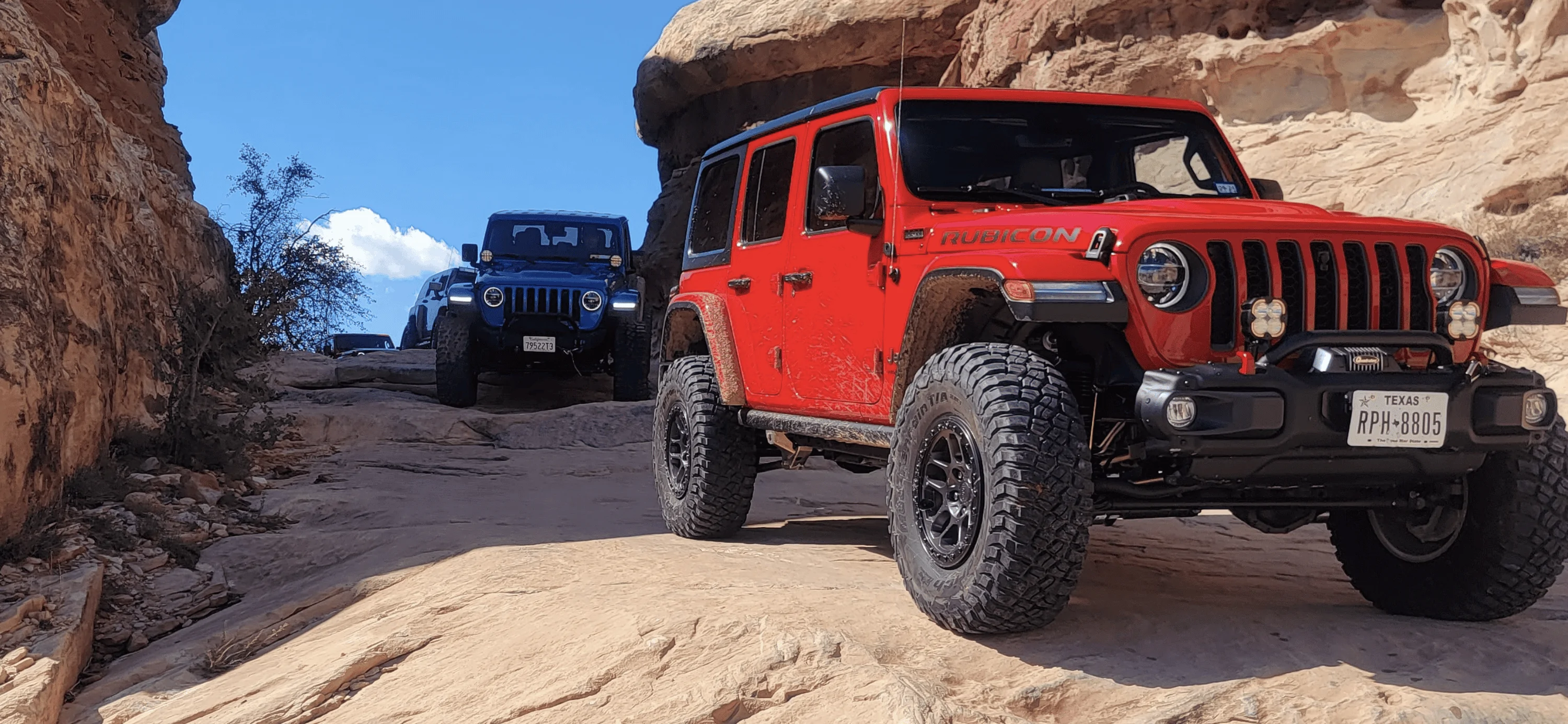

AEV uses +25, which I think is a good compromise, especially for wide axle. A Sport can get away with +12 without having the tires sticking out.

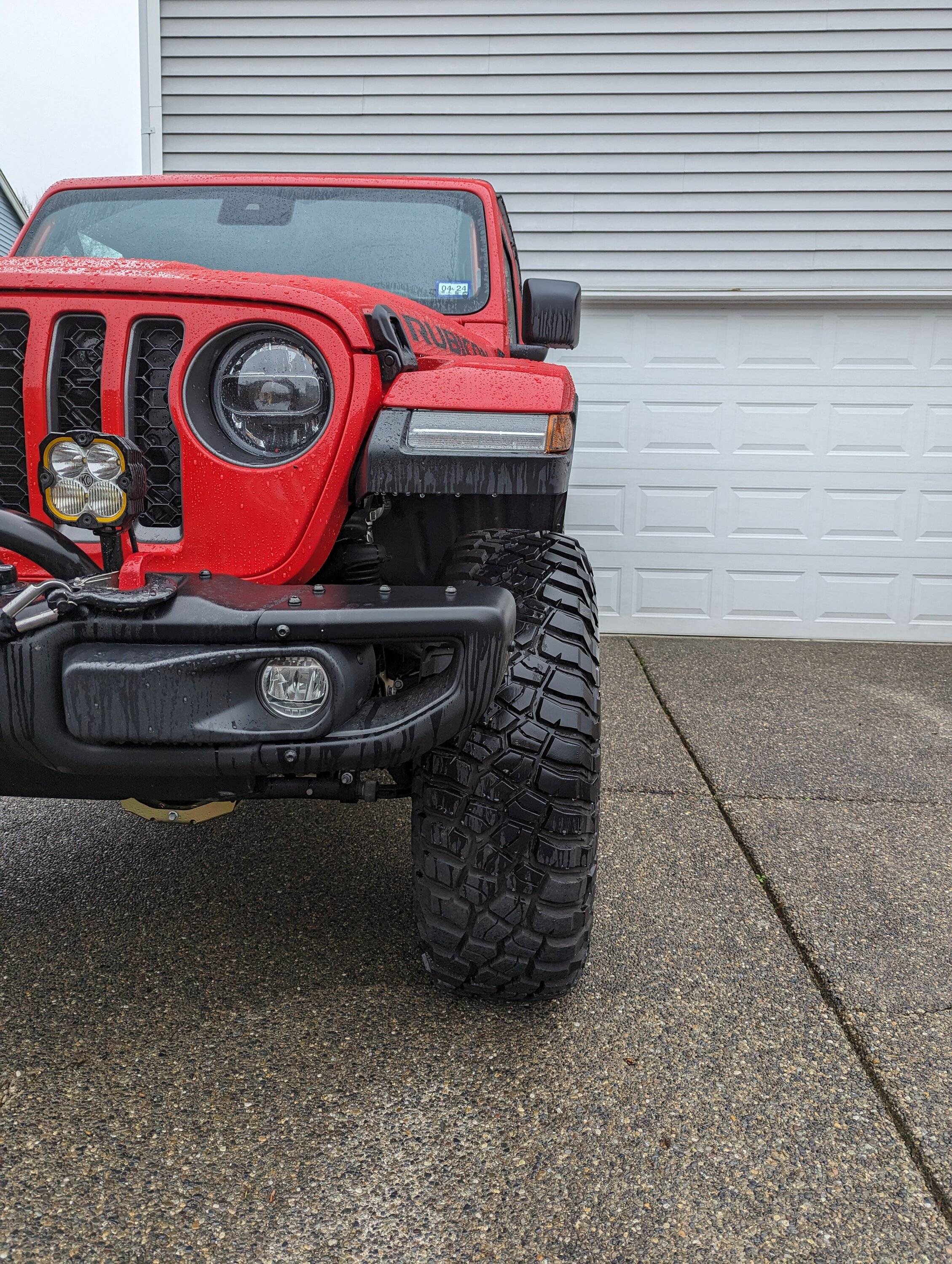

As a data point for you, I have 3.5" Metalcloak GC lift and 37s. I'm running Jeep XR wheels and I get no rubbing on street or the trail. Whatever the backspacing of those wheels, might be a good target for you. I also don't like my tires to stock way out, either.

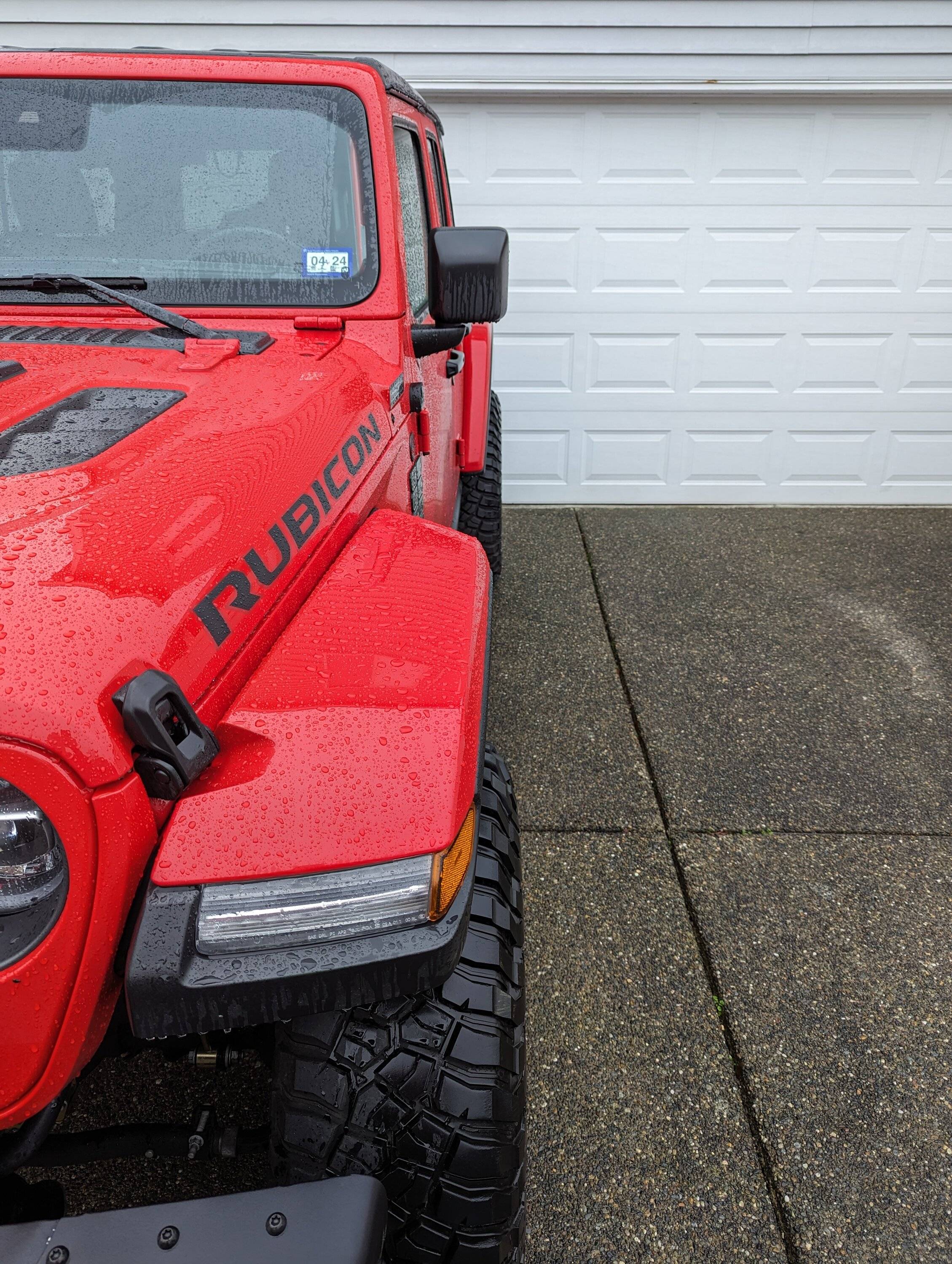

Jeep Wrangler JL Rims and offset, least amount possible 1000005271
I'll snap a photo looking down the fenders tomorrow so you can see how much tire poke I have.
Tires are BFG Mud Terrains, KM3. 37x12.5R17. I'll measure the tire height and width as it sits, tomorrow. I have played around with the tire pressure from 25 to 37 for daily driving. I've found I like the firmness and mpg of 34 psi. Lower PSI was noticably softer, but I was losing about 1 to 2 mpg with it and I notice the Jeep wanted to "pull" to the downward slope side of the road more.
Also, I don't think anyone answered it yet. Yes, you have the wider axles from the factory.

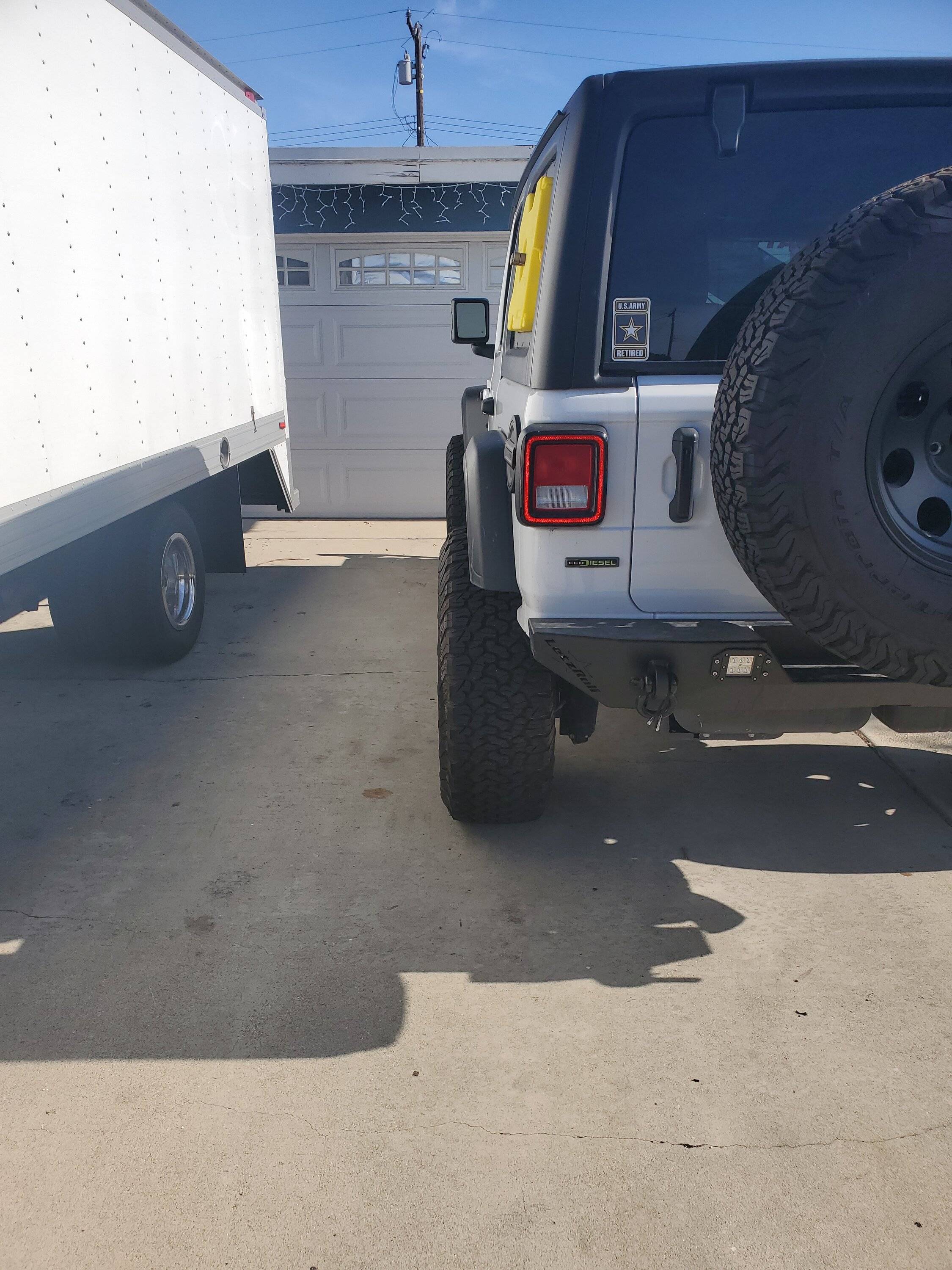

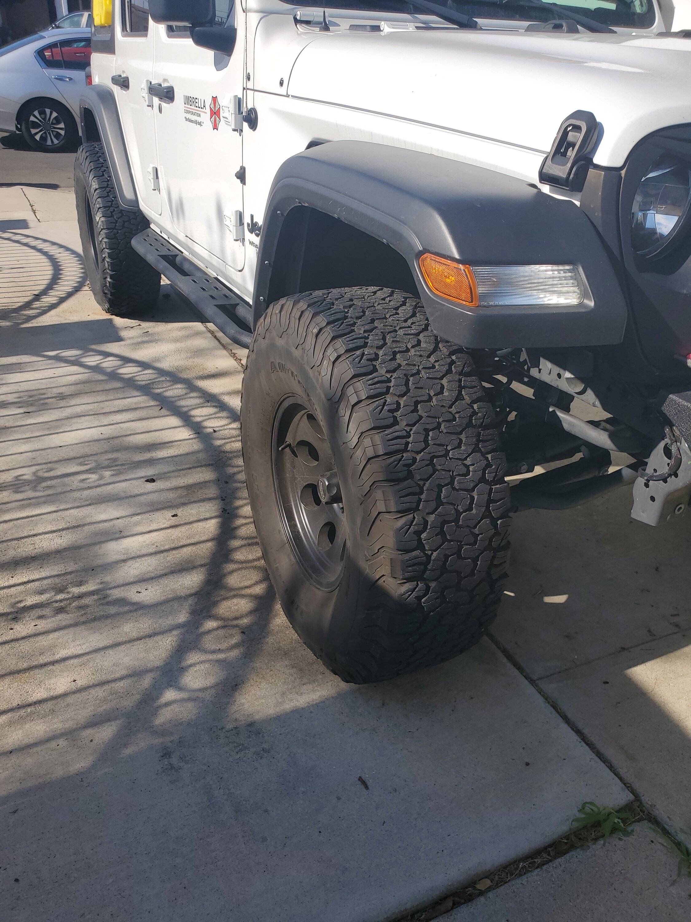

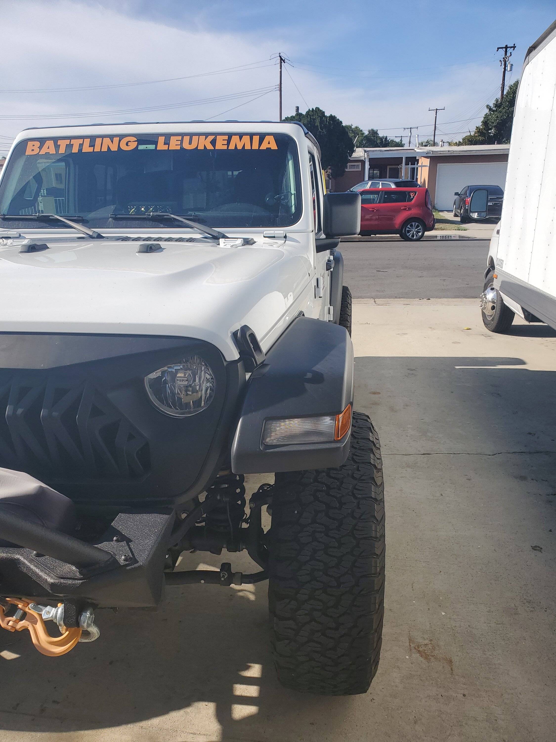

4.53 backspace -12mm offset, no rubs on 37 K02 with mopar lift
AR172 BAJAAR1727973BSATIN BLACK17X95X1274.53-12mm
Jeep Wrangler JL Rims and offset, least amount possible 20231225_114909
Jeep Wrangler JL Rims and offset, least amount possible 20231225_115214
Jeep Wrangler JL Rims and offset, least amount possible 20231225_115229
Jeep Wrangler JL Rims and offset, least amount possible 20231225_115239
On your driver's side front wheel, what's the distance from the top of the tire tread to the bottom edge of the fender?
