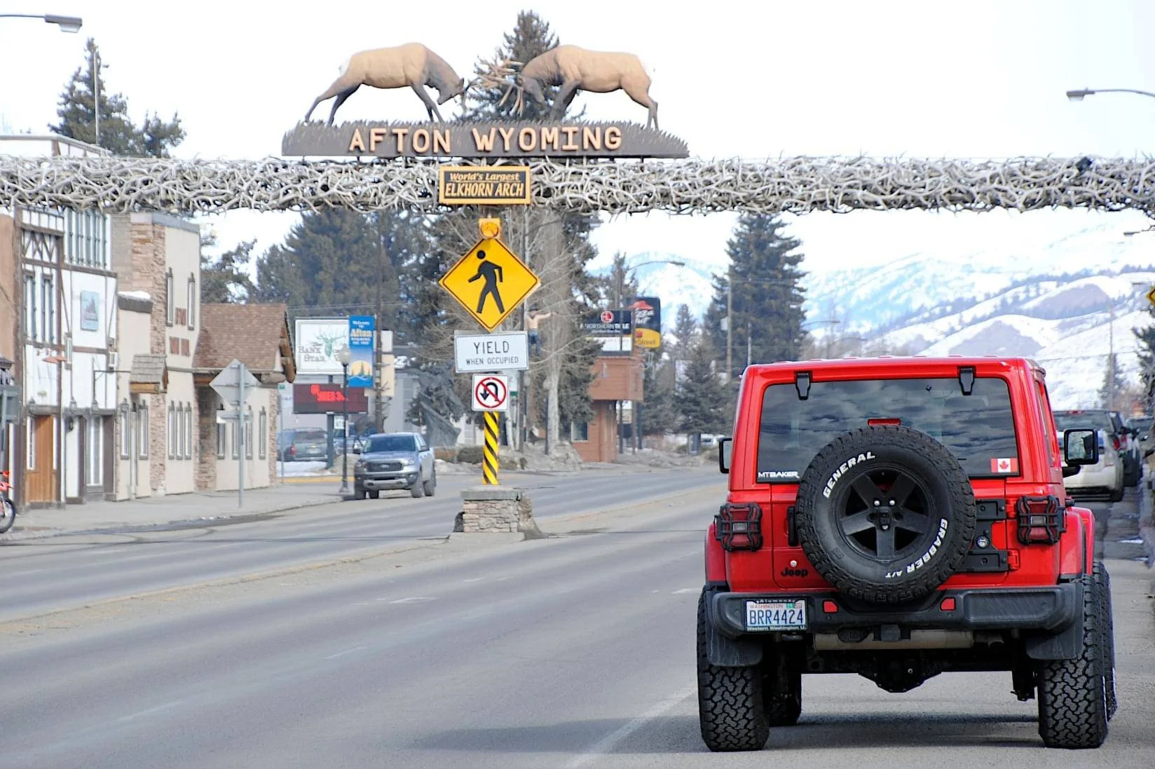

Right now I have 35s on 17x8.5 rims with 5.2 backspacing: they poke about 3/4-inch, which is quite a bit
