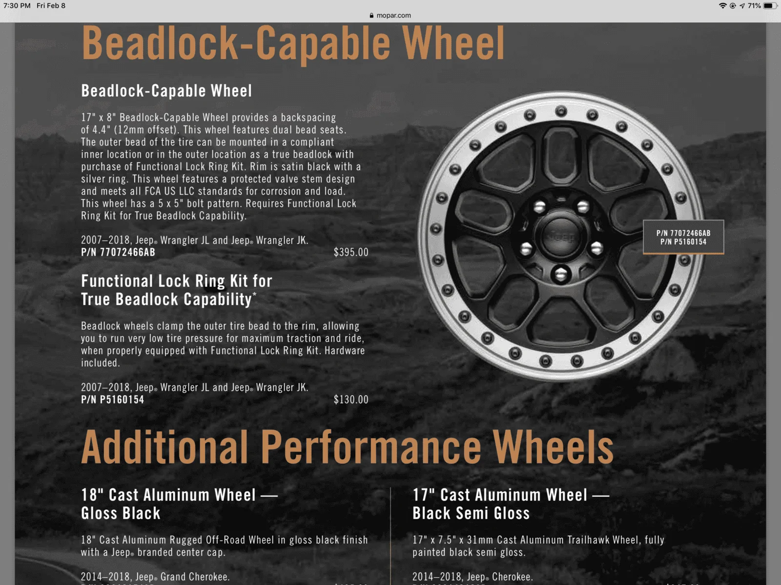

I have a 19 JL Rubicon. I want to install a 2.5” Rock Krawler lift. The lift calls for 4.5” backspacing. I am also looking at purchasing mopar 17” beadlocks with 37x12.5 r17 nitto ridge grapplers. Mopar specs show 4.4” or 12mm offset. I don’t understand wheel sizes that well. Wondering if this 4.4 backspacing will rub or will I be ok?
